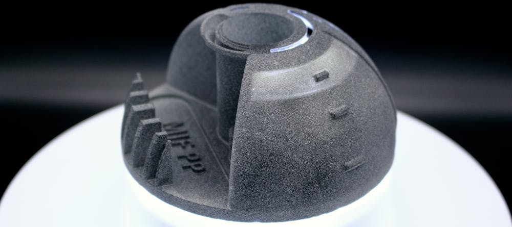

3D printing with polypropylene using MJF technology offers a few surface finishes. Parts can be vapor-smoothed to improve their aesthetics and mechanical properties. In addition to this, some basic surface finishes are listed below.
Standard: Parts are removed and de-powdered with a grit-blasting process. MJF parts have a smooth grey matte surface finish straight off the machine.
Dyed Black: A uniform matte black surface finish can be achieved by heating the part in a dye solution.
Custom: Custom surface finishes like painting, plating, and additional sanding can be requested.
