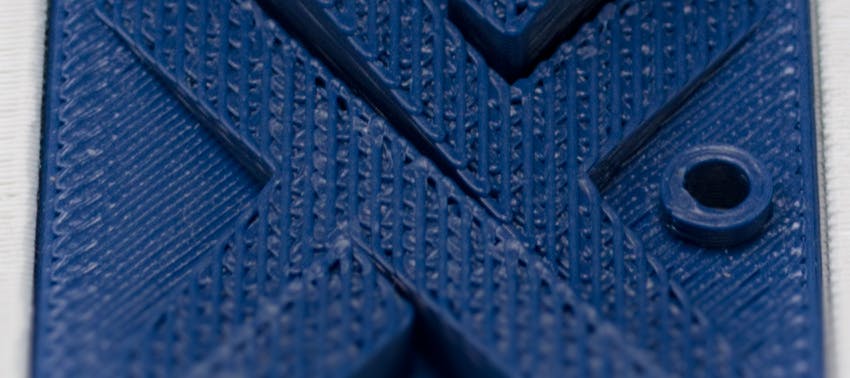

3D printing in ASA using FDM technology does not lend itself to many types of surface finishes. There are, however, up to 10 different colors of raw material available. In addition to this, some basic surface finishes are listed below.
Standard: Support structures are removed and some light sanding is performed at the support locations. In general, FDM parts typically have clear stepping, or layer lines. If a surface finish with smaller layers or no layers is required right off the machine, clients should consider other plastic 3D printing technologies like SLS, HP Multi Jet Fusion, SLA, PolyJet, and DLS.
