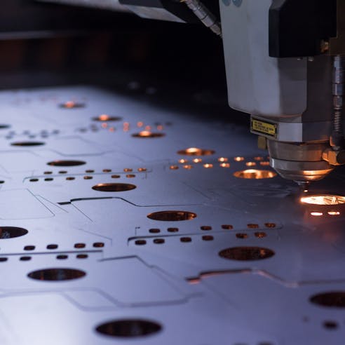

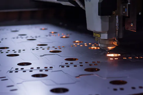

Laser cutter. Image Credit: Shutterstock.com/Denys90
Laser Cutting
Laser cutting is the process of trimming through the entire workpiece thickness to create different fiberglass shapes. Fiberglass laser cutting is possible due to the material’s ability to readily absorb the wavelengths of the electromagnetic energy produced by the laser. The CNC-controlled and focused laser beam rapidly heats the fiberglass material and vaporizes it away to produce clean-cut and precise edges.

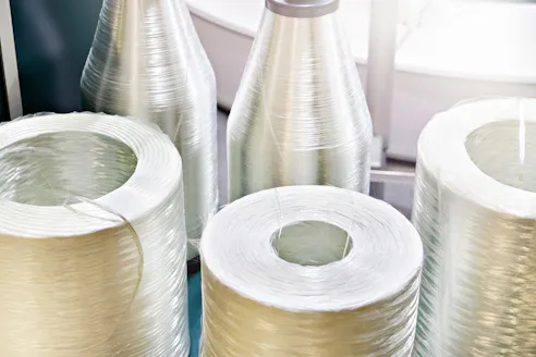

Fiberglass ropes. Image Credit: Shutterstock.com/Sergey Ryzhov
Exact Cut Edges
Workpiece edges produced by laser cutting do not require significant post-processing to obtain desired dimensions because it is a non-contact process and does not leave splinters or burrs on cut edges. This makes laser cutting a highly efficient and repeatable process that produces few defects like burned edges or cuts out of required tolerances.
High Precision
Fiberglass laser cutting results in minimal distortion. It is used to achieve highly precise dimensions with tolerances as small as +0.0004” (or 1 micron in diameter). There is no distortion in the part because laser cutting is a non-contact process. Additionally, although laser cutting is a thermal process, minimal heat is applied to the overall workpiece since electromagnetic energy is concentrated on an area with a diameter as small as 1 micron. This results in minimal thermal distortion.

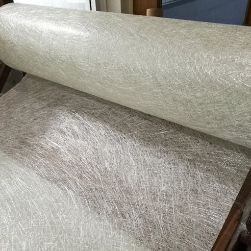

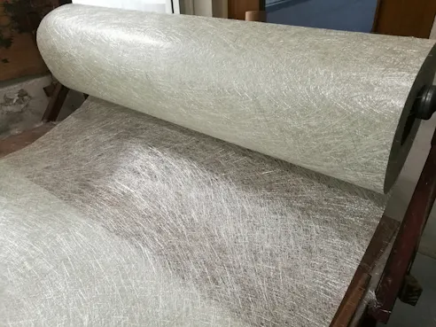

Fiberglass strand mat. Image Credit: Shutterstock.com/TASER

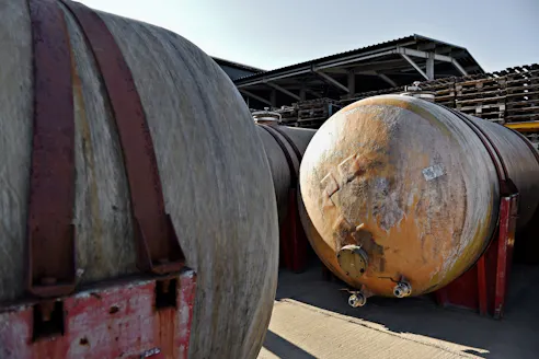

Fiberglass storage tanks. Image Credit: Shutterstock.com/roibu
Storage Tanks
Laser cutting is often used in the fabrication of fiberglass storage tanks for water and other fluids. It is used to cut a fiberglass sheet to desired dimensions before it is rolled to the desired shape of the storage tank.

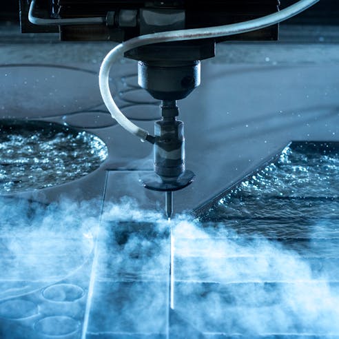

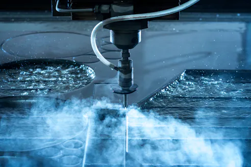

Waterjet cutting. Image Credit: Shutterstock.com/Aleksandar Malivuk
  • CNC Mechanical Cutting: Mechanical cutting using CNC-operated saws, end mills, routers, or other tools is a suitable alternative to laser cutting fiberglass. Mechanical cutting is perhaps the most used method to fabricate fiberglass parts, but non-contact cutting methods are slowly becoming more common. While mechanical cutting fiberglass is possible, blades wear out easily and must be replaced frequently due to the hard glass fibers embedded in the fiberglass material. Still, mechanical cutting is a tried-and-true method to fabricate fiberglass parts - albeit not as fast as laser cutting.
  • Waterjet Cutting: Waterjet cutting uses high-pressure water (up to 60,000 psi) to cut parts. It is a great but expensive alternative to laser cutting. Abrasives such as garnet are added to the waterjet to enhance its ability to cut materials. Waterjet cutting, like laser cutting, is a precise process. Unlike laser cutting machines, however, waterjet cutting machines cannot be used to mark parts and are only used for removing entirely through the material.
