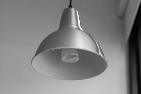

Sheet metal lighting fixture. Image Credit: Shutterstock.com/Peerawit
Electronics
Sheet metal products are common in the electronics industry. Protective housings for cell phones, computers, and other electronic devices are commonly fabricated from aluminum, stainless steel, and steel sheet metal. Additionally, sheet metal is commonly used in light fixtures, household appliances, and industrial machinery.

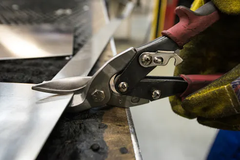

Cutting sheet metal. Image Credit: Shutterstock.com/Akimov Igor
Cost Effective
Sheet metal prototyping is a cost-effective method of producing prototypes. This is due to many reasons, including: simple and affordable tooling and machinery, reduced lead times, quick cycle times, and optimized material usage.
Fast Turnaround
Another key advantage of sheet metal prototyping is the fast turnaround for complete parts. Sheet metal fabrication methods like laser cutting, waterjet cutting, plasma cutting, bending, forming, and welding can all be automated and CNC-controlled. The high degree of automation reduces the need for human intervention and ensures that parts are made in a fast and repeatable manner.

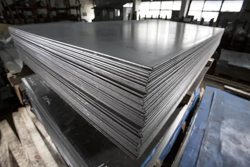

Sheet metal stack. Image Credit: Shutterstock.com/Alexandru Rosu
Tooling Costs
Tooling costs for sheet metal prototyping are wide-ranging but can be expensive when it comes to laser cutting, waterjet cutting, and plasma cutting machines. Fiber laser or CO2 laser cutting machines capable of cutting sheet metal can easily cost anywhere between $30,000–$1,000,000. The high upfront costs for these machines are precisely why many companies opt to use Xometry for their sheet metal prototyping needs.

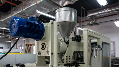

Plastic injection molding machine. Image Credit: Shutterstock.com/mofaez
  • CNC Machining: CNC machining is a reliable rapid prototyping method for fabricating with sheet metal. While CNC machining can be used to cut features into thin sheet metal workpieces, the process can also be used to create 3D parts thicker than the thickest sheet metal gauge (around 0.18" depending on the type of material). Like sheet metal fabrication methods, CNC machining is largely automated and requires little human intervention.
  • 3D Printing: 3D printing is another great alternative for producing prototype parts. 3D printing is capable of creating the same thin, flat parts commonly fabricated from sheet metal, but is also capable of producing intricate and complex 3D parts. While 3D printing is a slow process compared to sheet metal fabrication techniques, the potential features that can be created with 3D printing are unmatched.
  • Injection Molding: Injection molding is a manufacturing method used to create 3D parts out of thermoplastics and thermosets. Compared to sheet metal prototyping, injection molding prototyping is more expensive due to the costs associated with producing molds and die sets. Because parts are largely complete after injection require little post-processing and cycle times are short, injection molding is great for producing large volumes of parts.
