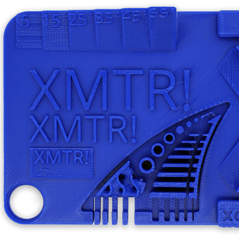

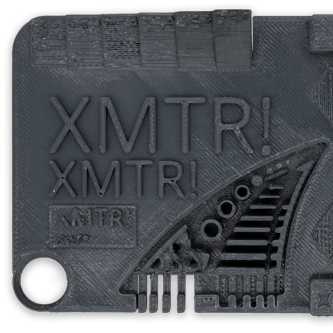

    FDM Feature Detail Examples
    Stratasys FDM - .010" Layers
    Desktop FFF - .007" Layers
    Layer Uniformity - Carbon-fiber-filled
    Layer Uniformity - High-Temperature Materials
