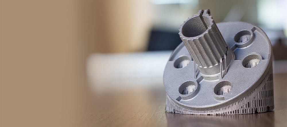

A metal 3D printed aluminum part with its support structures

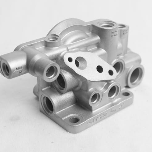

    DMLS aluminum sample part
