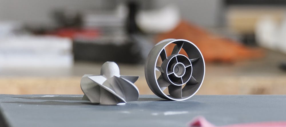

Maraging Steel - MS1
MS1 maraging steel is also referred to as grade 300 maraging steel. This specific alloy has the second-highest strength and hardness values out of the four common maraging steel alloys. Typical applications can include tooling, rocket motor cases, and gears.

Maraging steel 3D printing results in parts with 100% relative density and can be readily polished and machined.
Standard: The standard finish refers to the removal of any support structures. The surface of the part is also medium blasted to create a uniform appearance.
CNC Machining or Polishing: In some cases, CNC machining or polishing can be specified for specific features on the component. For example, maraging steel can be polished up to 0.5 μm. However, these additional processes are evaluated on a case-to-case basis.
