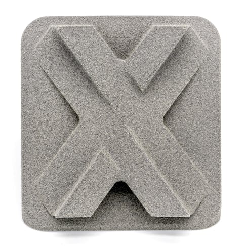

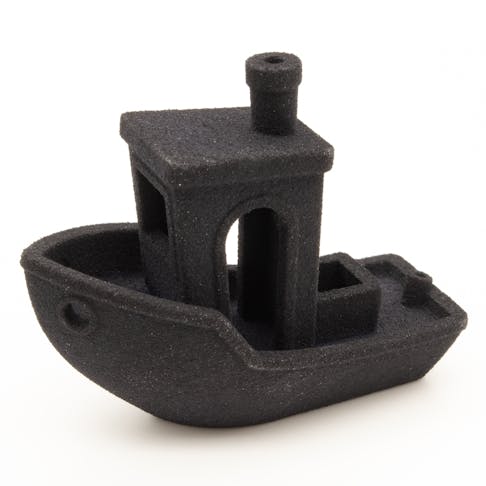

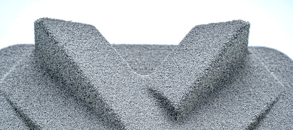

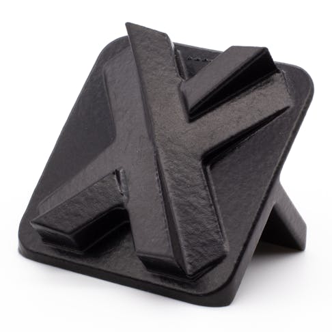

TPU 88A Finishing Options
Parts are removed and de-powdered with a grit-blasting process. MJF parts have a smooth matte surface finish straight off the machine.
Parts are submerged in a heated dye solution to produce a uniform matte black surface finish.
An automated post-processing technology (AMT PostPro3D) is used to achieve a high-quality surface finish. Vapor smoothing brings most surfaces from matte to semi-gloss. Vapor smoothing also seals the surface, enhances mechanical properties, and provides a consistent cosmetic finish for production. Vapor-smoothing can also be performed on non-dyed parts. Click here to learn more about vapor smoothing.
