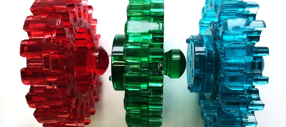

Rigid Clear Polyurethane (Colorless)
  • Rigid Clear: A versatile, Shore D 80, clear polyurethane. A matte finish will give a frosted appearance, and a higher gloss will increase its transparency. (View spec sheet)
