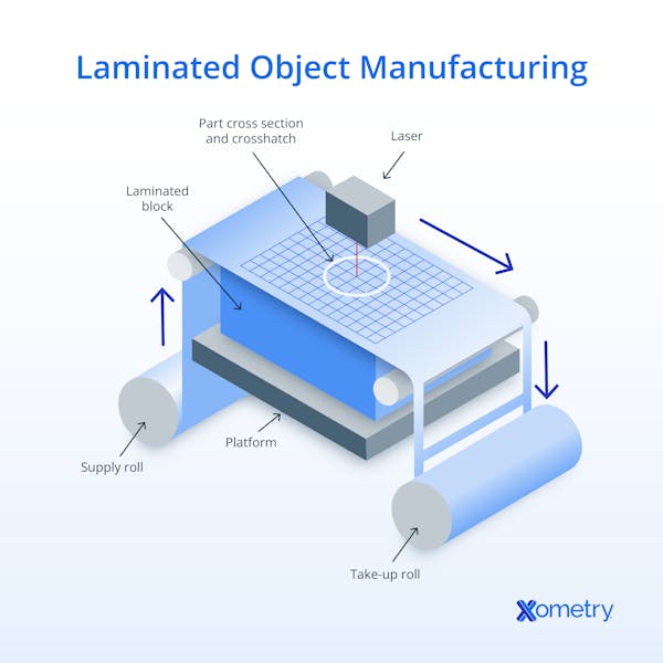

Laminated object manufacturing works by layering sheet materials, which are cut in place by either a laser or a traveling knife. The 2D outline is then extracted as an outline of a slice before another layer is added. Sheets of materials are rolled out on a build platform and are coated with adhesive. The adhesive-bearing sheet is placed onto the build table, atop the laminate pile. Accurate positioning using relatively simple inkjet/photocopier paper-handling methods produces a rectilinear stack. The new laminate layer is then pressed into place with a hot roller to ensure good bonding and curing. Once the layer is cured, a scanning laser or traveling tungsten knife cuts the slice outline, leaving the waste material in place as support for the next laminate. Once all layers are applied and cut, the model is “extracted” from the waste manually, revealing a finished prototype.
A diagram showing how laminated object manufacturing works.
