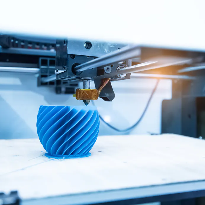

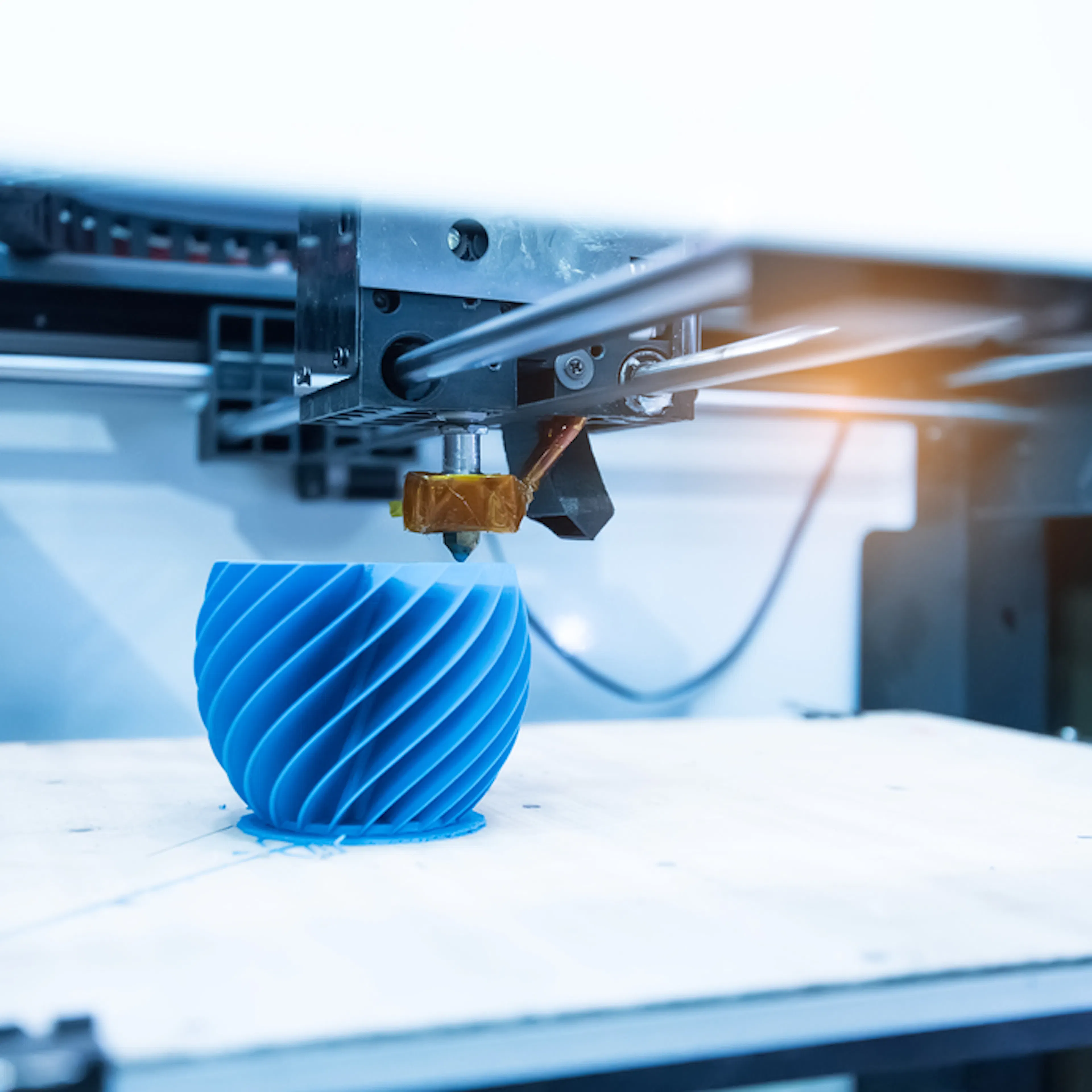

FFF 3D printer. Image Credit: Shutterstock.com/asharkyu
