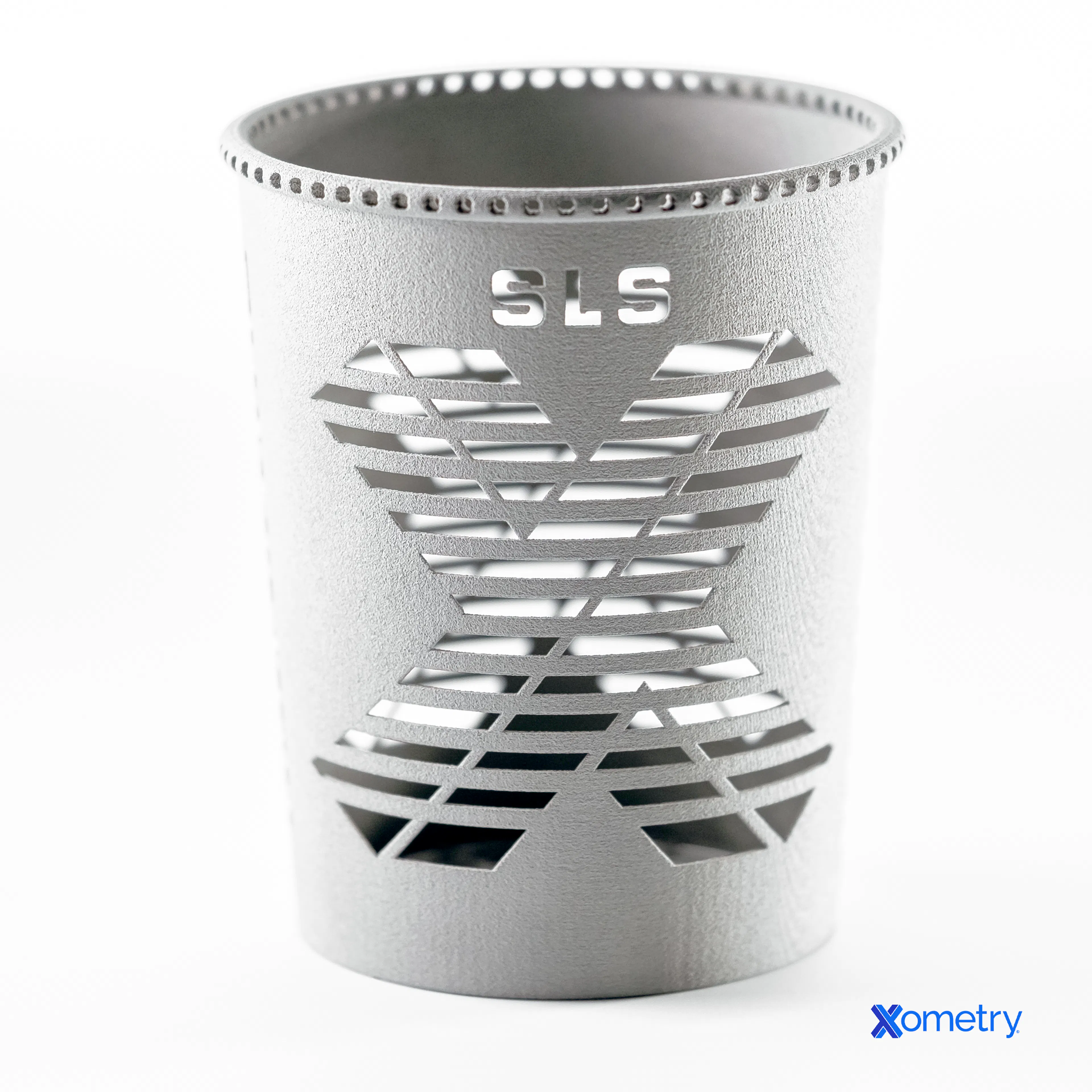

Pen holder made with SLS printing

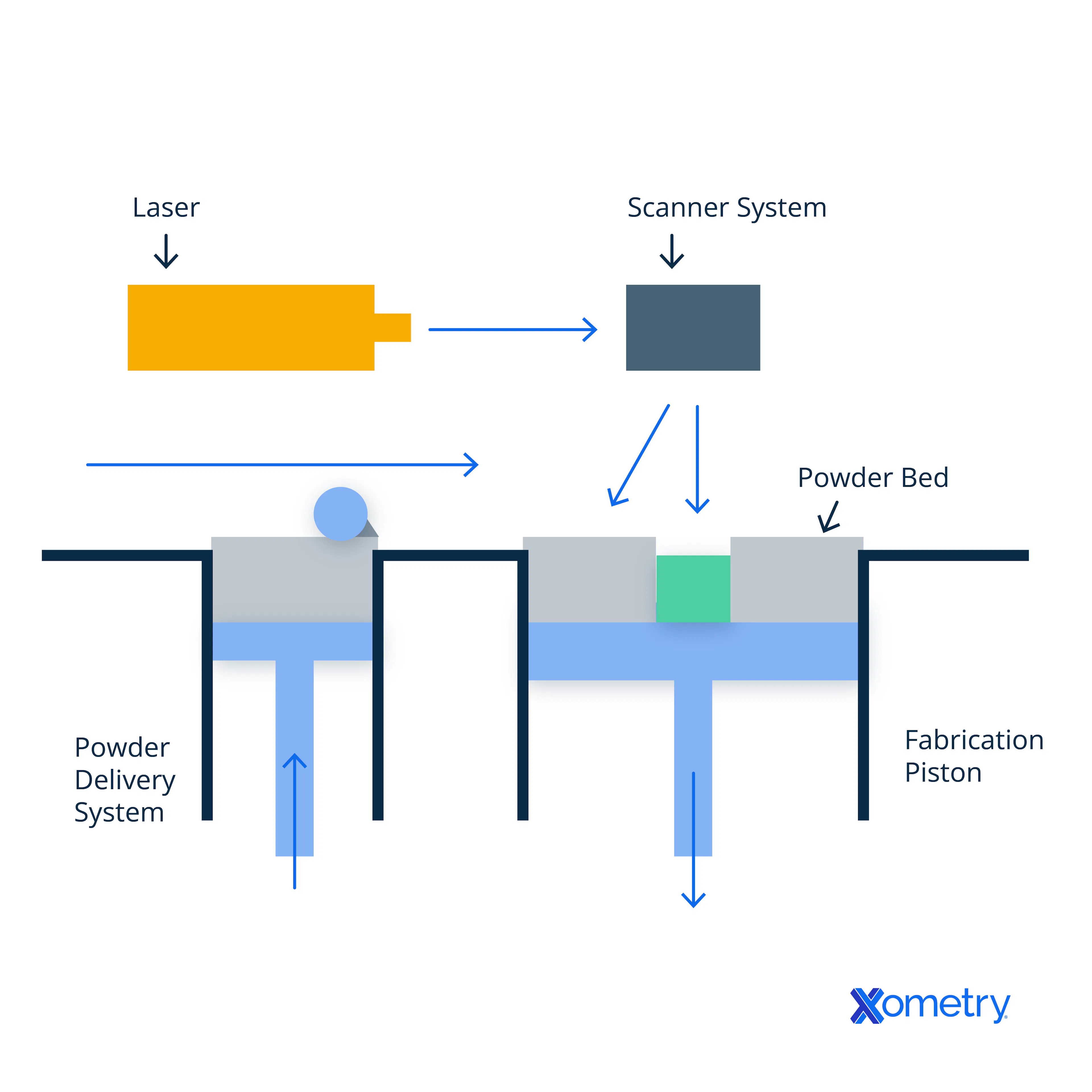

  1. Laser: The laser (typically a CO2 laser) is used to sinter the plastic particles into each other. The laser is directed using a scanning mirror which directs the laser to trace out the layer cross-section.
  2. Material Delivery System: The material delivery system stores all the powder. As the part is built, this mechanism supplies material to the recoater.
  3. Recoater: The recoater drags material from the powder delivery system and lays it out onto the print bed/preceding layers.
  4. Print Bed: The print bed moves down as the part is printed, typically between 50 and 200 microns per layer depending on the required resolution. A thin layer of plastic is placed on the print bed for each new part layer by the recoater.
  5. Heaters: Heaters keep the build volume at an elevated temperature to assist with the sintering process by reducing the energy required by the laser to sinter the powder.
