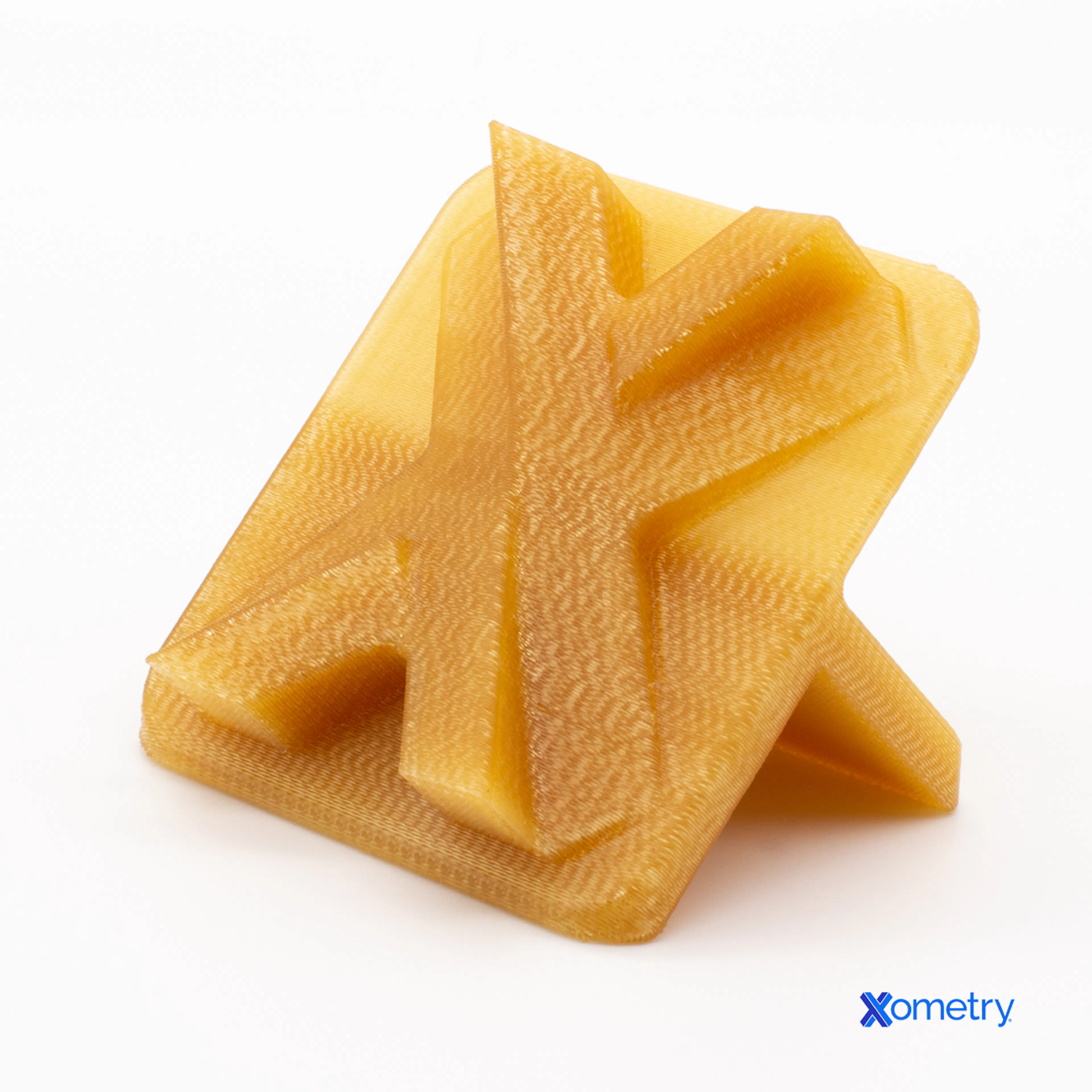

Xometry logo made with ULTEM, a heat resistant plastic

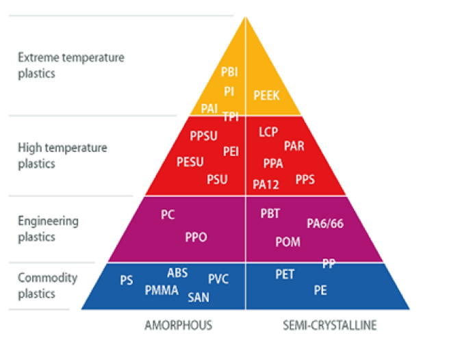

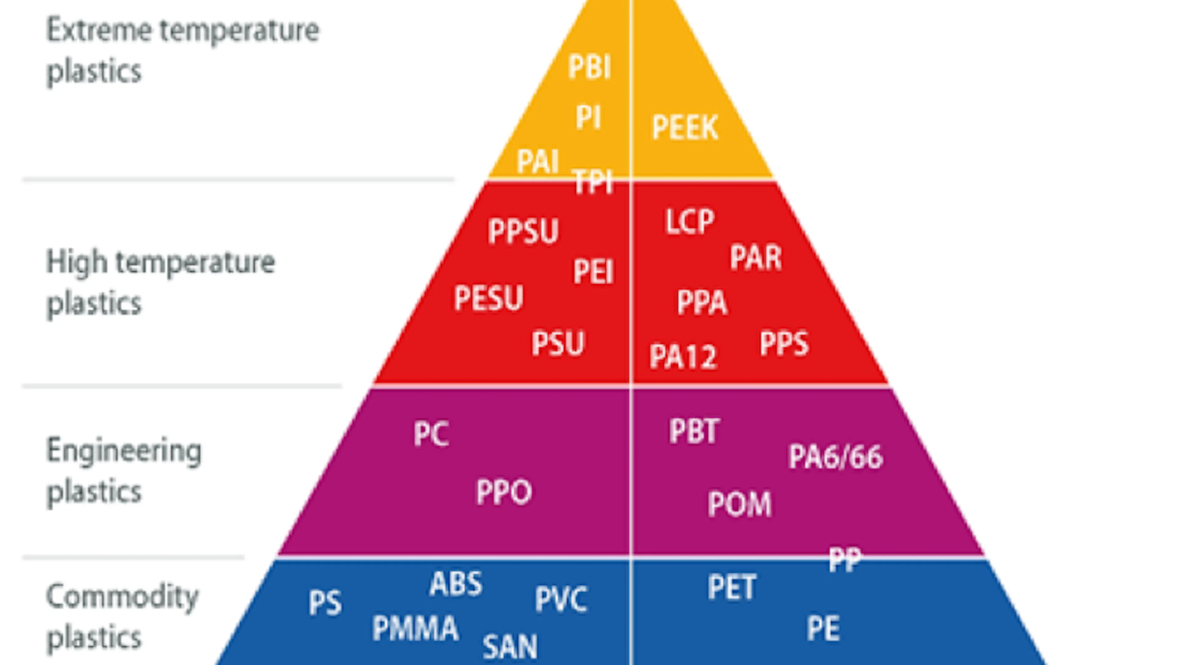

There are two main groups of thermoplastics — namely amorphous and semicrystalline plastics. Heat-resistant plastics can be found in each of these categories as indicated in Figure 1 below. The main difference between these two is their melting behavior. An amorphous material does not have an exact melting point but rather slowly softens as the temperature increases. A semi-crystalline material, by contrast, has a very sharp melting point.
