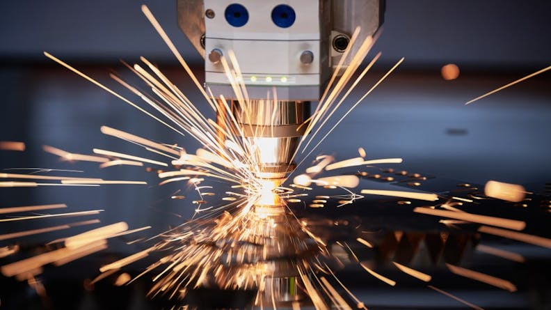

Laser engraving on a metal surface. Image Credit: Evgeny Haritonov/Shutterstock.com

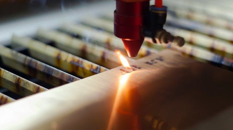

A laser engraving machine used to engrave details into wood.
