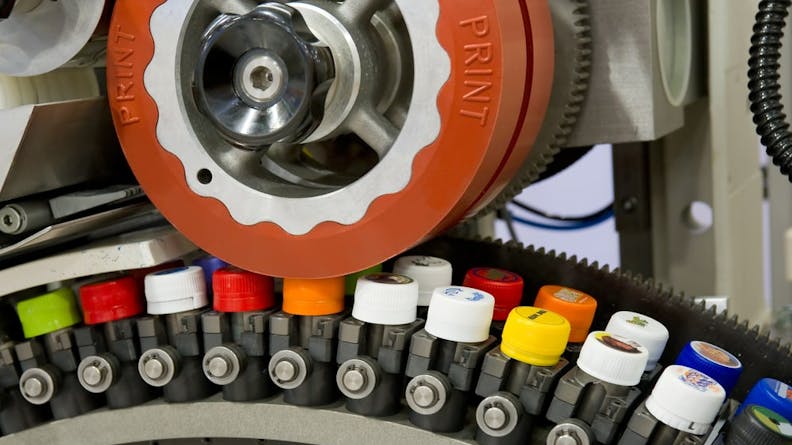

What is Pad Printing?
Pad printing transfers a 2-D image onto a 3-D object using an indirect offset, gravure, printing process using an image transmitted from the cliché via a silicone pad onto a substrate. It is used to print on otherwise difficult to print on products in many industries, including medical, automotive, promotional, apparel, electronic objects, sports equipment, appliances, and toys. It can also deposit functional substances such as conductive inks, lubricants, and adhesives.
Physical changes within the ink film both on the cliché and on the pad let it leave the etched image area and adhere to the pad, then release and adhere to the substrate. The distinctive properties of the silicone pad allow it to pick images up from a flat plane and transfer them to a variety of surfaces, such as textured, concave, or convex surfaces.
The pad printing process has developed quickly in the past 40 years and is now one of the most essential printing processes. The use of silicone rubber was crucial to its success as a print medium because it allows easy deforming, is ink repellent, and ensures an excellent ink transfer.
Pad printing begins with the artwork for design being etched onto a base plate. Then, the etched area of the base plate or cliché is filled with ink. A closed ink cup removes any residue/excess ink on the surface.
Next, a flexible silicone pad is pressed onto the base plate, and the inked artwork transfers onto the pad. Finally, the pad is pressed onto the material being printed.
The silicone printing pad works as a transfer vehicle, picking up ink from the ink plate and transferring it to the part. Pads vary in shape and diameter depending on their application.
There are two main shapes for pad printing pads. There are round pads, and long narrow pads called bar pads. There are three size categories within both the pad groups: small, medium, and large pads. Custom-shaped pads can also be created to meet particular application requirements.

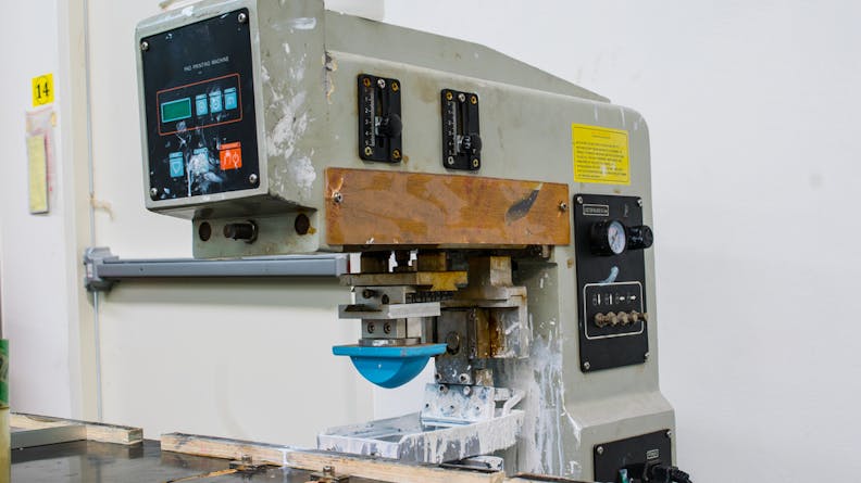

Open Inkwell System
Open ink well systems, the older pad printing method, uses an ink-trough for the ink supply that is located behind the printing plate. A flood bar presses a pool of printing ink over the plate, and a doctor-blade removes the ink from the plate surface and leaves ink on the etched artwork area ready for the pad to pick up.
Sealed Ink Cup System
Sealed ink cup systems use a sealed container for the ink supply, flood bar, and doctor blade all at the same time. A ceramic ring with a highly polished working edge creates the seal against the printing plate. The ink lying on the plate is drawn back into the ink reservoir by a blade. In a sealed ink cup system, the ink cup glides from its position over the printing image. The ring blade takes off the excess ink in the process. As a result, the printing ink only remains in the depressions of the plate.

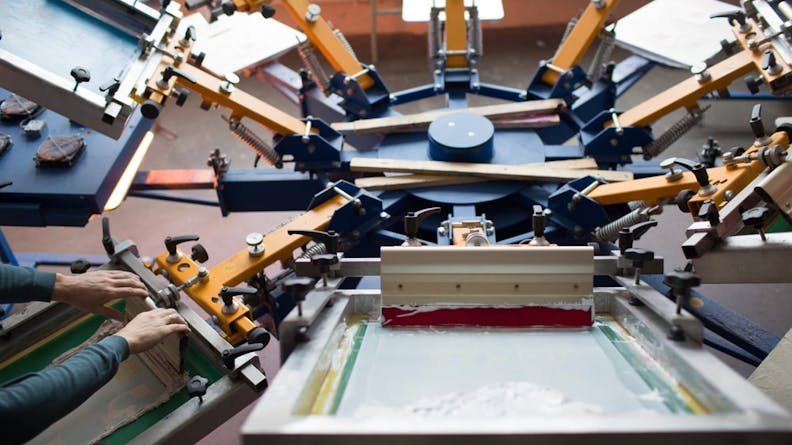

What is Screen Printing?
Screen printing involves creating an image by pressing ink through a stenciled mesh screen to create a printed design. It's a widespread technique used in a wide range of different industries. The process is sometimes called serigraphy, silk screening, or silk screen printing, but these names refer to essentially the same method. Screen printing can be used with nearly any material, even with substrates that have uneven or round surfaces.
The screen utilized in screen printing is made of a piece of mesh stretched over a frame. Traditionally, silk was used in the process. In modern times, synthetic threads such as nylon or polyester are usually employed in the screen printing process. A finer and smaller aperture for the mesh is used for a design that needs a higher and more delicate degree of detail.
Different types of mesh size determine the outcome and look of the finished design on the material. For the mesh to be effective, it is mounted on a frame and is placed under tension. The mesh frame can be made of different materials, such as wood or aluminum. The tension of the mesh is checked using a tensiometer.
Screen printing stencils are created by blocking off parts of the woven mesh screen in the negative image of the design to be printed, so the open spaces are where the ink will appear on the substrate.
Before printing, the frame and screen must go through a pre-press process. An emulsion is 'scooped' across the mesh. Once it dries, it is selectively exposed to ultra-violet light through a film printed with the required design, hardening the emulsion in the exposed areas but leaving the unexposed parts soft. A water spray washes them away, leaving a clean space in the mesh with the same shape as the desired image, allowing the passage of ink.
The screen printing process is relatively simple and involves a blade or squeegee moving across the screen and filling the open mesh apertures with ink. A reverse stroke then forces the screen to touch the substrate briefly along a contact line. The ink wets the substrate and pulls out of the mesh apertures as the screen springs back after the blade passes. One color is printed at a time, meaning several screens are needed to create a multicolored image or design.
