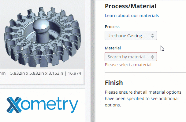

You can get instant online pricing on all Xometry materials. These can be further customized by adding finishes, tolerances, certifications, and inspection requirements. Simply upload your 3D model to the Xometry Instant Quoting Engine℠, click “Modify Part” and under the process drop-down menu, choose “Urethane Casting.” Then, select your material, add features and any notes, and head to checkout.
