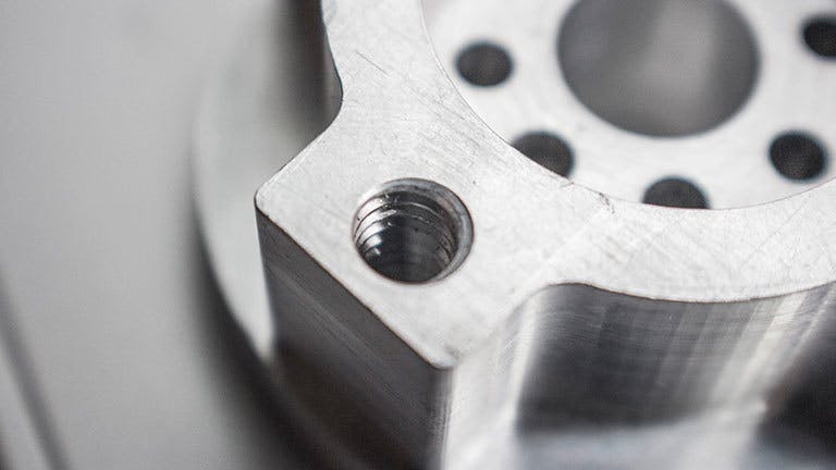

Machined metal parts scale to production through CNC services. Image Credit: FreePik.com/shyachlo
