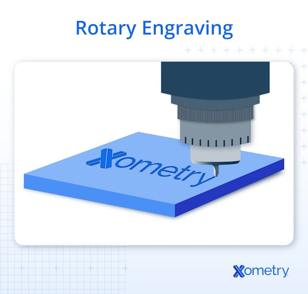

Rotary engraving is the engraving method of rotating a cutting tool in a motorized spindle that moves through a substrate to create a groove at a specific depth and in the same geometry and width as the cutter tip. It is often used on flexible plastic stock to make name badges, key tags, architectural signage, and awards. It can also be used with brass, acrylic, and aluminum when deep cuts are required.
Rotary engraving can be performed using the least expensive pantographs to the most complex computerized engraving and routing systems. However, the principles are the same with each rotary engraving machine. In manual engraving, the worker lowers the cutter into the material's surface. Then, the worker “traces” the copy type or letter master and reproduces the image on the substrate. In computerized engraving, the z-axis is controlled mechanically by the systems stepper motors and the x and y-axis to form the characters.

An illustration showing how rotary engraving works.
