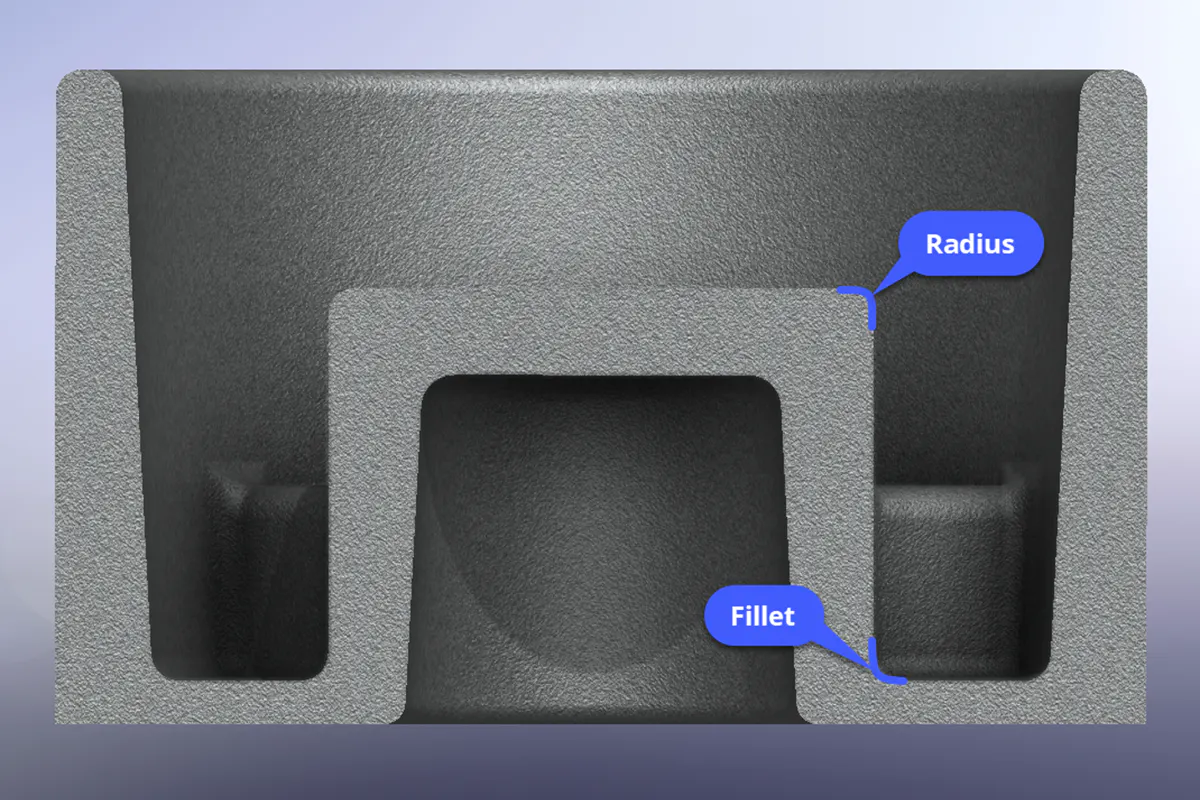

Fillets and Radii
Implementing both fillets and radii in your design can be beneficial in several ways. Firstly, they help the metal evenly flow through all areas of the part and reduce concentrated areas of heat around corners and transitions. These are also important features to prevent cold shuts, caused when the metal begins solidifying before it has completely filled the mold cavity. Components that cool evenly lessen the stress on the tooling, thus increasing its lifetime and reducing maintenance. Fillets can also reduce stress concentrations, especially where intersecting features would otherwise create sharp corners. Here are some further guidelines when it comes to adding fillets and radii:
  • Add fillets or radii to sharp edges and corners.
  • The deeper the corner or pocket, the larger the fillet should be.
  • Fillets create smooth transitions between features that promote metal flow and structural integrity. Radii should be generous on intersecting features.
  • Constant-radius fillets help maintain edge continuity and smoothness of the part.
  • Draft angles are required when the fillet is perpendicular to the parting line. The draft of the intersecting surface will determine the amount of draft needed.

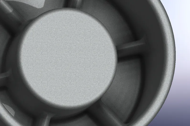

Ribs and Coring
Ribs are structural features that provide several benefits in die cast parts. Their primary purpose is to provide additional rigidity and strength, especially to areas with thin walls. Ribs also assist the molten metal flow, allowing it to reach and fill connected areas more quickly.
Adding corings, such as the space between ribs or walls, helps reduce material as a metal-saver and provides better cast parts. The purpose of coring is to displace the casting alloy, reducing material usage and resulting in a lighter-weight part. With the proper use of ribs and coring, you can avoid areas of concentrated heat caused by excessive material buildup while also reducing the weight of the part and maintaining its strength. When incorporating ribs and cored features into your design, it’s essential to keep the following in mind:
  • Designers should add ribs onto thin-walled sections.
  • Design for an odd number of ribs to better distribute internal stresses and avoid forming thick intersections.
  • Add fillets to ribs and edges of metal savers to reduce sharp corners and assist with metal flow.
  • Avoid having too many ribs too close together, as this can affect the effectiveness of metal savers.
  • Include generous draft on the sides of metal saver pockets to assist with mold release and prevent tool wear.

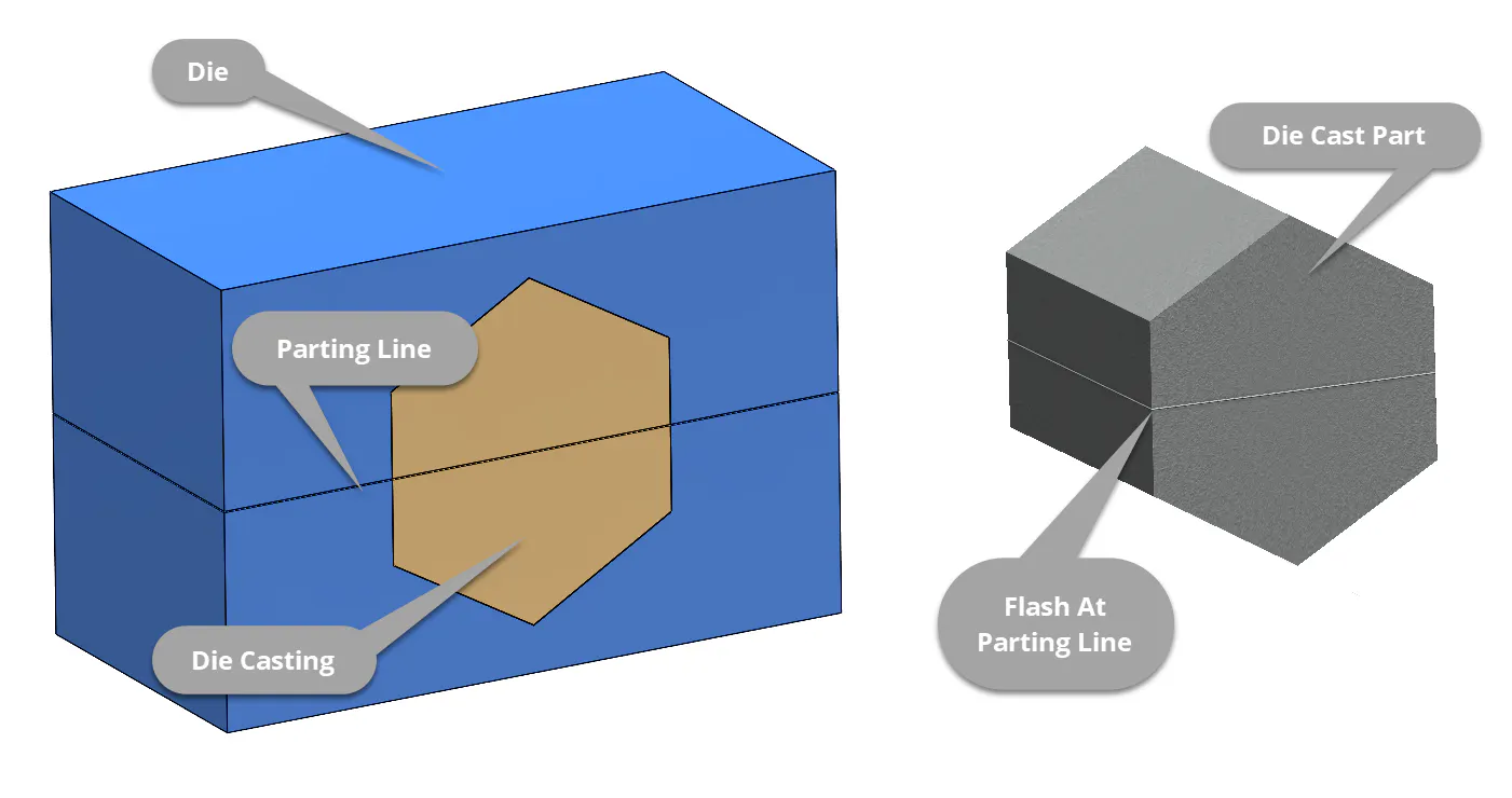

Parting Lines
Parting lines are where the die halves meet and interface with each other. When designing your parts, the parting line locations are one of the first aspects to consider. Parting lines can be straight or broken depending on the geometry and die components required to create them. When it comes to the parting line locations, here are the key aspects to consider:
  • Parts with straight parting lines will usually be less expensive than one that requires broken parting lines since less complex tooling is needed.
  • Quality along parting lines is more difficult to control; therefore, you should avoid having it cross critical or tight tolerance features.
  • Parting lines often exhibit flash, a thin web or fin of material that occurs due to the clearances needed for die operation. Flash is removed during trimming, and it should be easily accessible.
