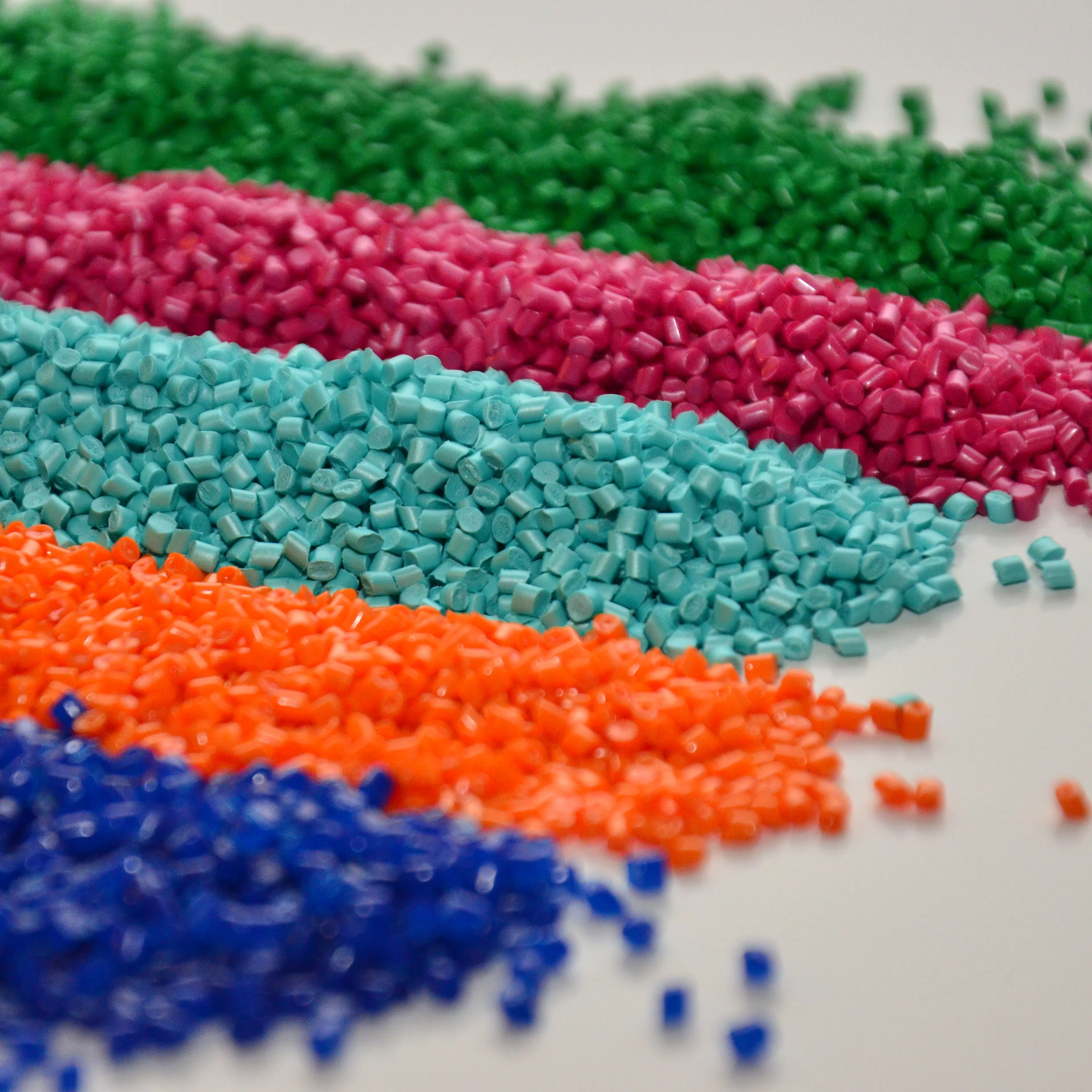

Polypropylene. Image Credit: AdobeStock/Emilia
