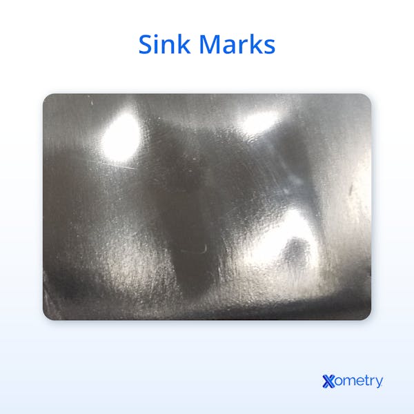

7. Sink Marks
Sink marks are small depressions or craters that appear on the thicker parts of a part's otherwise flat surface. They commonly occur when the interior of a molded component shrinks, which causes the material to pull from the outside inward.
The main reason for these defects is insufficient cooling time or the cooling mechanism for the plastic to properly cool and cure while in the mold. Inadequate mold cavity pressure or a high temperature at the gate can also cause sink marks. As mentioned, these mostly appear on thicker parts, since thicker areas of the injection molded part take longer to cool than thin ones.
Several different steps may be taken to prevent sink marks from appearing. First of all, the cooling time should be increased to reduce shrinkage. Next, the thickness of the thickest wall parts should be reduced, thus providing shorter cooling times. To allow for more sufficient cooling and curing, mold temperatures should be reduced, holding pressure increased, and holding duration extended.
A photograph showing an example of sink marks

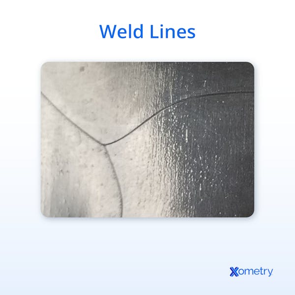

8. Weld Lines
Weld lines, also called knit lines, are a defect that occurs with molded parts caused by two different flows of plastic resin that do not adequately join together or weld together correctly during injection molding. When the resin is injected into a mold, there are areas where the resin needs to flow around an obstruction in the mold that is intended to form a feature of the finished part. Ideally, the resin flow will split into two flow fronts to pass around the obstruction and then recombine into a single flow front. When this fails to happen correctly, a weld line defect occurs.
There are several possible causes that need to be investigated to troubleshoot weld lines in injection molding. These potential causes include:
  • Inadequate injection pressure impeding resin flow
  • Lower process temperature causing premature solidification of plastic in some areas of the mold
  • Slow resin flow through the mold resulting in non-uniform cooling
  • Resin impurities that result in flow speed variations within the mold
  • Excessive material is injected into the mold, causing a slowdown in flow speed
  • Mold design issues such as improperly placed gates or inadequate wall thickness
Corrective measures to consider include increasing injection pressure, adding hot runners to the mold, mold redesign to adjust the number of gates and their location, or changing the type of resin being used to create improved resin flow within the mold.
A photograph showing an example of weld lines

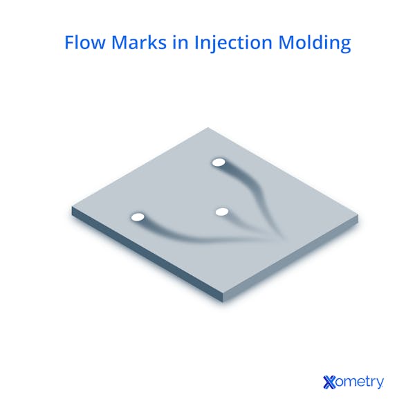

10. Flow Lines
Flow lines are stains, patterns, or lines that appear on thinner areas of the molded component, frequently of a slightly different color than the surrounding area. They can also appear on a product's surface as ring-shaped bands near the mold's entry points. Even though flow markings usually don't affect the component's integrity, they are undesirable for products that must be appealing to the eye.
One of the leading causes of flow lines is the variations in the material's cooling rate as it flows in different directions within the mold. Another reason is wall thickness – if there is no uniform thickness of the walls, the material cools and solidifies at different speeds. Moreover, a slow injection speed or low-pressure molding can also cause unwanted flow lines.
One solution is to make sure that the material fills the mold before cooling. This can be done by increasing the pressure, speed, and material temperature to the recommended optimal level. In addition, manufacturers will round corners and points where the wall thickness varies to avoid abrupt changes in direction and flow rate. To prevent the material from cooling too quickly, mold gates (the openings through which the polymer solution is fed into the final item) can be relocated farther from the mold coolant (used to regulate and reduce the temperature in the mold).
To learn more, see our full guide on Flow Marks in Injection Molding.
Example of a flow mark
An illustration of an injection molding flow mark.
