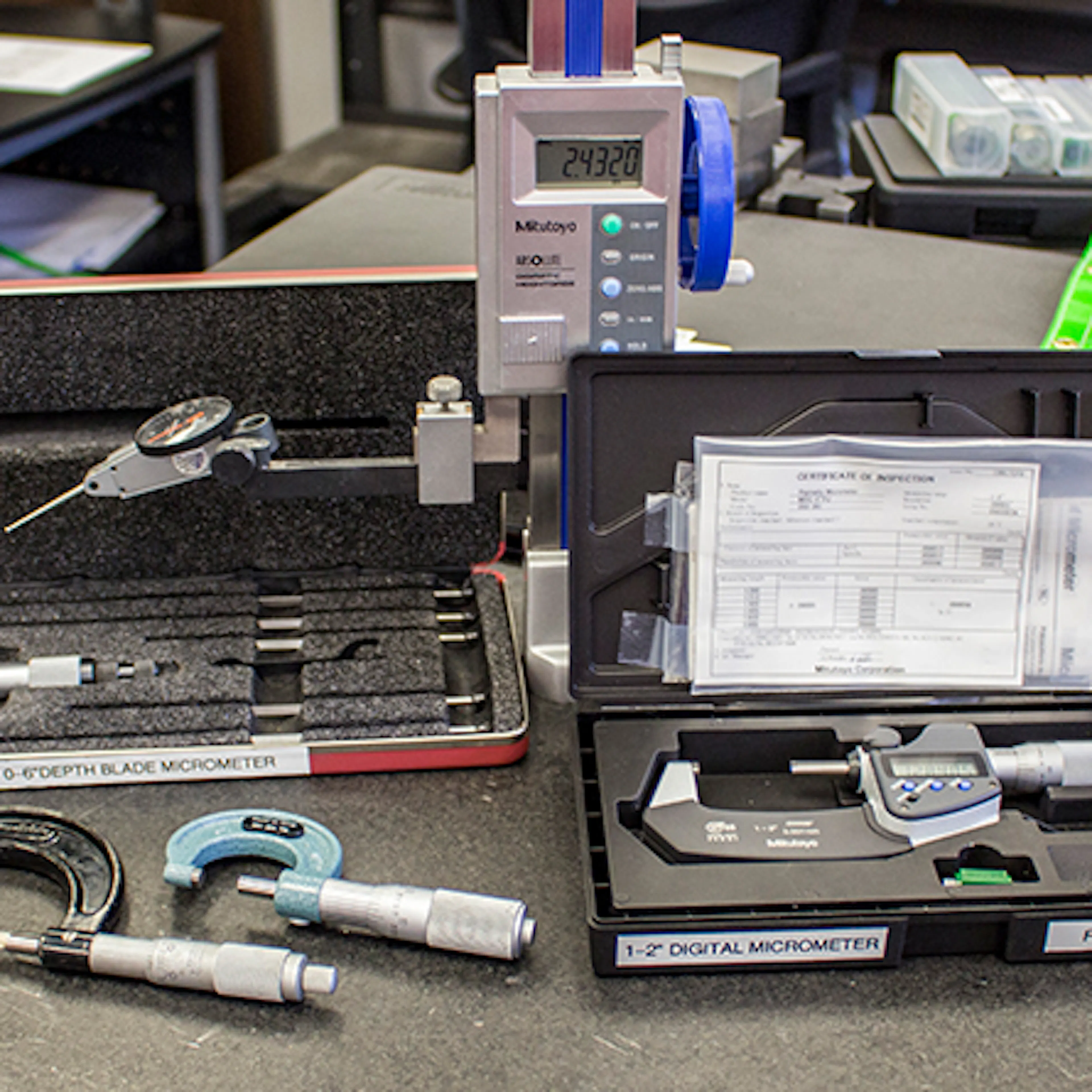

There is no defined set of rules to determine whether a tool should be calibrated in-house or by a 3rd-party laboratory. Factors like the complexity of the tool, the in-house availability of calibration equipment, and the availability of skilled staff should be considered.
In-house Calibration
Transfer standards are used for the in-house calibration of tools. It can be a reference thermometer for ovens; gauge blocks for dimensional calibrations of tools such as calipers, rulers, and tapes; etc. The transfer standards are calibrated by a 3rd-party laboratory.
If in-house calibration is performed, a clearly defined procedure that details the calibration process must be available for each tool. These procedures should be regularly audited as part of quality management audits.
3rd-Party Laboratories
3rd-party laboratories used for tool calibration must be ISO/IEC 17025 certified. These laboratories issue calibration certificates for tools that are compliant with the relevant calibration standard(s).
