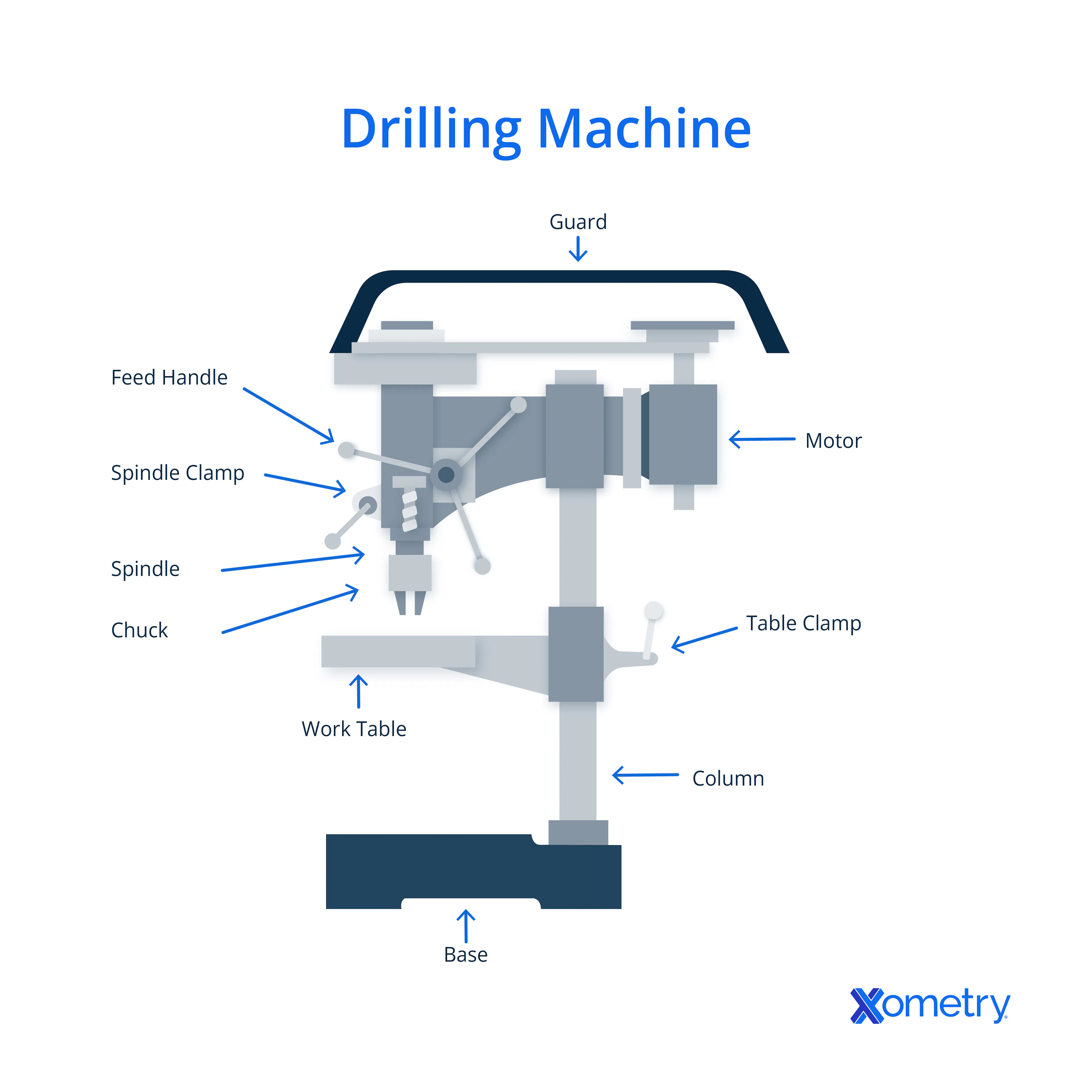

What Are the Parts of a Drilling Machine?
The parts of a drilling machine are listed below.
  • Base: supports the total machine load and contributes mass distribution that limits vibration transmission during drilling operations. Structural stability depends on material stiffness, geometry, and anchoring conditions rather than material type alone.
  • Column: stands vertically on the base to support the drill head, worktable, or radial arm while maintaining alignment during cutting operations.
  • Radial Arm: rotates around the column and translates horizontally to position the drill head over stationary workpieces. Positioning accuracy depends on arm length, locking systems, and column alignment.
  • Drill Head: supports and aligns the spindle, quill, and feed control mechanisms that govern rotational motion and axial tool advancement
  • Worktable: provides a flat mounting surface equipped with T-slots to support fixtures, clamps, and accurate workpiece positioning.
  • Feed Mechanism: controls vertical spindle movement to regulate penetration rate and cutting load during drilling.
  • Spindle: rotates the cutting tool and transmits torque while maintaining concentric motion through bearing support.
  • Chuck: a clamping device mounted on the spindle that holds straight-shank cutting tools to transmit torque and maintain concentric rotation during drilling operations..
  • Electric Motor: converts electrical energy into mechanical torque to drive spindle rotation.
  • Power Transmission System: transfers rotational energy from the motor to the spindle through belts, gears, or direct coupling.
  • Speed Control Mechanism: adjusts spindle rotational velocity using stepped pulley systems, gearboxes, variable frequency drives, or electronic spindle control depending on machine type and design.
  • Quill: provides guided vertical movement for the rotating spindle without shifting the entire drill head assembly.
  • Depth Stop: restricts quill travel to achieve consistent hole depth during repetitive drilling tasks.
  • Coolant System: delivers cutting fluid to manage heat generation and assist chip evacuation from the cutting zone.
  • T-Slots:  allow adjustable mounting of clamps, vises, and fixtures across the worktable surface.
  • Clamping Device or Vise: secures the workpiece to resist cutting forces and prevent displacement during drilling.
  • Control Panel: provides centralized control for spindle operation, feed activation, speed selection, and emergency shutdown.
  • Guideways: direct linear movement of the drill head or worktable while preserving alignment under load.
  • Bearings: reduce friction and support radial and axial loads of rotating components and stationary housings.
  • Lubrication System: distributes oil or grease to moving interfaces to limit wear and heat generation.
  • CNC Controller: a computerized control unit used in CNC drilling machines and machining centers that executes programmed instructions to coordinate spindle motion, axis positioning, and feed control.
  • Servo Motors: Servo Motors: used in CNC drilling machines to generate controlled axis motion through closed-loop feedback systems involving encoders and drive controls.
  • Linear Scales and Encoders: used in CNC drilling machines to provide positional feedback that enables precise axis control and dimensional accuracy.
  • Automatic Tool Changer (ATC): a feature of CNC machining centers that automatically exchanges cutting tools to reduce non-cutting time during machining operations.
  • Chip Tray and Chip Conveyor: Chip trays are common. Chip conveyors are typically found in large industrial or CNC drilling/machining systems.

1. Base
A base is the foundational structural component of a drilling machine that supports the column and mounted assemblies. The base distributes static and dynamic loads to maintain overall machine stability during drilling operations. High mass increases inertia and reduces vibration amplitude, but damping depends primarily on material damping properties (e.g., cast iron internal damping) and structural design, not mass alone. Benchtop drilling machines use compact bases for secure mounting on flat surfaces. Large radial drilling machines employ floor mounted bases anchored to withstand heavy workpiece loads and torque reaction. Structural stability and vibration control depend on mass distribution, mounting integrity, and material properties provided by the base.
2. Column
A column is the vertical structural member mounted on the base to support primary drilling machine components. The pillar maintains relative alignment of the spindle, drill head, and worktable during operation. Cylindrical column designs allow radial arms to rotate and reposition in radial drilling machines. Pillar drilling machines use a fixed vertical shaft to support the worktable and motor assembly. Precision ground column surfaces enable smooth vertical movement of the drill head or table where applicable. Structural performance depends on column diameter, material stiffness, mounting integrity, and load conditions provided by the column.
3. Radial Arm
A radial arm functions as a load-bearing horizontal structure attached to the vertical column of a radial drilling machine to enable flexible drill head positioning. Height adjustment occurs when the arm is raised or lowered along the column via a mechanical lifting mechanism (often motorized), typically guided by a column sleeve and locked in position during operation. Linear movement of the drill head along the arm provides access to multiple drilling points while the workpiece remains fixed. The arm rotates around the column, typically through a 360° range (machine dependent), and must be clamped before drilling to maintain rigidity.
Large-scale drilling operations rely on the configuration to manage heavy components efficiently. Reach capacity and positional accuracy depend on arm rigidity, column geometry, and locking integrity associated with the radial arm.
4. Drill Head

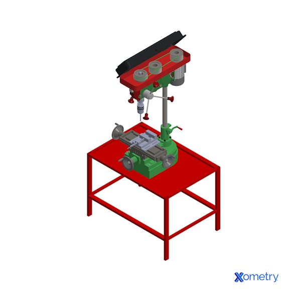

The drill head houses the spindle assembly and power transmission components. Tool rotation is produced by the spindle. Internal components include the drive source and transmission elements that generate and regulate rotational torque. Spindle alignment and runout control depend primarily on bearing precision, spindle machining tolerances, and head casting rigidity.  The enclosure alone does not ensure alignment. Radial drilling machines position the drill head along the arm to access multiple drilling locations on large workpieces. Compact drilling machines mount the drill head directly at the top of the column to conserve space and simplify alignment. Power transfer stability and rotational control originate from the integrated design of the drill head.
5. Worktable
A worktable is  the mounting platform that supports and positions the workpiece during drilling operations. The surface incorporates T-slots that accept bolts, clamps, and fixtures for secure workholding. Adjustable worktables permit tilting or rotation to accommodate angled hole requirements. Smaller sensitive drilling machines use worktables that slide vertically along the column to adjust spindle-to-work distance. Effective workpiece stability depends on table rigidity combined with proper clamping, fixture alignment, and surface condition when using a worktable.
6. Feed Mechanism
A feed mechanism regulates the downward advancement of a drill bit into a workpiece during drilling operations. The system controls penetration rate to match cutting conditions and tool capability. Manual drilling machines rely on hand levers to apply axial feed through operator input. Power feed systems use mechanical or electromechanical drives to deliver consistent feed motion during cutting. Controlled feed progression supports stable chip formation and limits excessive cutting forces. Feed selection influences surface finish, tool life, and dimensional accuracy. Effective drilling performance depends on coordinated feed regulation, spindle speed, tooling condition, and machine rigidity when using a feed mechanism.
7. Spindle
A spindle functions as the rotating element that drives the cutting tool during drilling operations. Mechanical power enters the spindle from the drive system and converts into controlled rotational output at the tool interface. Internal support elements maintain rotational stability and reduce deviation under cutting load. Industrial drilling machines secure large tooling directly within tapered spindle bores, while compact systems rely on chuck-mounted connections. Axial motion occurs when the spindle advances with the quill to engage the workpiece. Cutting consistency and hole quality depend on structural stiffness, rotational balance, alignment precision, and speed regulation associated with the spindle.
8. Chuck
A chuck secures the drill bit to the spindle to enable torque transmission during drilling operations. The mechanism grips cylindrical tool shanks through adjustable jaws that center the cutting tool along the spindle axis. Keyed chuck designs use a tightening key to apply higher clamping force for demanding drilling conditions. Keyless chuck versions permit rapid tool changes through manual tightening. Three jaw configurations provide self centering capability for round shanks. Clamping performance depends on jaw condition, tightening method, and spindle compatibility when using a chuck.
9. Electric Motor
An electric motor generates the rotational force required to drive drilling operations. The motor converts electrical energy into mechanical torque delivered to the spindle through the transmission system. Single phase motors commonly power small benchtop drilling machines. Three phase motors supply higher torque output suitable for industrial drilling equipment. Motor power ratings vary based on machine size, load requirements, and intended application. Induction motor designs support continuous duty operation and stable performance. The motor mounts to the machine head or frame to transmit power efficiently. Cooling systems dissipate heat generated during operation. Drilling capability depends on motor output combined with transmission ratio, spindle design, tooling selection, and cutting parameters when using an electric motor.
10. Power Transmission System
A power transmission system transfers mechanical energy from the drive motor to the spindle during drilling operations. Mechanical elements define the speed and torque ratio delivered to the spindle based on selected configuration. V belt and pulley arrangements permit simple mechanical speed adjustment through ratio changes. Gear drive systems deliver higher torque output suited for heavy drilling applications. Stepped pulleys provide discrete speed ranges through belt repositioning. Timing belts transmit motion without slip when accurate speed transfer is required. Transmission components distribute load and reduce shock during cutting engagement. Spindle performance depends on transmission condition, motor characteristics, load demand, and maintenance practices when operating a  power transmission system.
11. Speed Control Mechanism
A speed control mechanism adjusts spindle rotational velocity to suit drilling conditions. The system enables RPM selection based on calculated cutting speed derived from drill diameter and workpiece material properties. Variable frequency drives provide electronic speed adjustment by controlling motor output. Stepped pulley arrangements offer discrete mechanical speed changes through belt repositioning. Lower rotational speeds support drilling operations that require higher torque and controlled heat generation. Higher rotational speeds support efficient cutting in materials with lower cutting resistance when tool diameter permits. Proper speed selection limits cutting edge wear and thermal concentration. Effective drilling performance depends on coordinated speed control, motor capability, transmission design, and tooling selection through a speed control mechanism.
12. Quill
A quill moves the spindle vertically without requiring movement of the entire drill head during drilling operations. The cylindrical sleeve guides the quill to allow controlled vertical travel toward the workpiece. Hand levers or powered feed mechanisms drive quill movement during tool engagement. Retraction springs return the quill to the upper position after drilling. Precision ground contact surfaces support smooth and consistent motion. In many drill press designs, the spindle rotates within bearings located inside the quill; the quill itself is a non-rotating sleeve that supports and guides the spindle assembly Rack and pinion mechanisms convert handle rotation into linear quill travel. Controlled clearance within the assembly supports stable tool positioning and consistent drilling depth when using a quill.
A drilling machine is a machine tool designed to produce round holes and perform related hole-finishing operations through controlled rotary motion and axial feed of a cutting tool into a fixed workpiece. Its base and column provide stiffness and mass to resist deflection and chatter, while the drill head houses the motor, spindle, and transmission that deliver selectable torque and RPM; the quill and feed mechanism provide guided vertical motion so cutting edges shear material rather than rub or wander. Worktables with T-slots, vises, and fixtures restrain the workpiece against thrust and torque reaction, preserving concentricity and positional accuracy, and depth stops enforce consistent blind-hole depths in production cycles. Coolant or lubrication systems manage thermal load and improve chip evacuation through the flutes, reducing edge wear and improving surface finish. Variants such as bench/sensitive drills prioritize small-hole control, upright and radial drills accommodate heavier parts and reach, multi-spindle and gang drills accelerate repeat patterns, CNC drills coordinate axes for high positional accuracy, and core drilling rigs use hollow diamond bits and water delivery to cut large apertures in concrete with controlled heat and dust.

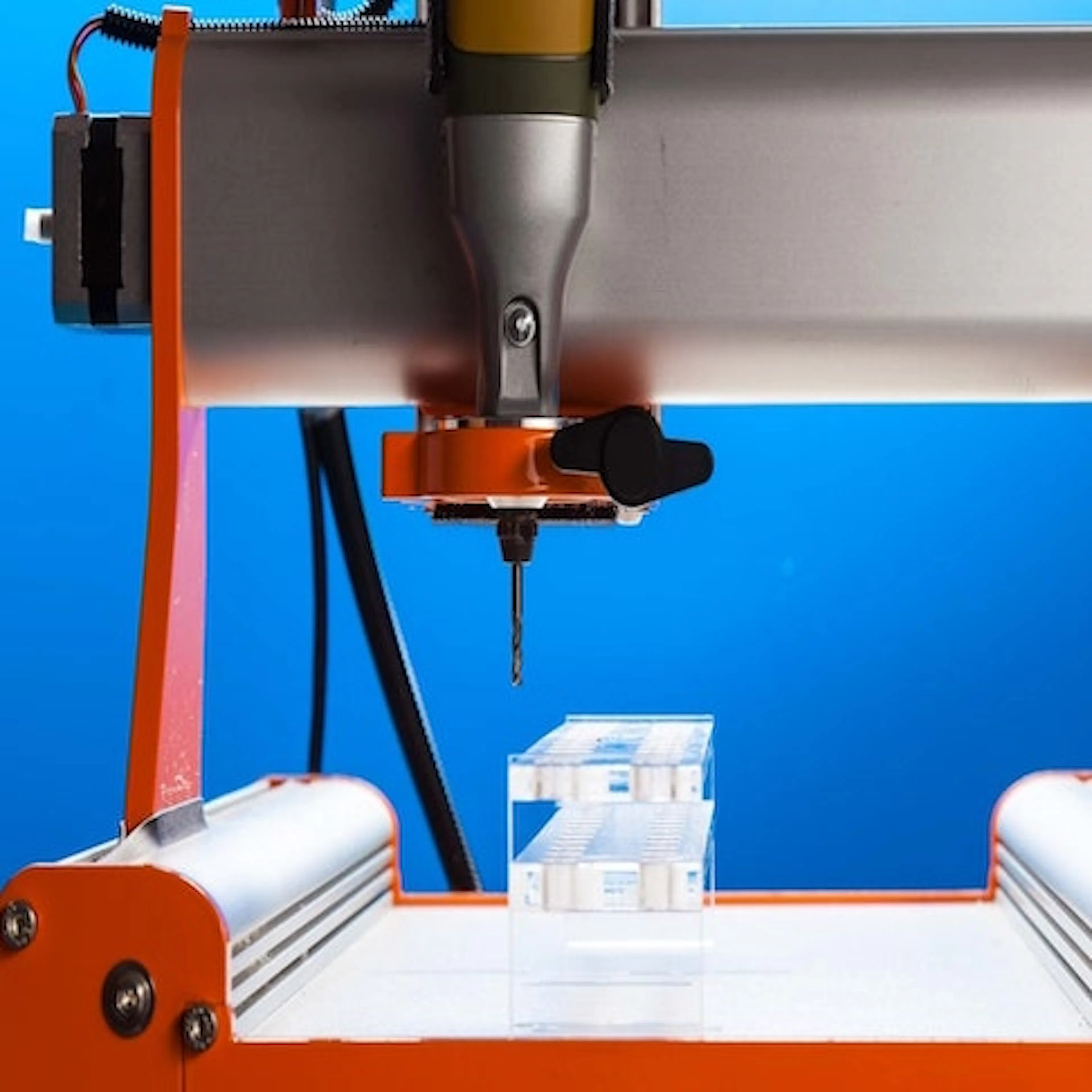

A Computer Numerical Control (CNC) drilling machine produces holes through programmed spindle motion and coordinated axis control (metal parts, composite panels). Machine architecture integrates a CNC controller, spindle assembly, linear motion axes, workholding fixtures, and precision tool holders to support accurate positioning during drilling operations. Automated control manages drilling, tapping, countersinking, and reaming under defined speed and feed parameters. CNC drilling systems are applied in batch and volume production where consistent hole location is required across multiple parts. Process performance depends on control resolution, axis calibration, spindle condition, tooling quality, fixture stability, program validation, and controlled operating parameters when using a CNC drilling machine.

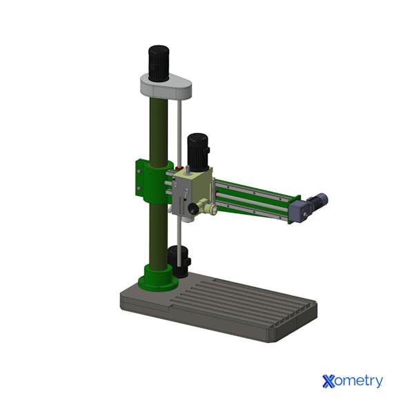

3. Radial Drilling Machine
A radial drilling machine features a movable arm that positions the drill head across large workpieces (steel plates, engine castings). Machine configuration includes a massive base, vertical pillar, horizontal radial arm, and sliding drill head assembly to provide extended reach. Arm rotation and head travel enable drilling, boring, and tapping under high torque conditions without frequent workpiece movement. Common applications include heavy fabrication and large component machining. Process capability depends on arm rigidity, locking accuracy, spindle power, fixture stability, and controlled feed motion when operating a radial drilling machine.

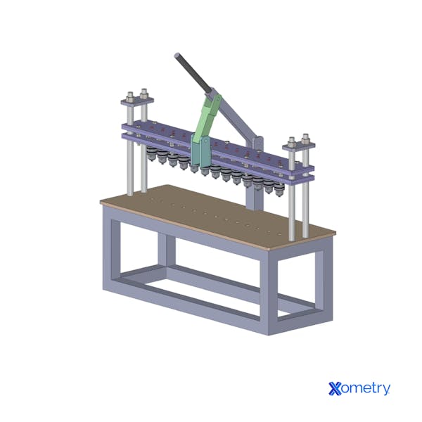

5. Gang Drilling Machine
A gang drilling machine arranges multiple drill heads along a shared worktable to perform sequential machining operations on a single workpiece (drilling, reaming, tapping). Machine structure incorporates independent spindles, individual motors, common table alignment, and coordinated feed mechanisms to support multi station processing. Each station performs a dedicated operation as the workpiece is repositioned along the table. Typical manufacturing applications include metal components requiring repeated hole sequences within one setup. Process performance depends on station spacing accuracy, spindle alignment, feed consistency, fixture rigidity, and controlled workpiece transfer when operating a gang drilling machine.

7. Multiple-Spindle Drilling Machine
A multiple-spindle drilling machine performs parallel hole production through a clustered spindle head that drives cutting tools simultaneously (engine blocks, flanges). Machine construction integrates a main drive gear, universal joints, a cluster plate, and multiple spindles to distribute motion from a common power source. Simultaneous drilling reduces total machining time for repeated hole patterns. Manufacturing applications include automotive and heavy equipment production lines with consistent layout requirements. Process capability depends on spindle alignment, feed balance, tooling condition, and fixture rigidity when operating a multiple-spindle drilling machine.
