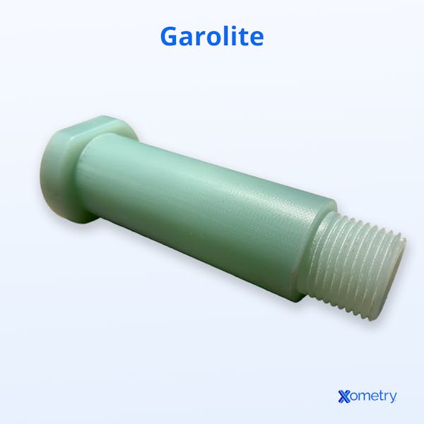

Garolite is a composite material with superior engineering properties. Learn more about its material makeup, mechanical characteristics, design and machining challenges, and finish options.
Machined part made from Garolite
A Composite Solution
Garolite is a high-performance material that offers an install-once-and-last-forever level of reliability. As a composite, it boasts stiffness with superior engineering properties. Read on to understand the considerations of where and how to use this material for maximum value.
Garolite (G-10 or G10) is a composite material created by curing fiberglass and epoxy under high pressures. The resulting glass-epoxy laminate is extremely stable over temperature with low-moisture absorption and a high strength-to-weight ratio. Garolite has electrical insulating properties which are useful for electronic integrations. G-10 also has flame retardant variants, such as FR-4, which are typically used as the substrate for printed circuit boards (PCBs). G-10 is often used synonymously with phenolic as they are both fiberglass composites.
Garolite parts are used in the medical, aerospace, and marine industries due to the material’s dimensional stability, longevity, and resistance to humidity. Corrosion resistance is inherent in G-10 because it is not a metal. G-10 specifies to MIL-I-24768/2 (GEE), MIL-P-18177 GEE and LP-509.
Garolite machined part

G-10 CNC machining or turning typically requires high RPMs and secure workholding. Because of the fiberglass components, proper ventilation and safety equipment is a must. This includes respirators, protective garb, and eye protection for machinists. Medical G-10 parts are typically machined dry (i.e., no coolant) to avoid any material contamination but can also be cut with coolant to mitigate dust. The glass abrades standard cutting tools, so diamond-coated or super-alloy endmills are recommended to extend tool life with this material.
After cutting, Garolite typically produces a significant amount of dust which resembles powder instead of standard machining chips. Machinists should use special care to remove the dust for disposal without blowing it airborne. Machine shops that typically cut Garolite, glass-filled nylon, glass-filled ULTEM (PEI), carbon fiber, and graphite will have dedicated dust evacuation collection systems in the machines to facilitate clean up and avoid dust contamination.
Garolite parts can have features such as threaded holes that are typically milled, not tapped. External threads are turned on a lathe or thread milled instead of using a die. This is because the laminate material has a risk of delamination if enough heat and pressure is generated parallel to the grain.
