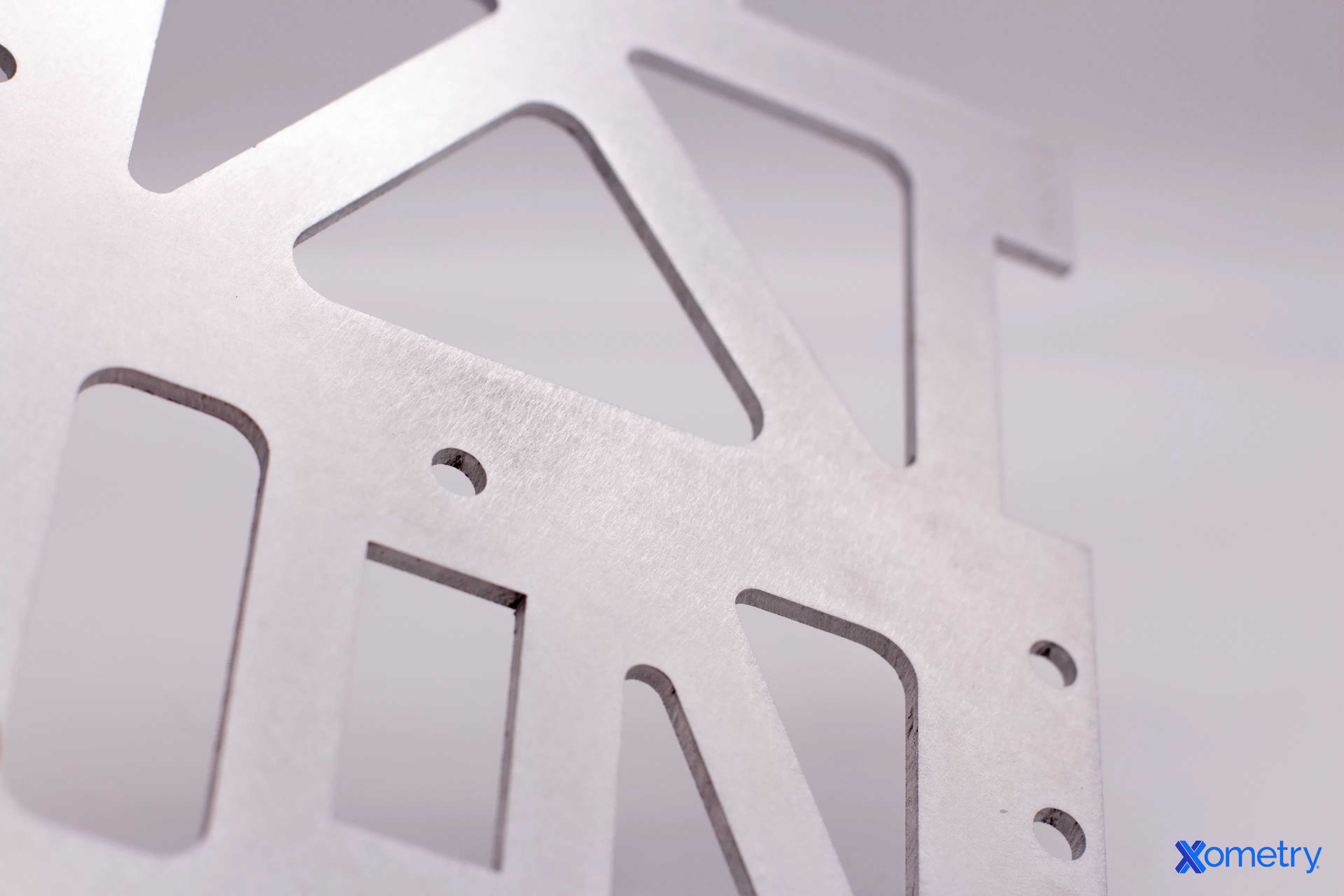

Aluminum sheet metal made at Xometry

Parts must maintain a uniform wall thickness throughout their entirety. Generally, Xometry is capable of manufacturing sheet metal parts up to 3/8" (9.525mm) in thickness, but this tolerance mainly depends on the geometry of the part.
When considering sheet metal thickness, a single sheet with punches (holes) is a good rule of thumb. Some features, such as countersinks are doable, but counterbores and other machined features are difficult to produce as they require post-machining.
