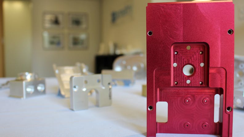

red and silver CNC machined parts
We field lots of questions about our machining capabilities. To help you get the most out of your designs, please refer to the size limitations below for mill and lathe capabilities.
