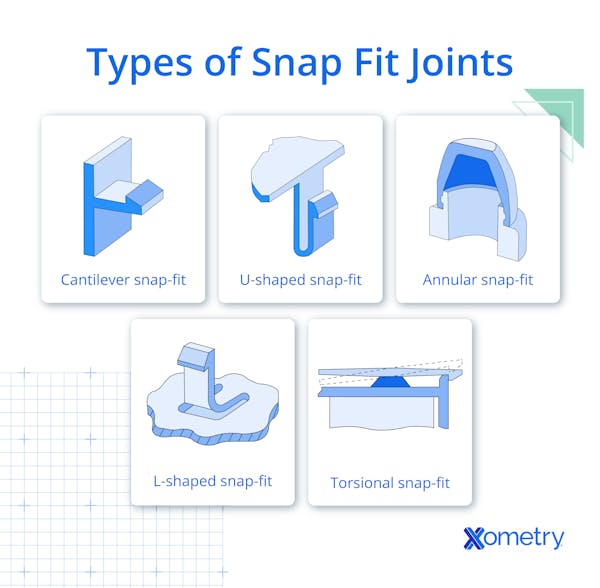

The differences among various types of snap-fit joints lie in their structural designs, the mechanism of action, and application. Listed below are some common types of snap-fit joints
A collage of showing cantilever, u-shaped, annular, l-shaped, and torsional snap fit joints.
  1. Cantilever Snap-Fit Joints: Featuring a single beam that protrudes from one component and locks into place on another, cantilever snap-fits are noted for their simplicity, cost-effectiveness, and ease of use. The beam often has a tapered head that transitions into a hook-like shape, securing the connection. Cantilever joints are particularly versatile and suitable for a wide range of applications due to their straightforward design and ease of disassembly.
  2. U-Shaped Snap-Fit Joints: A variation of the cantilever design, the U-shaped snap-fit extends the beam length to reduce strain and increase flexibility, particularly in applications where space is limited. The U-shape allows longer beams without compromising the connection's integrity, distinguishing it from traditional cantilever designs and offering enhanced durability for repeated use.
  3. Annular Snap Fit Joints: These joints are characterized by a circular protrusion that interlocks with a corresponding circular recess in another part. The design is typically used for cylindrical components. The key feature that differentiates annular snap fits is the circular ridge, which determines the force required for both assembly and disassembly. The design can be adjusted for temporary or permanent connections by modifying the lead and return angles. A 45° return angle typically creates a secure yet detachable connection, while a return angle greater than 45° enhances joint strength but makes disassembly more challenging. A 90° return angle typically creates a permanent joint.
  4. L-Shaped Snap-Fit Joints: The L-shaped snap-fit features a design in which one component has a projecting tab that locks into an L-shaped slot on another component. This design is renowned for its ease of assembly and disassembly. However, it has limitations, such as a lower load-bearing capacity, sensitivity to manufacturing tolerances, potential for permanent deformation under stress, a limited range of motion, and its effectiveness being specific to the application. Despite these drawbacks, its simplicity and reversibility make it a popular choice in many industries.
  5. Torsional Snap Fit Joints: Torsional snap fits involve a twisting action, utilizing a beam that acts similarly to a cantilever but is designed to rotate or twist under force. This type is unique because it employs a torsional (rotational) force for assembly. It is ideal for temporary connections where components may need to be frequently detached and reattached.
