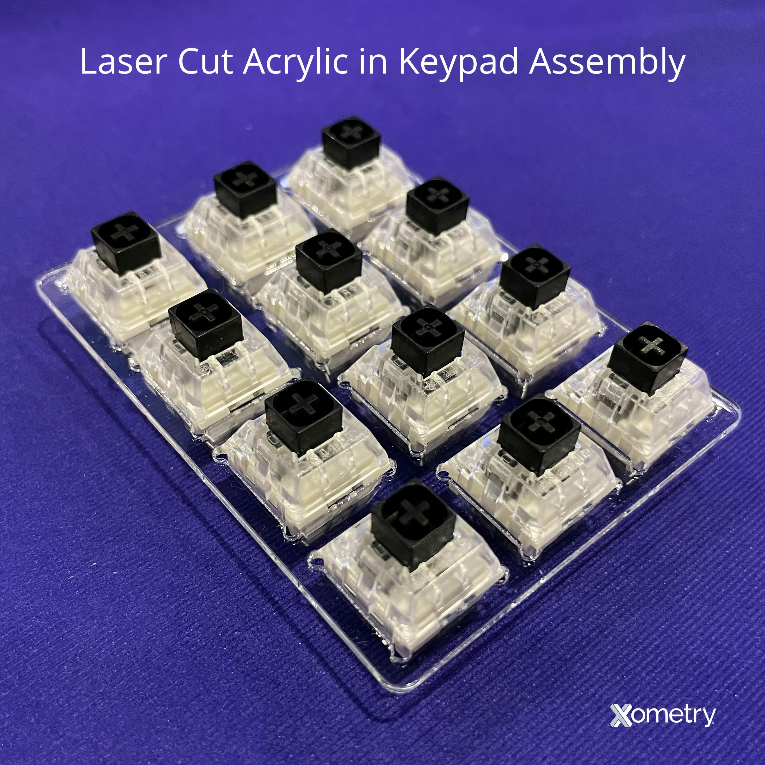

This article will discuss what acrylic is, how to laser cut and engrave it, what steps to take when laser cutting it, and what the optimal acrylic laser cutting settings are. Figure 1 below shows a laser-cut acrylic keypad assembly made by Xometry:
laser cut acrylic keypad assembly

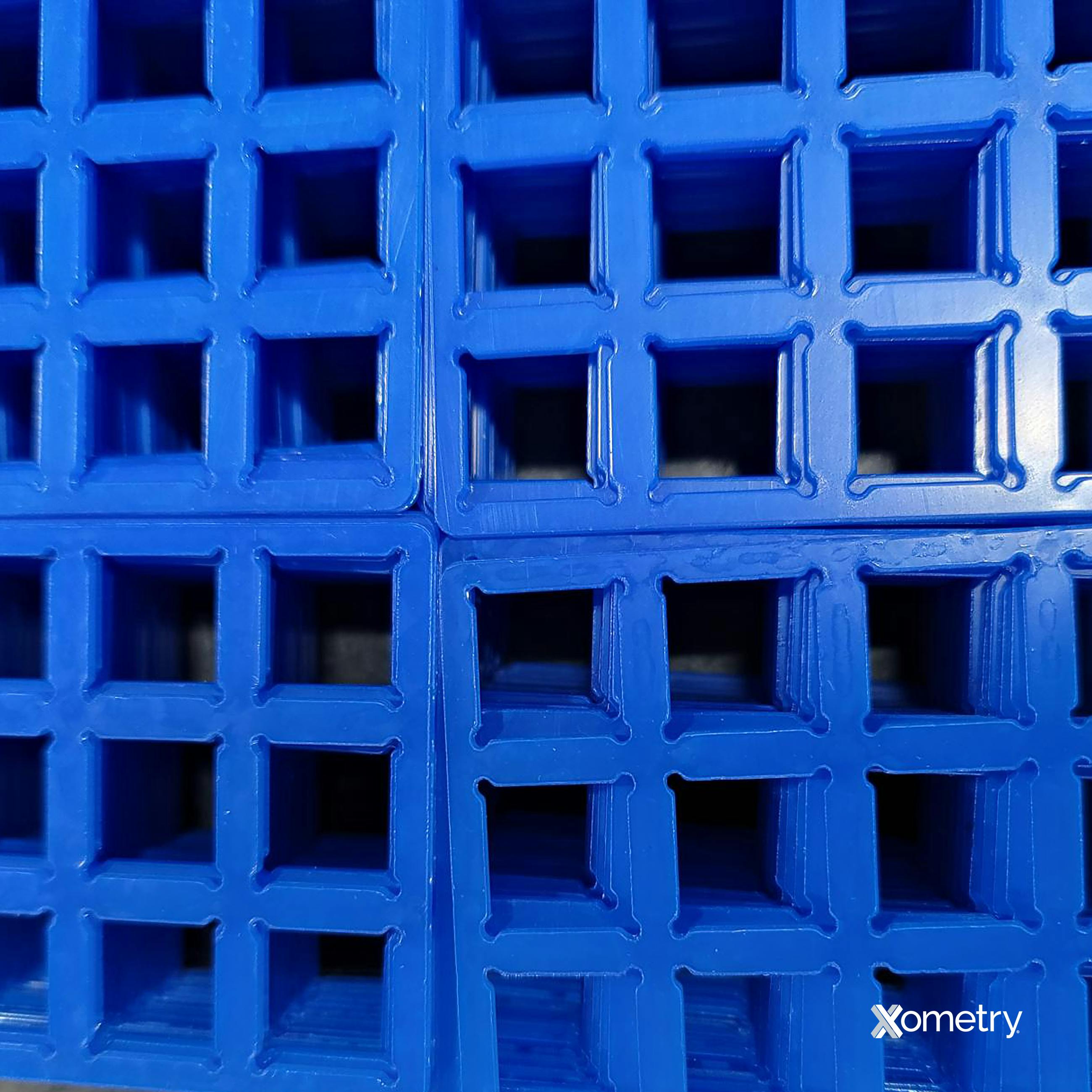

Laser cut acrylic parts from Xometry
