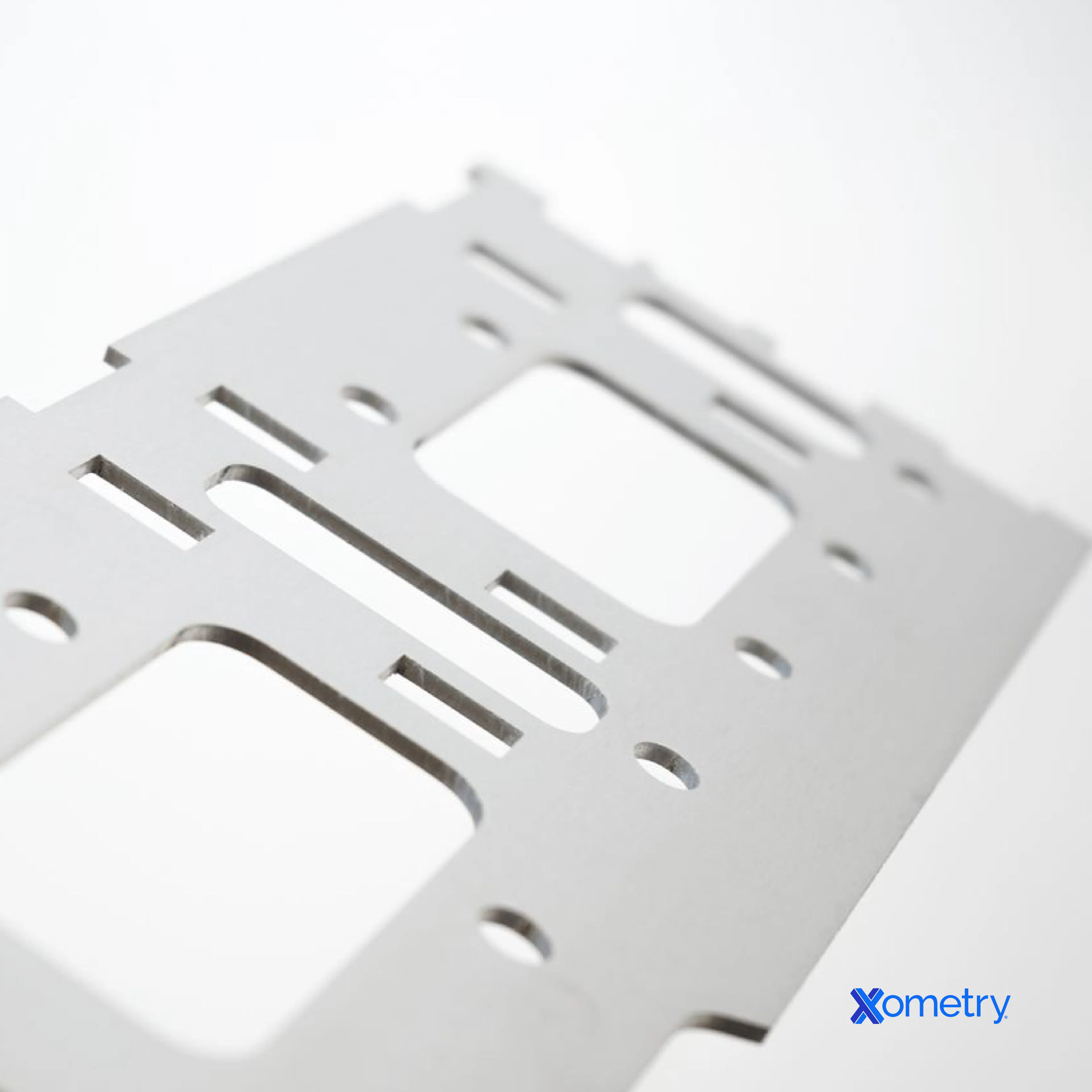

What Is the Primary Purpose of Laser Cutting?
As the name implies, the primary purpose of laser cutting is to cut away portions of a part or material with more accuracy and precision than most other techniques. It is usually performed on metal or plastic items. Designers choose laser cutting for its precision and versatility, as well as its ability to create high-quality finished edges.
laser cut part
Laser cut part
What Are the Advantages of Laser Cutting?
People choose laser cutting over conventional cutting methods because it:
  1. Can cut non-ferrous metals with ease.
  2. Is faster and more reliable than most methods.
  3. Can cut complex geometry with precision.
  4. Creates a high-quality edge that does not require post-processing such as deburring.
  5. Adapts to cutting different geometry.

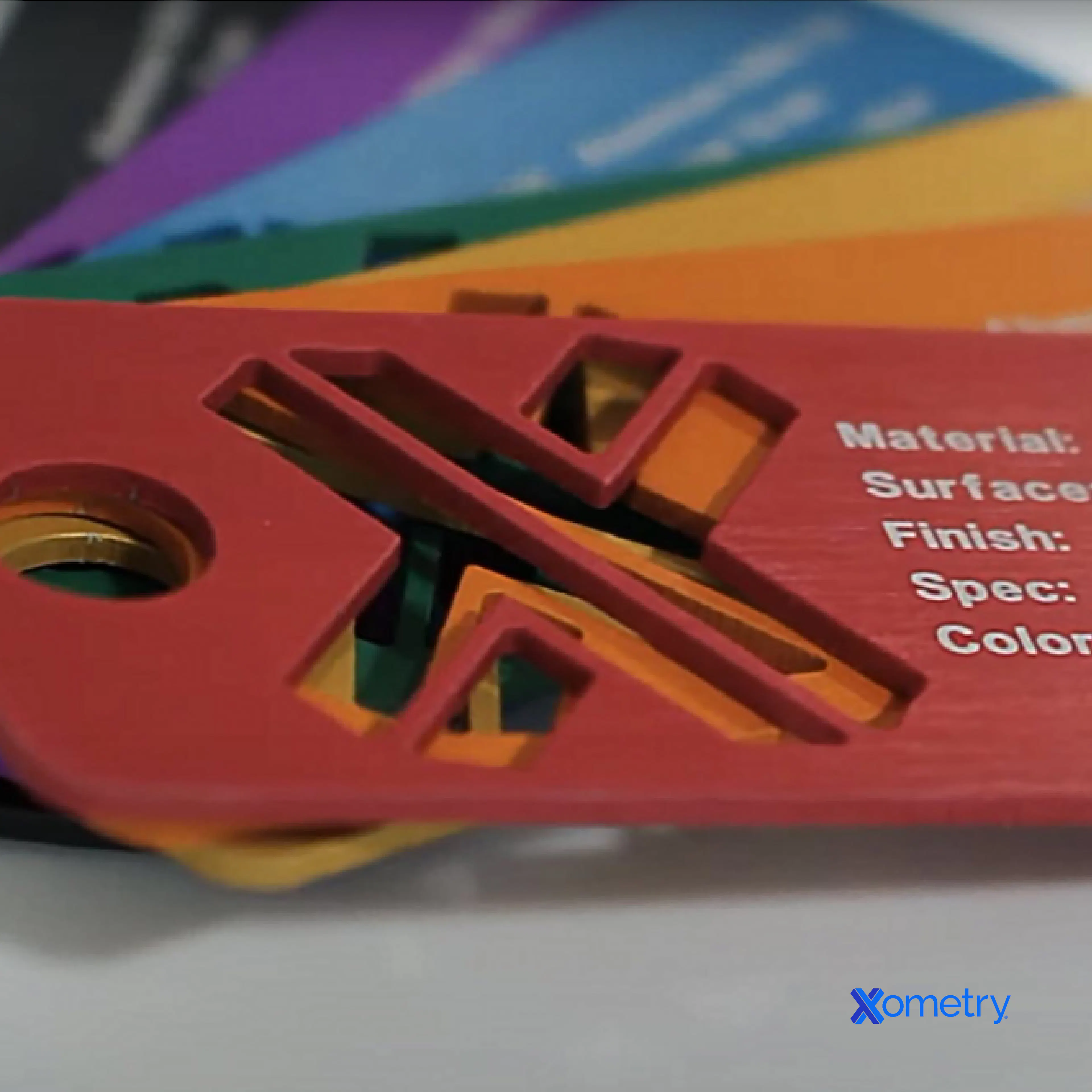

What Is Laser Engraving?
Laser engraving is a process that uses a high-powered laser to melt and vaporize enough material to leave a deep marking. Laser engraving does not, however, penetrate all the way through the material.

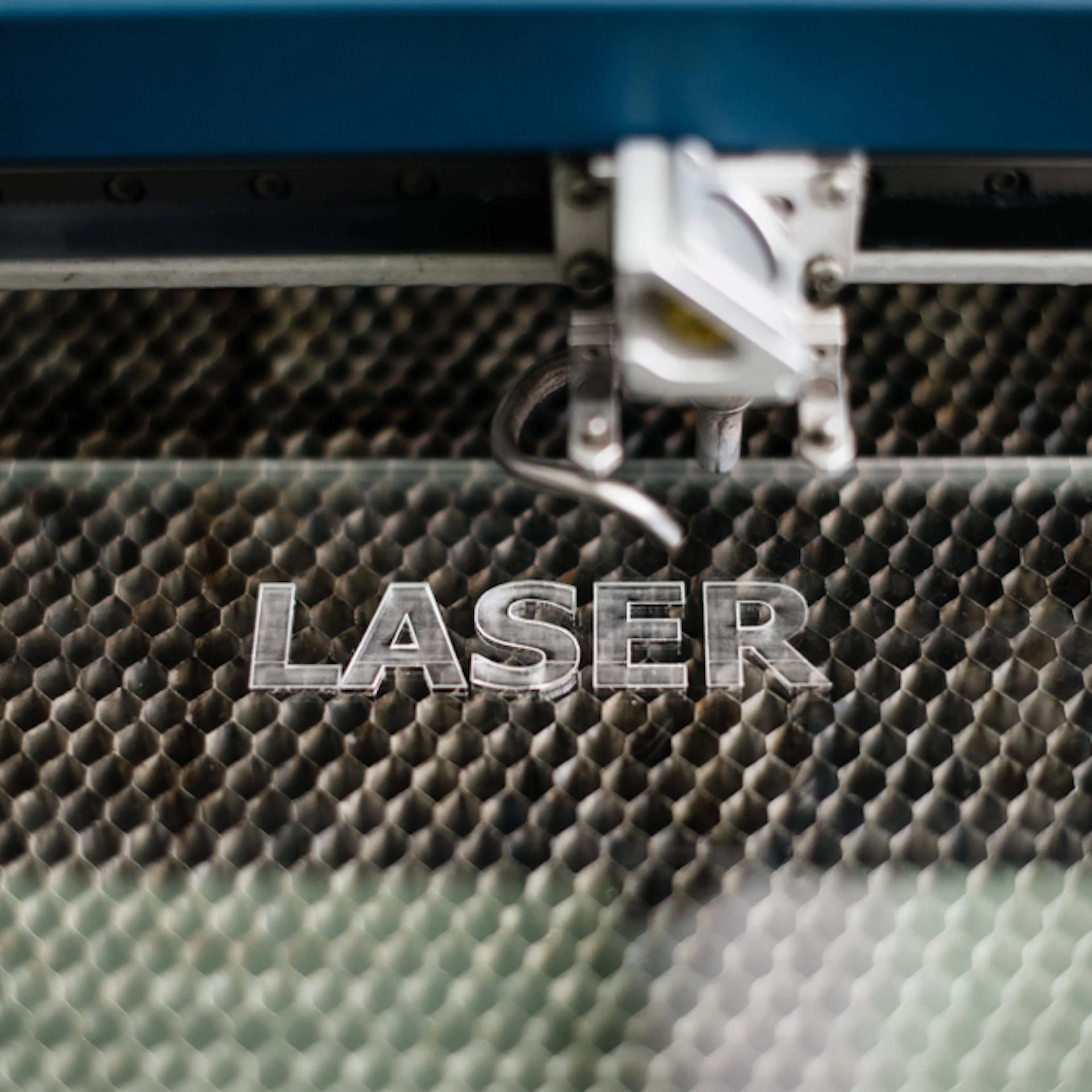

How Does Laser Engraving Work?
Laser engraving works by focusing a high-powered laser on a small area of the material being engraved to melt and vaporize the surface layer. The laser is connected to and controlled by a CNC machine which follows a path set up by preprogrammed G-code software. The pattern in the G-code is created in a CAD model prior to engraving.
What Is the Primary Purpose of Laser Engraving?
The purpose of laser engraving is to create permanent markings. Paint and ink may fade or weather away, but laser-engraved markings are more resilient.
laser engraved part
Laser engraved part

How To Choose Between Laser Cutting and Laser Engraving?
You’ll make your choice between a laser cutting machine and a laser engraving machine based on what you intend to do with it. If the machine is to be used solely for engraving, then a laser engraving machine will be best. However, if you want to do both laser cutting and engraving, then a laser-cutting machine will be the better option. More importantly, the machine you choose will also depend on the type of material you plan to cut or engrave; different materials require different power levels.
Laser cutting is the process of cutting a part out of a sheet of material. Laser engraving is cutting partially through the material to leave a permanent mark. Laser etching is marking the top surface of a part or through a surface finish but does not penetrate the material.
