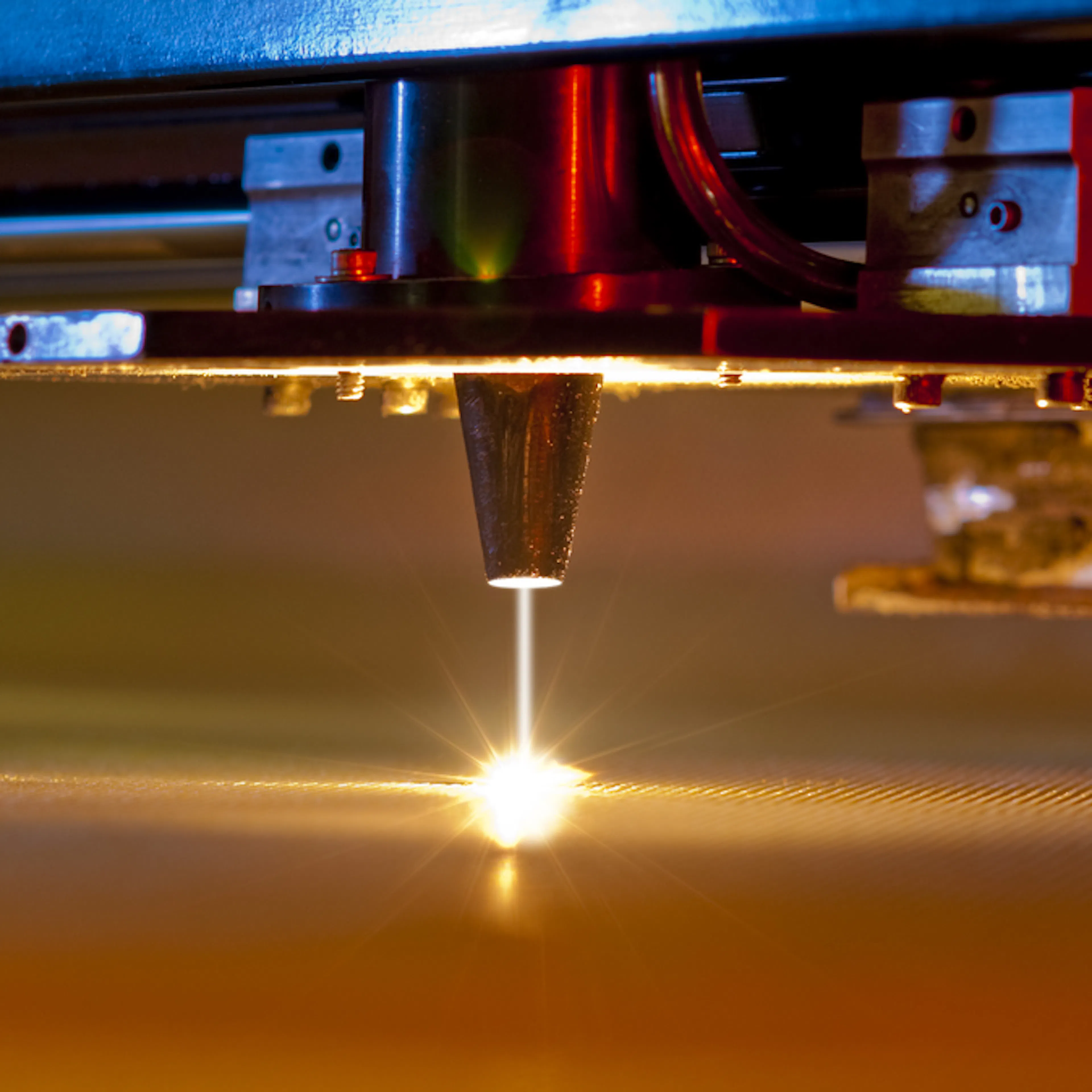

Laser cutter. Image Credit: Shutterstock.com/Christian Delbert

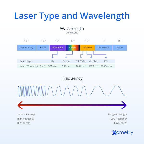

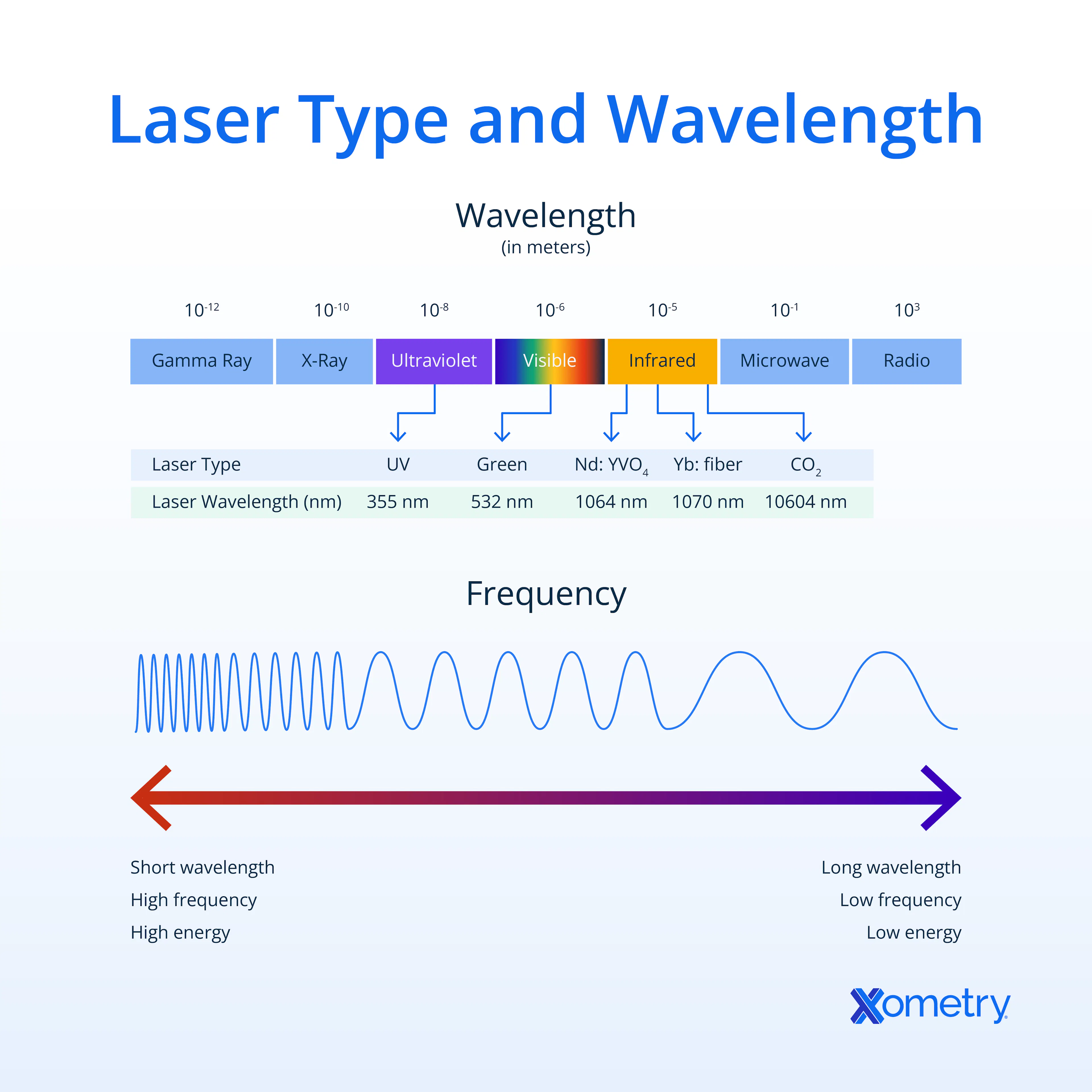

Why Does the Laser Wavelength Vary?
The variation in laser wavelength is a result of design choices, technological considerations, and application requirements. This variation is often intentional and controlled to tune the emitted light to suit specific applications. Typical laser types and their output wavelengths are shown in Table 1 below:
Laser TypeWavelength Range (nm)Typical Applications
Laser Type
Gas Laser
10,600 (CO2), 632.8 (He-Ne), Various (Ar, Kr)
Cutting, engraving, medical procedures, spectroscopy
Laser Type
Solid-State Laser
1,064 (Nd:YAG), 532 (Nd:YAG), 1,550 (Er:YAG)
Material processing, laser marking, medical procedures
Laser Type
Semiconductor Laser
780–1,550 (InGaAs, GaN, GaAs)
Telecommunications, barcode scanning, laser diode modules
Laser Type
Dye Laser
Variable (Depends on dye)
Spectroscopy, medical diagnostics, research
Laser Type
Fiber Laser
1,064, 1,070, 1,550, etc.
Metal cutting, welding, fiber-optic communication
Laser Type
Excimer Laser
UV Range (e.g., 193, 248, 308)
LASIK eye surgery, semiconductor manufacturing, micromachining
Laser Type
Free-Electron Laser
Variable (Wide range including X-ray)
Research, material science, medical imaging
Table 1: Laser Types and Their Characteristic Wavelengths
Lasers are based on various laser-emission media and source/amplification technologies. The choice of laser medium, such as gas, solid-state, semiconductor, or fiber, can influence the achievable wavelengths. For example, gas lasers like helium-neon lasers emit in the visible spectrum, while semiconductor lasers (diode lasers) can emit in the visible, infrared, or near-ultraviolet ranges, depending on the dopants used. The stimulated emission or gain (amplification) medium within the laser system determines the specific wavelengths that can be amplified. The properties of the gain medium, such as energy levels and transitions, dictate the available emission wavelengths. Adjusting the composition or doping of the gain medium can influence the laser's wavelength moderately.
Some lasers incorporate tuning mechanisms that allow for the adjustment of the output wavelength. Quantum-cascade lasers are an example of this. Tunable lasers can be tuned manually or electronically to emit light at different wavelengths within a certain range. This tunability is useful for applications in which several wavelengths are required, and multiple devices are impractical. In certain laser systems, non-linear effects can lead to the generation of harmonics or other wavelengths not directly produced by the laser medium. Non-linear optical processes, such as frequency doubling or parametric processes, can result in the generation of shorter or longer wavelengths. These are usually considered undesirable and will be filtered out.
The choice of pump source used to excite the gain medium can influence the wavelengths produced by a laser. For example, the use of different pump sources in solid-state lasers can lead to variations in the output wavelengths. Techniques such as mode-locking and Q-switching can influence the temporal characteristics of laser pulses, which can indirectly affect the spectral output. These techniques are often used in ultrafast lasers for applications such as femtosecond and picosecond pulse generation.
Laser types and wavelength
