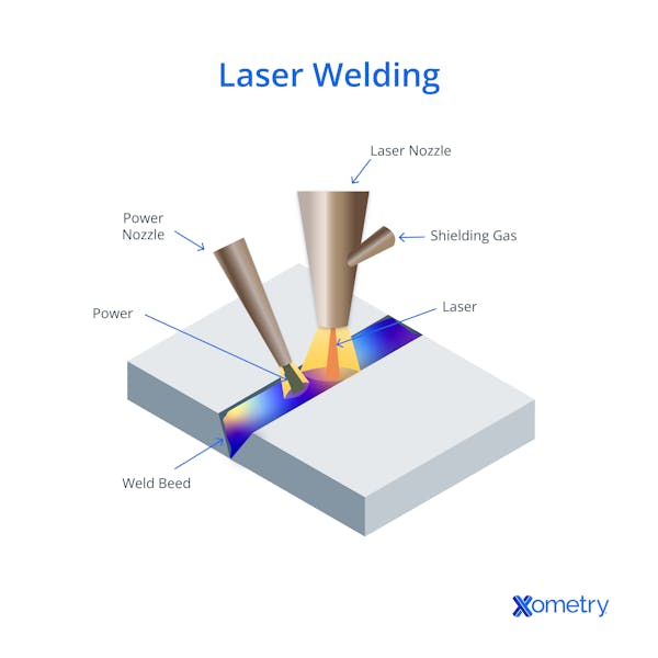

A diagram of laser welding
How Does Laser Welding Work?
Laser welding is a precision joining process that uses a highly focused, high-energy-density laser beam to heat and melt materials at the weld joint. When the beam is concentrated on a specific area, the localized energy input raises the temperature of the base materials to their melting point. The resulting molten pool solidifies rapidly along the beam path, forming a strong metallurgical bond.
An automated control system manages critical welding parameters such as laser power, travel speed, focal position, and shielding gas flow, ensuring consistent and precise weld quality. Due to the laser’s narrow and concentrated heat source, laser welding enables high-speed processing with minimal thermal distortion and a small heat-affected zone (HAZ). This makes it particularly suitable for applications requiring fine welds, deep penetration, or joining dissimilar materials.
