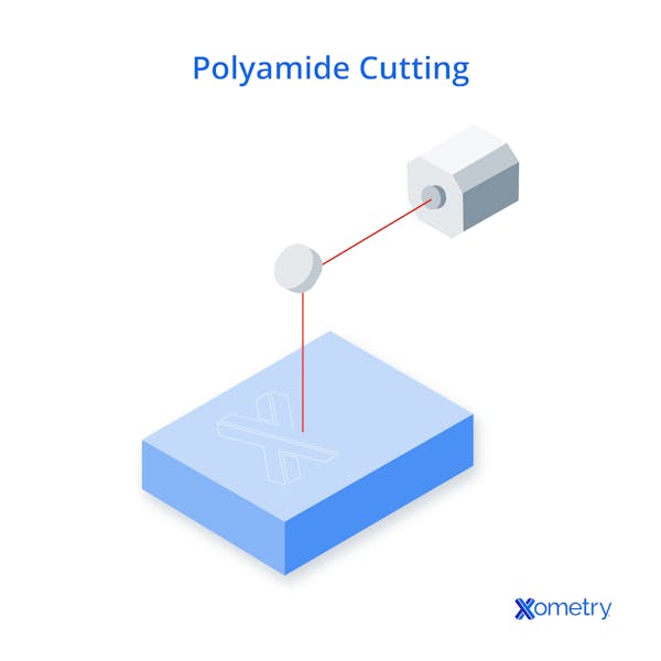

Laser cutting of polyimide involves using a focused laser beam to cut or engrave the material with high precision. Laser cutters use a focused beam of light to process materials like polyimide. CO2 lasers are particularly effective, though the required power varies with material thickness. For example, a CO2 laser with a power of 30 watts is capable of cutting polyimide films as thin as 25 µm and beyond. The optimal settings for cutting polyimide will also depend on the type of laser being used. For example, a 30-watt CO₂ laser may be effective for cutting polyimide film, though optimal speed settings vary by machine and material thickness. Also, take into account the focal length of the laser when cutting polyimide.
When cutting polyimide, it is important to use the correct type of lens. The lens should have a low focus depth to minimize the amount of material heated by the laser. The best way to determine the optimal settings for cutting polyimide is to experiment with different settings and see what works best for your specific material. Kapton® is a well-known brand of polyimide film often used in laser cutting and engraving applications. Kapton is thermally stable up to approximately 400 °C and is used in a variety of applications requiring high-temperature resistance, chemical resistance, and electrical insulation. This article will discuss how to laser cut and engrave extruded polyimide, cast polyimide, and more.
An illustration of polyamide cutting.
