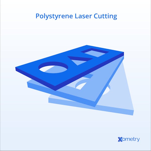

An illustration of polystyrene laser cutting
