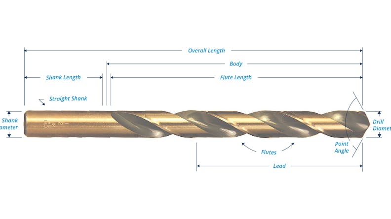

The Anatomy of a Drill Bit:
As obvious as some of these terms might seem (some more than others), understanding the anatomy of your drill bit is crucial to understanding their uses, strengths, and flaws.
Overall Length (OAL) - This is the measurement from the base of the drill bit up to the cutting point.
Body - This definition may seem basic, but it actually only includes the length of the drill from the outer corner of the cutting lips just to the end of the flutes. In other words, the flute length, but slightly less.
Lead - The lead is the length of the actual cutting surface of the drill bit. This measurement is a tad shorter than the flute length.
Flute Length - This is basically the span of the flutes on the drill bit, from the leading edge of the cutting tip just to the end of where the flutes taper out.
Flutes - Flutes are the sharp slots that corkscrew upwards along the length of a drill bit. They are responsible for doing the cutting work when the drill bit is spinning.

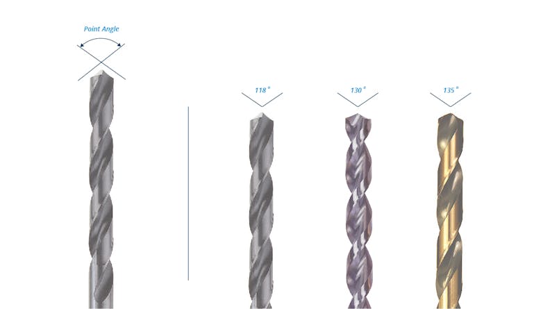

Point Angle - The point angle, or cutting angle, is the angle between two lips when it is projected onto a plane parallel to the axis. More simply, it is the angle between the lips in the side view of a twist drill. The typical value of the point angle is 118°.
Drill Diameter - This term is pretty self-explanatory.
Neck - The neck is between the shank and the flute. The neck allows space for chip evacuation and prevents the shank from rubbing during deep-pocket milling applications.
Shank - This is the non-cutting end of the tool that is held by the tool holder, or chuck.
Shank Diameter - The shank diameter is the width of the shank. This measurement is essential to note when buying or choosing a tool, so that you can be sure to pick the correct shank size for the tool holder being used. Shank diameters require tight tolerances and concentricity in order to fit properly into any holder.
Shank Length - You know… the length of the shank.

Conventional Drill Points are the most common tip style for general purpose drills, and usually have a tip angle of 118°. These drills are great for a range of material applications, including wood, non-ferrous metals, and mild steel. Conventional drill point drills are relatively inexpensive and are easily re-sharpened. It is worth noting that if you sharpen your drill bits, you run the risk of ruining their protective coating. Kind of a downer depending on your use type.
General-purpose drill points are often 118° angled drills, which are typically used for cutting into soft metals such as aluminum. The 135° variant of this drill bit is best suited for harder materials like stainless steel. A 135° drill is flatter than 118°, meaning more of its cutting edges engage with the material surface sooner in the drilling process.
A Split Point Drill is an advanced drill point that does a great job preventing any walking your drill bit might want to do, and overall provides improved penetration with less effort. Available in 118° or 135° degree angles, split point drill bits are better for drilling curved surfaces or in alloy steels. These puppies are more expensive and more difficult to re-sharpen.

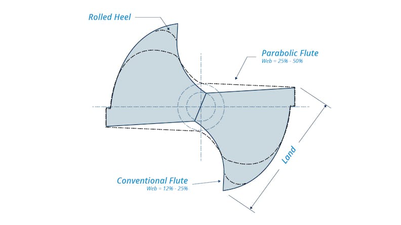

Flute Styles:
Your tool type (read: speed and feed), material type, operation type, and the drilling depth you’re after are the most important factors for choosing a flute style.
Most twist drills have flutes that expel the chips at an unspecified angle and are pretty suitable for most applications. When you need something a bit (puns, amirite?) more specific, there are a range of other specialty twist drills. For example, drill bits designated as “High Helix,” “Fast Spiral,” “Low Helix,” and “Slow Spiral” are all designed for specific applications requiring higher or lower spindle speeds or feed rates. These guys are pretty much only good at their specific jobs, though, so don’t mess around.
