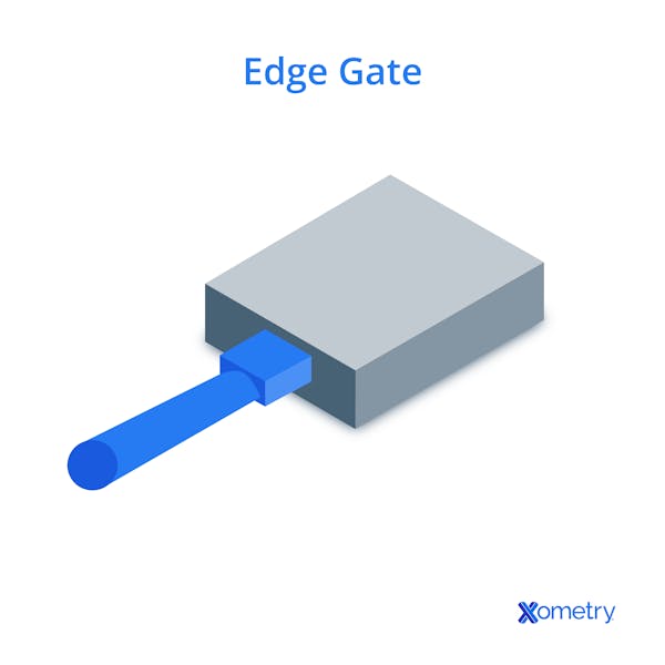

Edge Gates
Edge gates, which can include fan and tab-shaped gates, are the most common ways to gate a tool. An edge gate introduces material at the main parting line, or where the two halves of the mold meet, with a perpendicular runner. Because edge gates are easy to machine, they can be widened or modified to help material flow. Edge gates typically require the runner to be removed after molding through a manual or automated cutting operation. Edge gates tend to leave square or line-like vestiges.

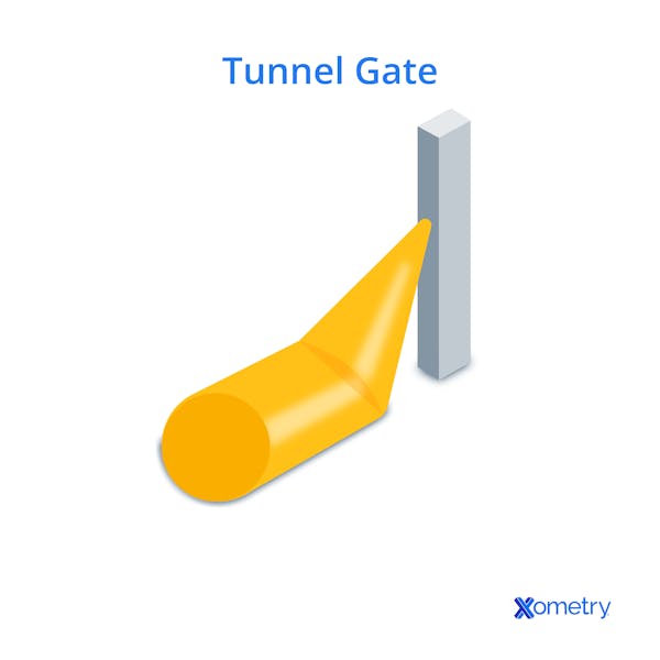

Tunnel/Submarine Gates
Smaller parts or features may require a tunnel or submarine gate. These “subgates” are conical, tapering to a smaller round feature below the parting line. Unlike edge gates, a tunnel gate has a much smaller cross-sectional area, which dictates how the material enters the cavity under pressure; this may be a limitation to how subgates can be used on larger parts.

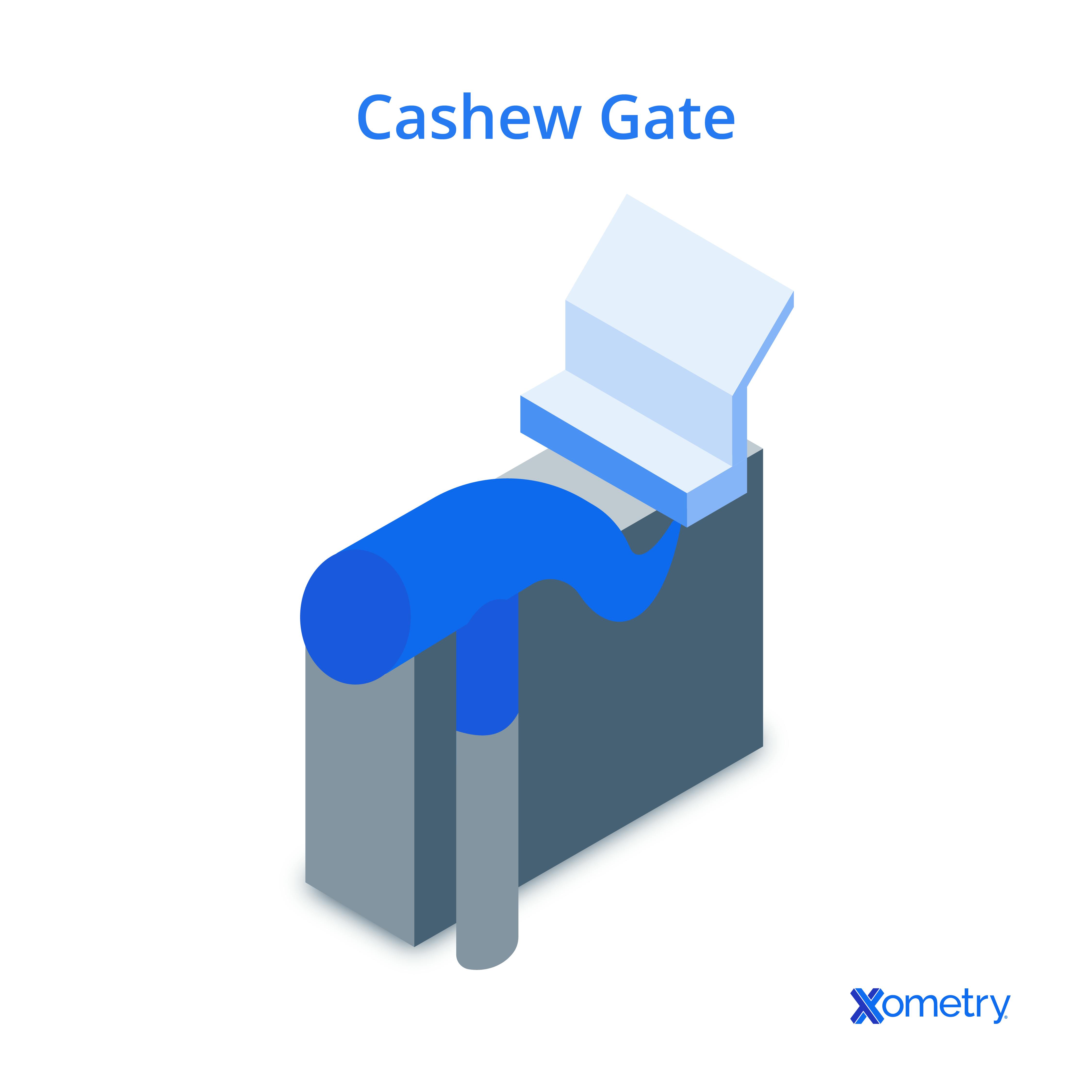

Cashew and Direct Sprue Gates
Some gates may not require manual shearing or removal of the runner. For example, cashew gates are similar to tunnel gates by being located below the parting line but their design allows for the runner to automatically shear off after molding. Edge, tunnel, and cashew gates can be strategically placed in one or multiple locations of the mold. They can also be used in multi-cavity molds where material is channeled through a tree-like runner.
For single-cavity molds, a direct sprue gate can be placed in the broadest cross-section of a part, having a linear channel on the core side. Directed sprue gates are often centered on the broad face of a part and can have a circular vestige.

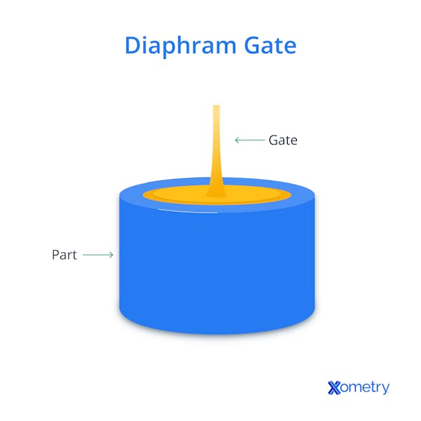

Diaphragm Gate
For molded parts with large open diameters, such as an opening to allow a knob or connector to pass through, a diaphragm gate can be used. Diaphragm gates appear like a membrane across the circular opening on a part and get sheared off after molding. Diaphragm gates may be required for an even fill of material, mitigating large knit lines across cylindrical or conical features. Alternatively, an array of edge or fan gates may be used inside large openings like a bezel for an LCD screen with a similar effect.
