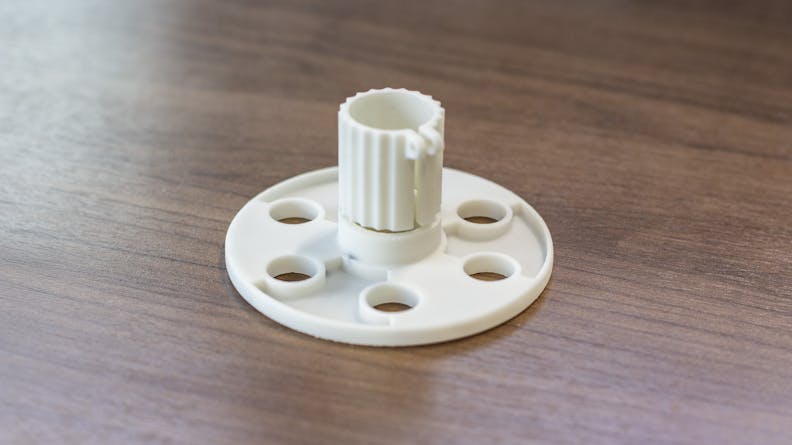

When to Use Ceramic-Filled SLA Materials
A crisp ceramic-filled SLA part, made from Somos® PerFORM
Xometry offers 2 ceramic-filled materials for 3D printing; SLA Somos® PerFORM and Accura® Bluestone™. Both materials will create a highly stiff structure with a smooth stone surface finish when 3D printed. This process, combined with the use of ceramic-filled materials, produces parts that are extremely CAD accurate when compared to most additive processes. Ceramic-filled SLA parts are best used in devices and prototypes that require thermal stability over a range of temperatures. In addition, ceramic-filled SLA materials are typically useful in others applications including mounted fixtures and optical devices where high accuracy and stability are paramount.
If you are looking for a material with the highest level of stiffness, along with solid heat and abrasion resistance and excellent chemical resistance, consider using Accura® Bluestone™. On the other hand, if you are looking for a material that is faster to build, easier to post-process clean, possesses superior sidewall quality, and provides unmatched detail resolution, you may want to consider using  Somos® PerFORM material. It is the ideal material for creating strong, stiff parts with excellent high heat resistance, including wind tunnel models for aerospace and automotive applications, as well as rapid tooling for an injection molding project

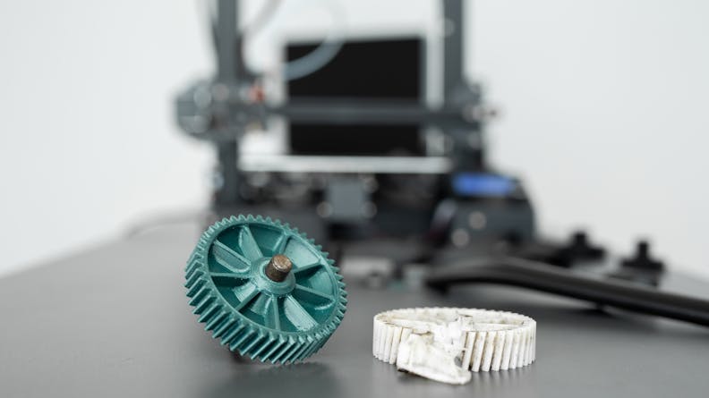

When Not to Use Ceramic Filled SLA
A picture of 2 plastic parts, one intact and one that is broken.
Image Credit: Freepik.com/Seguir
If you want to print a custom part with fine, delicate features, you may want to avoid using ceramic-filled SLA materials. Ceramic-filled materials have practically no flexibility, unlike many SLA resins meant to mimic thermoplastics. Their lack of flexibility can make it very fragile. This is a very important distinction, as this highly stiff material will snap rather than bend if you expose it to pressure. It is also important to remember that materials like Somos® PerFORM and Accura® Bluestone™ are not pure ceramic material; they are made from a resin slurry mixed with ceramic materials. Unfortunately, this means that it can’t withstand heat as well as a pure ceramic material.
