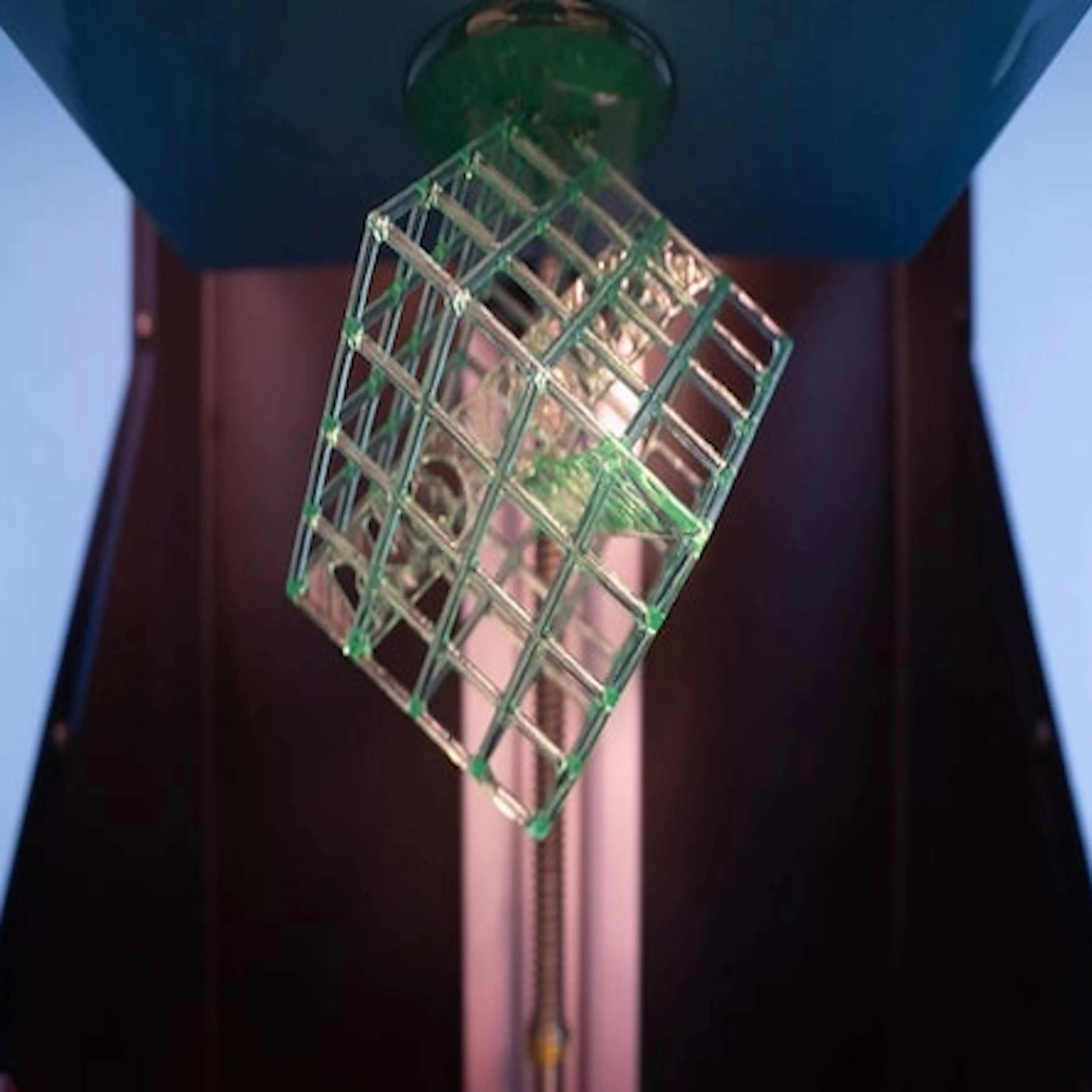

The digital light process typically works by lowering a build platform into a transparent resin tank filled with liquid photopolymer. A high-resolution projector then shines a UV light onto the build platform in the same shape as the cross-section of the part layer. The cross-section projection is created with an array of microscopic mirrors called a DMD that direct light only where needed. The density of the array determines the print resolution. This style of DLP printer builds the object upside down.
In rarer cases where the part is built right-side-up, a thin layer of resin is smeared onto the build platform. The DMD can then direct light down from above to form that first layer.
The only photopolymer that gets cured is that which is both illuminated and physically in contact with a solid surface (the build platform or a previous layer). Most upside-down DLP printers run a peeling action across the bottom of the reservoir after each layer to remove any resin that cured at the bottom of the tank. Once a layer is complete, the build platform moves up by the thickness of one layer, and the process is repeated until the part is completed. For right-side-up DLP printers, after one layer is complete, the build platform will move down by one layer, and another layer of resin is smeared over the top of the previous layer.
A finished DLP part is effectively constructed of thousands of small cubic volumes; the cube’s cross-section is equal to the projected mirror size and the cube height is equal to the layer height. Each of these cubic volumes is called a voxel.

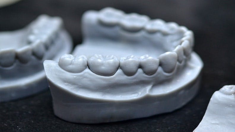

How is DLP 3D Printing Used in the Medical Industry?
DLP 3D printing is extensively used in the medical industry—particularly in dentistry. Accurate dental models, anatomical models, surgical aids, and custom-fit prosthetics are all great fits for this printing technology.

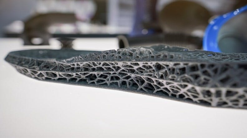

How is DLP 3D Printing used in Midsole Manufacturing?
Rubber-like materials can be DLP 3D printed into the shape of shoe midsoles with complex internal lattice structures. These structures remain flexible like traditional midsole materials but limit the overall mass. DLP is well suited to this because it can so accurately print complex hollow structures using elastomeric materials.
