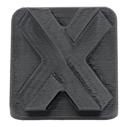

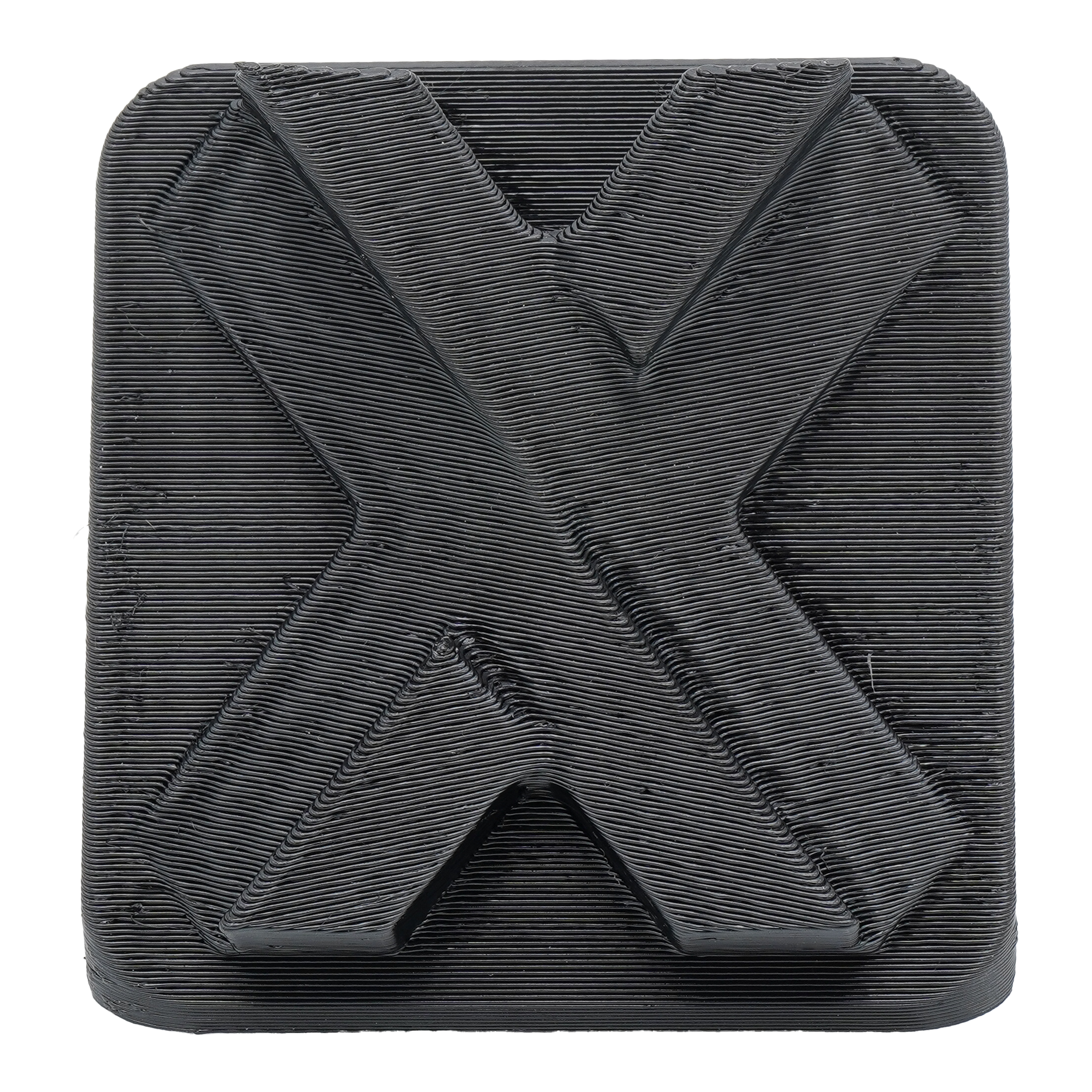

Stratasys Antero 840CN03 PEKK
This specialized FDM material is a high-performance thermoplastic based on the PEKK polymer family, featuring inherent Electrostatic Dissipative (ESD) properties. This is achieved by incorporating 3% carbon nanotube filler by weight into the PEKK formulation. This inclusion allows the material to safely conduct and dissipate static charges, preventing the buildup of static electricity that can damage sensitive electronic components during manufacturing or assembly. Antero 840CN03 retains the superior chemical and heat resistance of the PEKK family, providing an ideal solution for critical applications that require protection against static discharge, such as electronic housings, fixtures for handling integrated circuits (ICs), and tooling used in satellite and avionics production.
Xometry X-tile printed in Antero 840CN03.
Antero 840CN03 Properties
Tensile Strength, Yield (XZ MPa-ZX MPa)Elongation at Break (XZ%-ZX%)Heat Deflection Temperature (℃) @ 66 psiSurface ResistanceData Sheet
94.9-56
2
149.5°C
Surface Resistance
10^4Ω - 10^9Ω

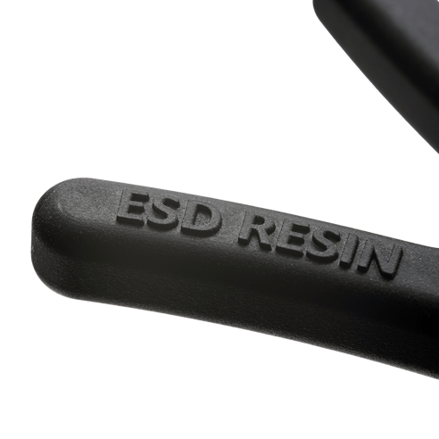

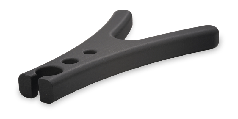

Formlabs ESD Resin
Formlabs ESD is an engineered resin that creates cost-effective prototypes and end-use parts. Its material properties make it suitable for small electronic device tooling, jigs, fixtures, and housings. Since the material is printed using our Stereolithography (SLA) service, you can expect high-resolution parts with superior details and surface finish. This material instantly quotes in the Xometry Instant Quoting Engine®, allowing for fast procurement of custom ESD-safe components.
Close up image of a part made with Formlabs ESD resin.
Formlabs ESD Resin Properties
Tensile Strength (MPa)Elongation at Break (%)HardnessHeat Deflection Temperature (℃) @ 66 psiSurface ResistanceData Sheet
44.2
12
Hardness
90 Shore D
62.2°C
Surface Resistance
10^5 Ω - 10^8 Ω
