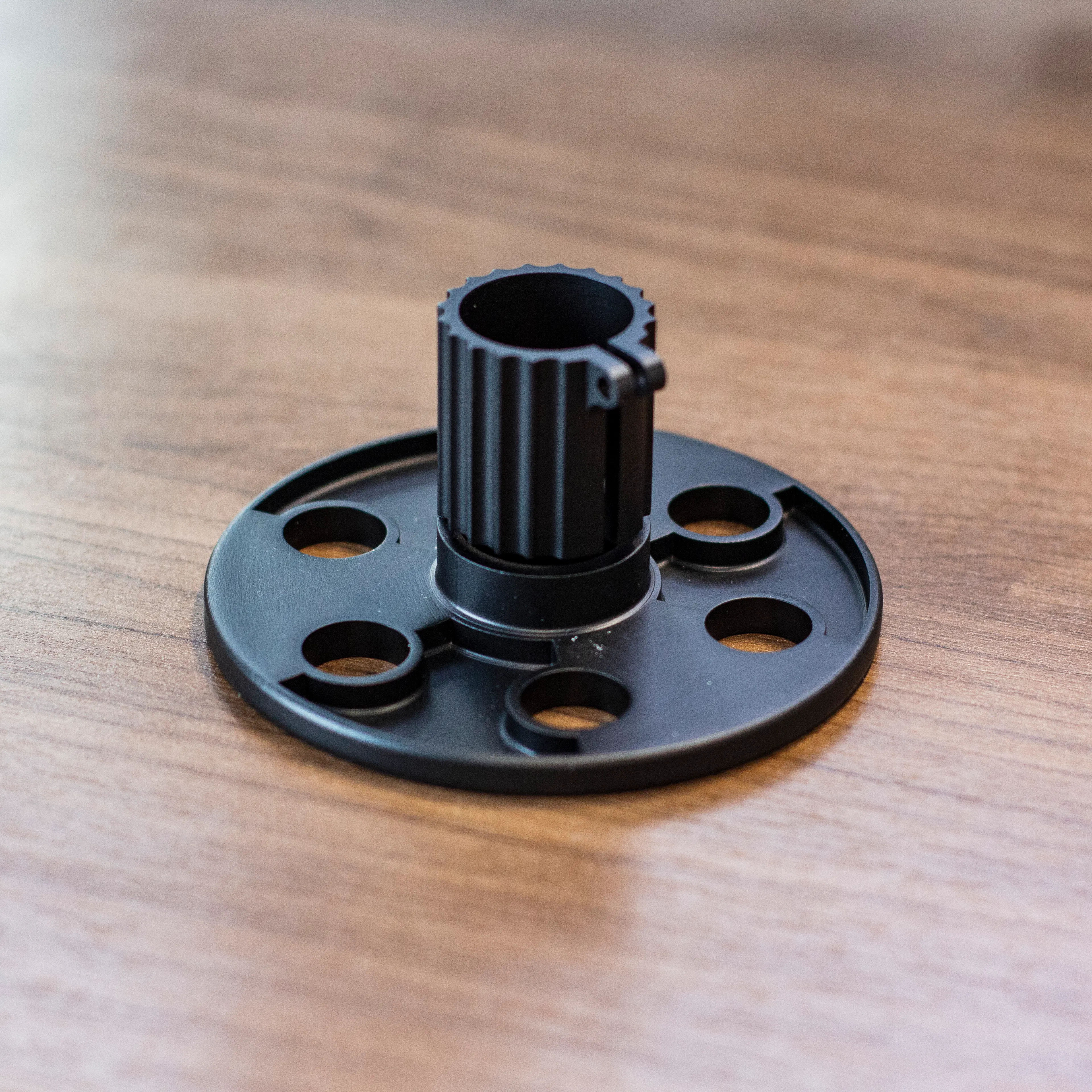

There are different causes of part bowing in FDM and resin prints. Let's explore the what, why, and how part bowing occurs and then look at some methods to prevent it in the first place.
Part bowing in 3D printing is a phenomenon whereby the corners of a printed part lift off the build plate. Hobbyists and professional 3D printers alike, whether they use an FDM (fused deposition modeling) or resin printer, will experience part bowing at some point in time.
