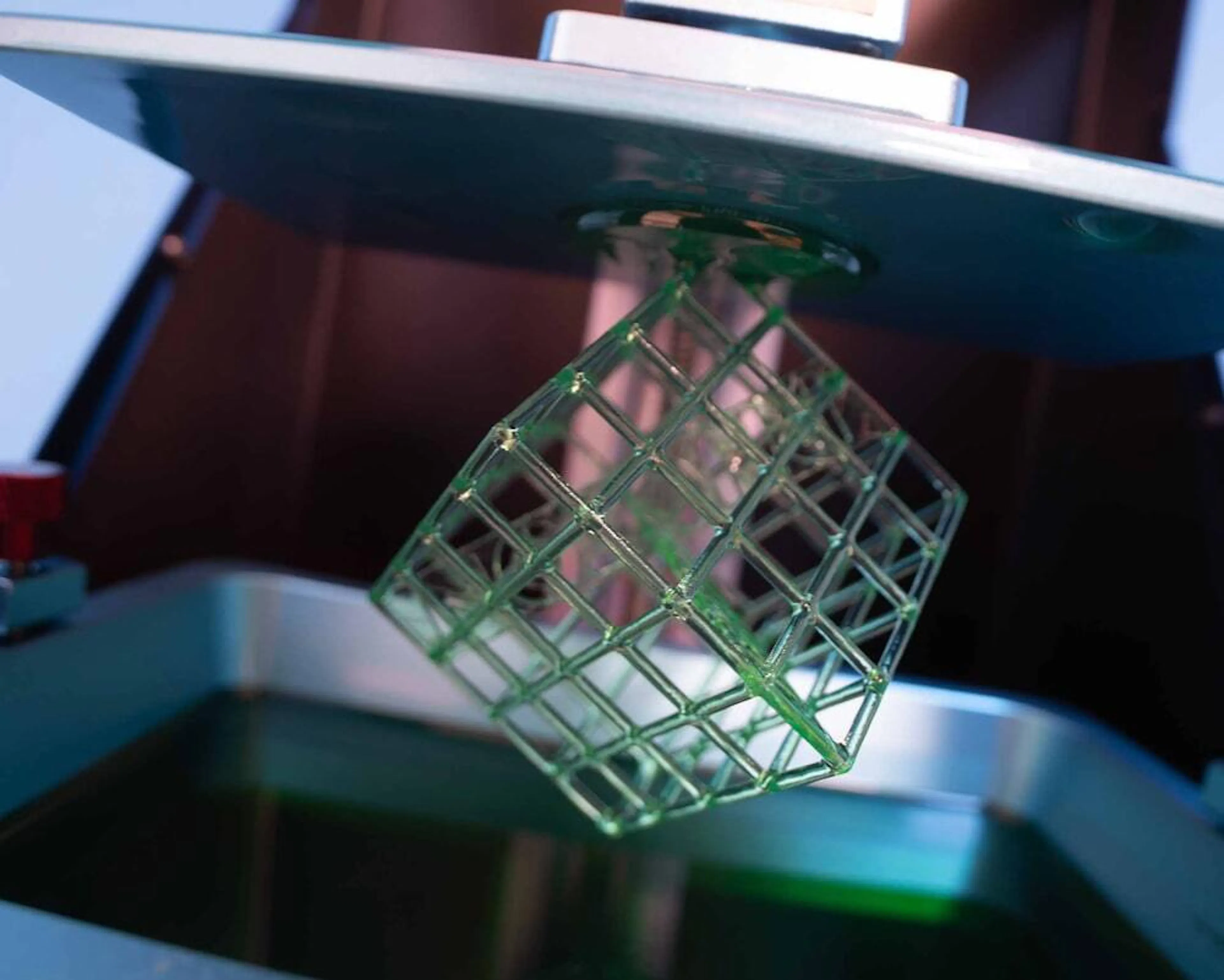

Stereolithography is a photopolymer-based 3D printing technology. It was first invented by Hideo Kodama in 1980. Six years later, SLS was commercialized and patented by Charles Hull. SLS works by shining a UV laser against a scanning mirror. The mirror directs the laser light in a pattern that traces out the cross-sectional pattern of a single layer of the part. This laser light polymerizes the photosensitive resin wherever it hits a solid surface – either the build platform or the previous layer. After each layer is polymerized, the build platform moves upwards. The part will thus appear to grow out of the liquid.
SLA 3D printers can produce larger parts with more consistently smooth organic surfaces when compared to DLP 3D printers.

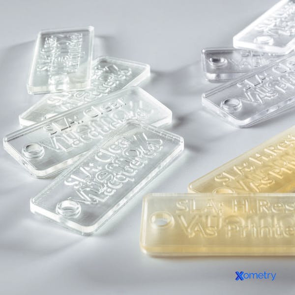

SLA parts made at Xometry
