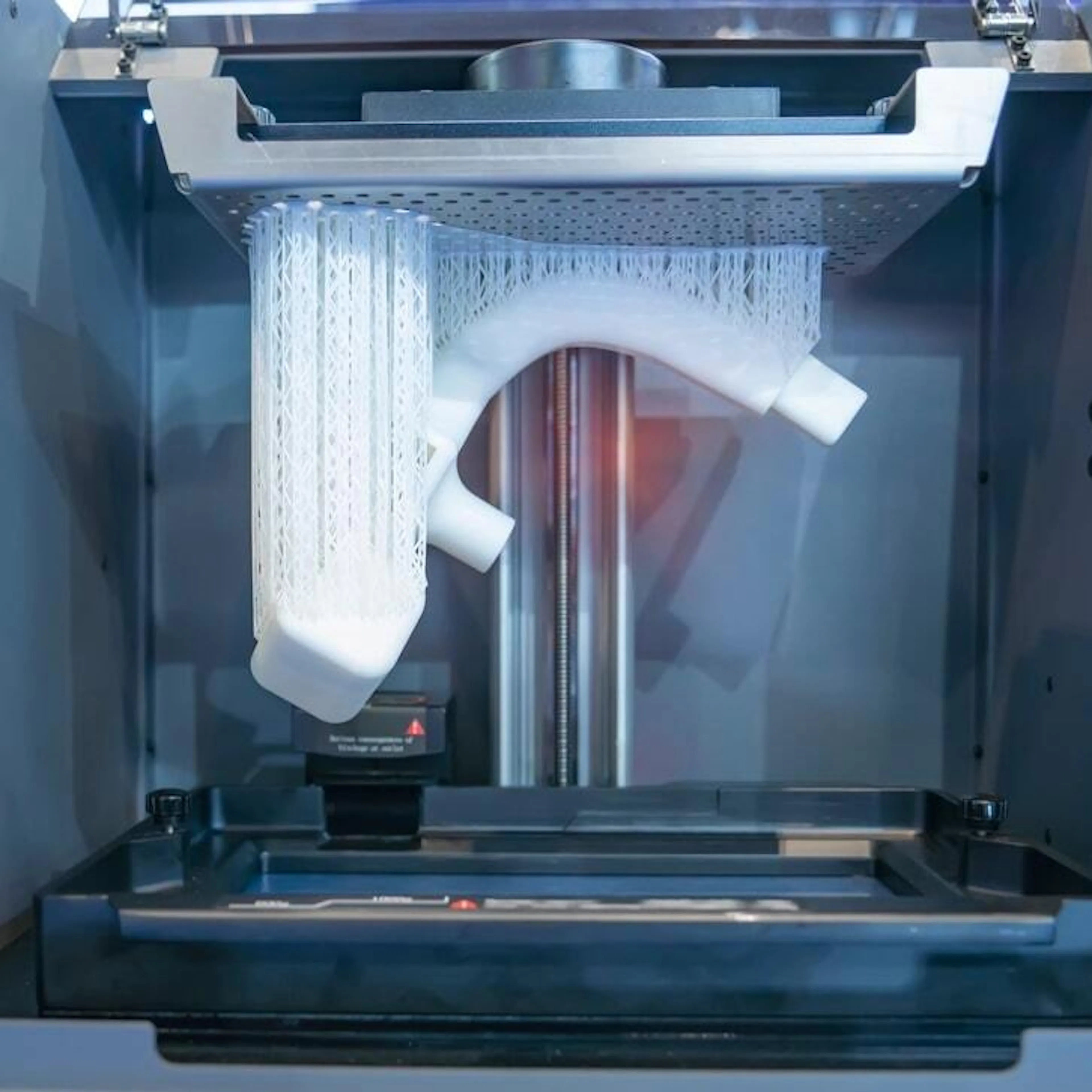

SLA is a 3D printing process that uses a scanning UV laser to cure the surface layer of photosensitive resin. The resin is supplied in a bath, and, in the vast majority of SLA machines, the part is built upside-down. With each layer, the build plate will move upward, making it appear as if the part grows out of the liquid polymer. The machine must also print necessary support structures to support overhangs within the design.
The UV-sensitive photopolymers used in the process are collectively referred to as ‘resins.’ They are photo-catalyzed acrylic monomers that become crosslinked when exposed to UV laser light. This principle allows the machine to create details as small as the laser beam’s width.
SLA models are sometimes printed in a partially cured state. These models require post-processing in the form of extra UV exposure to complete the cross-linking process. This additional process step helps eliminate partially solidified resin that didn’t fully cure due to back-scatter and diffraction of the UV beam. Whether or not post-curing is performed, all parts must be washed after printing is complete to remove the surface resin. Washing is generally done in an isopropyl alcohol bath. The removal of the printed support scaffold takes place afterward.

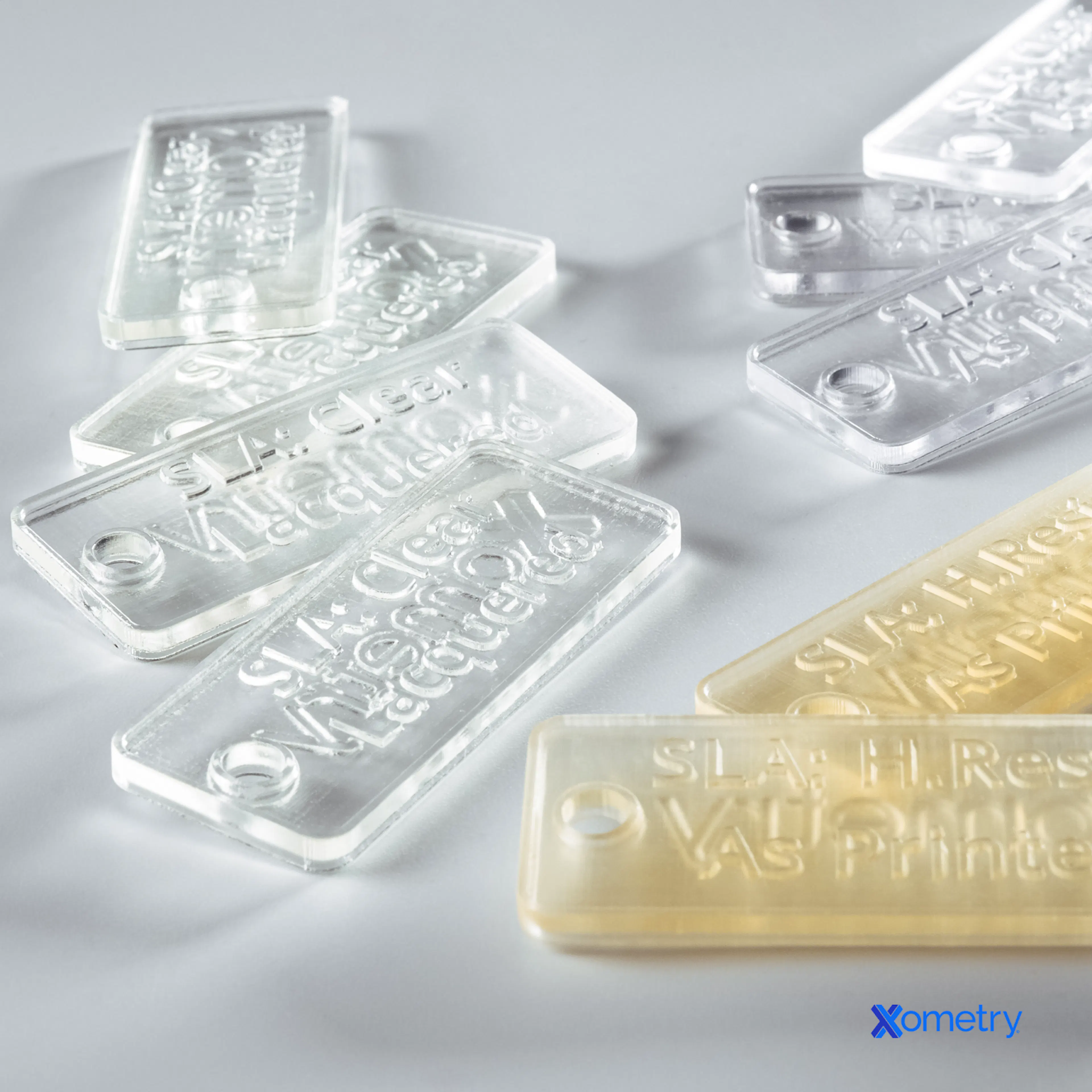

SLA printed tags
SLA printed tags

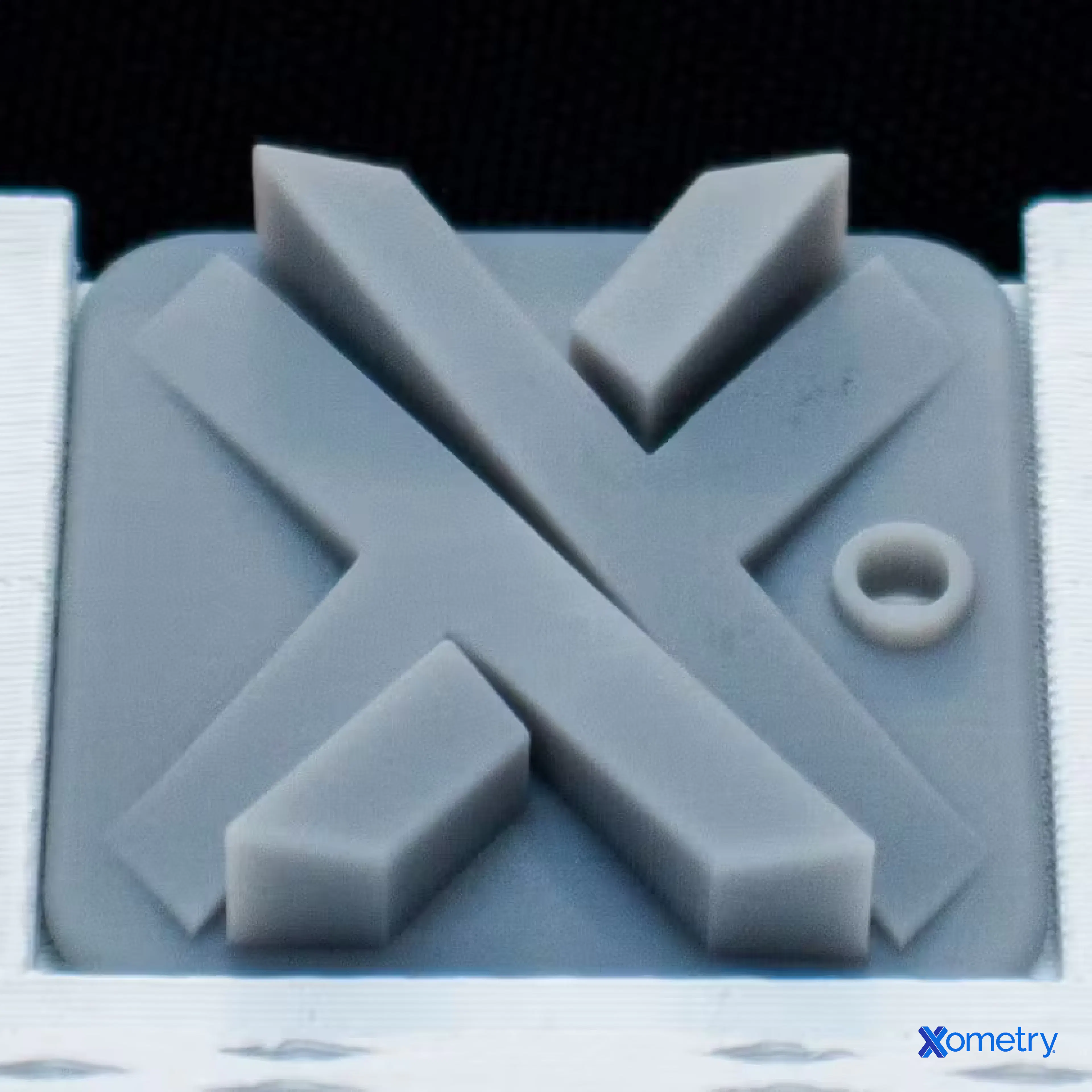

An SLA Xometry logo made with Accura Xtreme Gray material

SLA 3D printing works by moving a UV laser in the X-Y plane. The UV light triggers catalysts in the liquid monomer resin. The print plate begins at the surface of the resin pool, and regions where the laser strikes both resin and the solid plate surface then get polymerized and affixed to the build plate. With that ‘layer’ complete, the build plate moves up, allowing the next layer to affix itself to the previous one. By repeating this process, the part will appear to grow out of the liquid pool. Prints usually begin with the part’s bottom, and the part is printed upside-down.
Once removed, the part must be washed to remove any uncured resin. Any support scaffolding elements can then be cut away.
