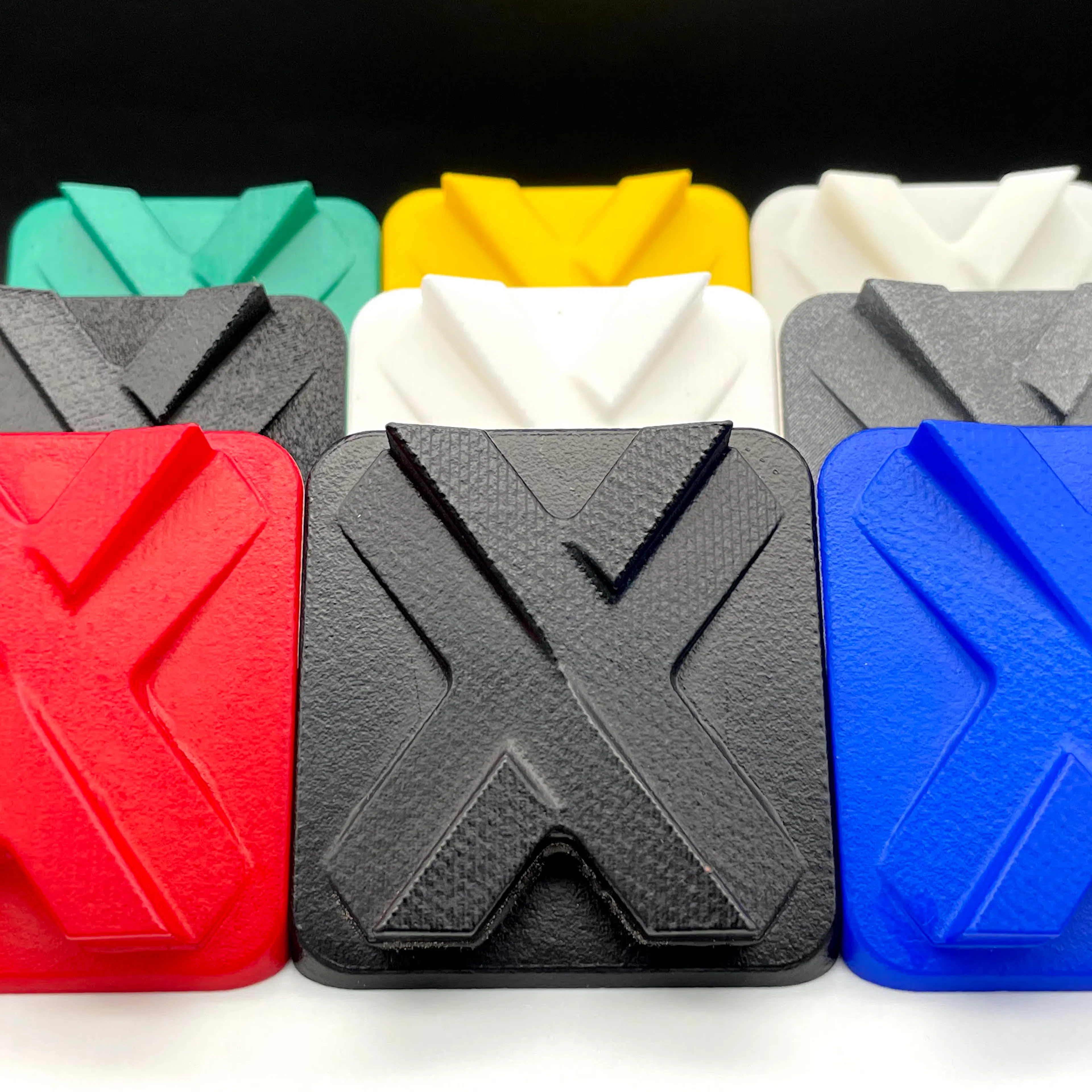

A variety of SLS and HP MJF parts, vapor smoothed
SLS and MJF are powder-bed fusion technologies that create 3D parts from a  thermoplastic powder. Selective laser sintering (SLS) uses a laser to melt and fuse powder grains, whereas multi-jet fusion (MJF) employs a fusing agent, heat, and infrared light to fuse the powder. SLS can employ a more comprehensive selection of materials – many of which can be dyed – whereas MJF creates better isotropic properties at a slightly higher print resolution. MJF is ideal for smaller functional parts, while SLS is the better choice for visual prototypes and medium-sized functional parts. Both styles are similar in terms of printing cost and speed, though MJF is cheaper for larger production volumes.

  • Though both processes regularly use nylon 12, SLS can operate on a broader range of other materials.
  • SLS parts are typically printed in white or gray but can be dyed almost any color.

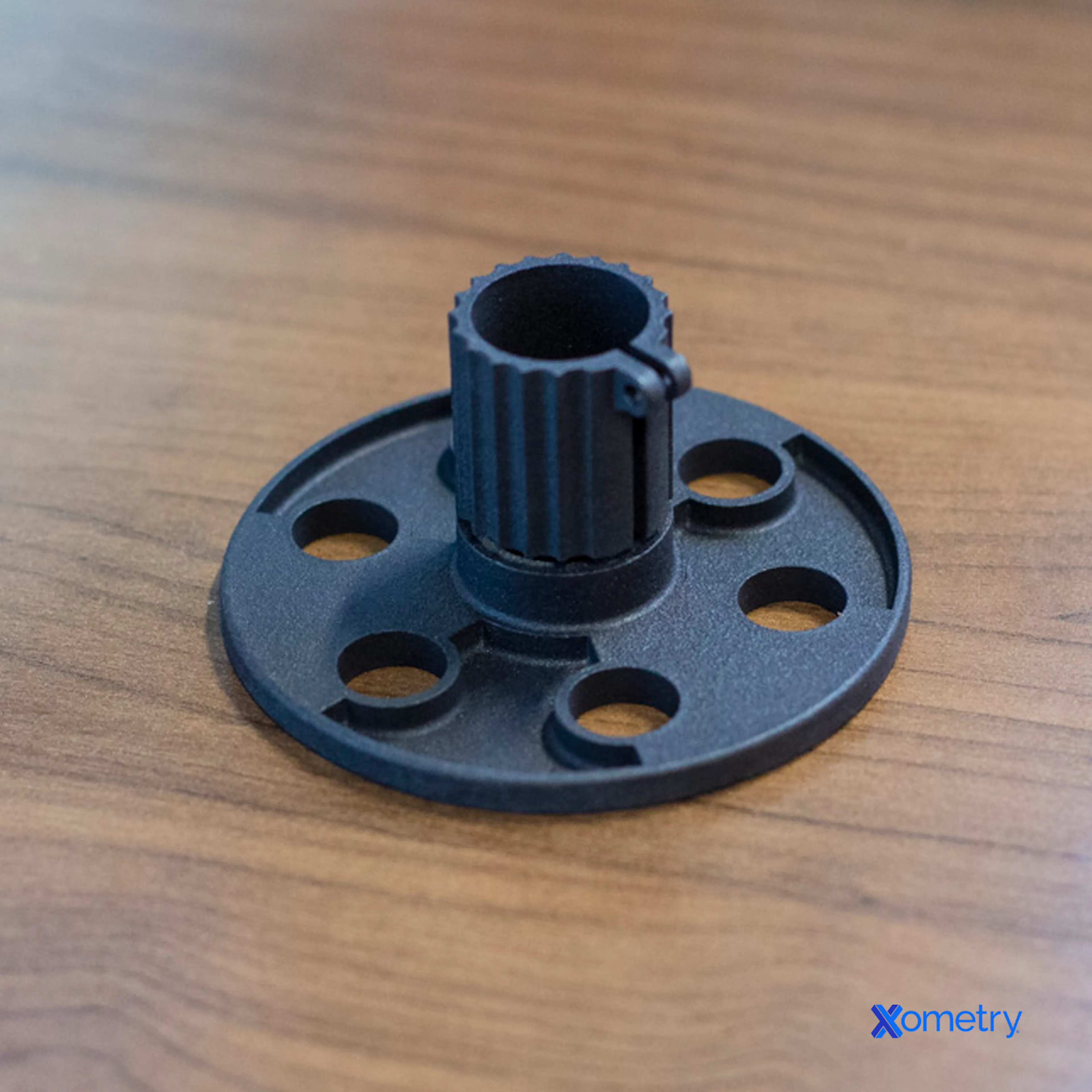

MJF (multi-jet fusion) is a powder-bed 3D printing technology that was developed by Hewlett-Packard in 2016. It employs a multi-step process. A thin layer of powder is first laid down on the print bed. The powder is then heated to just below its sintering temperature. Next, a fusing agent is applied to the powder in the shape of the part’s cross-section. A detailing agent is then applied to the edges of the part to help create crisper and sharper edges. Finally, an infrared heat source passes over the plastic and sinters the treated plastic particles. MJF is a more advanced technology geared towards high production rates than SLS. The image below shows an MJF printing process:
To learn more, see our guide on What is MJF.
A part printed with MJF
