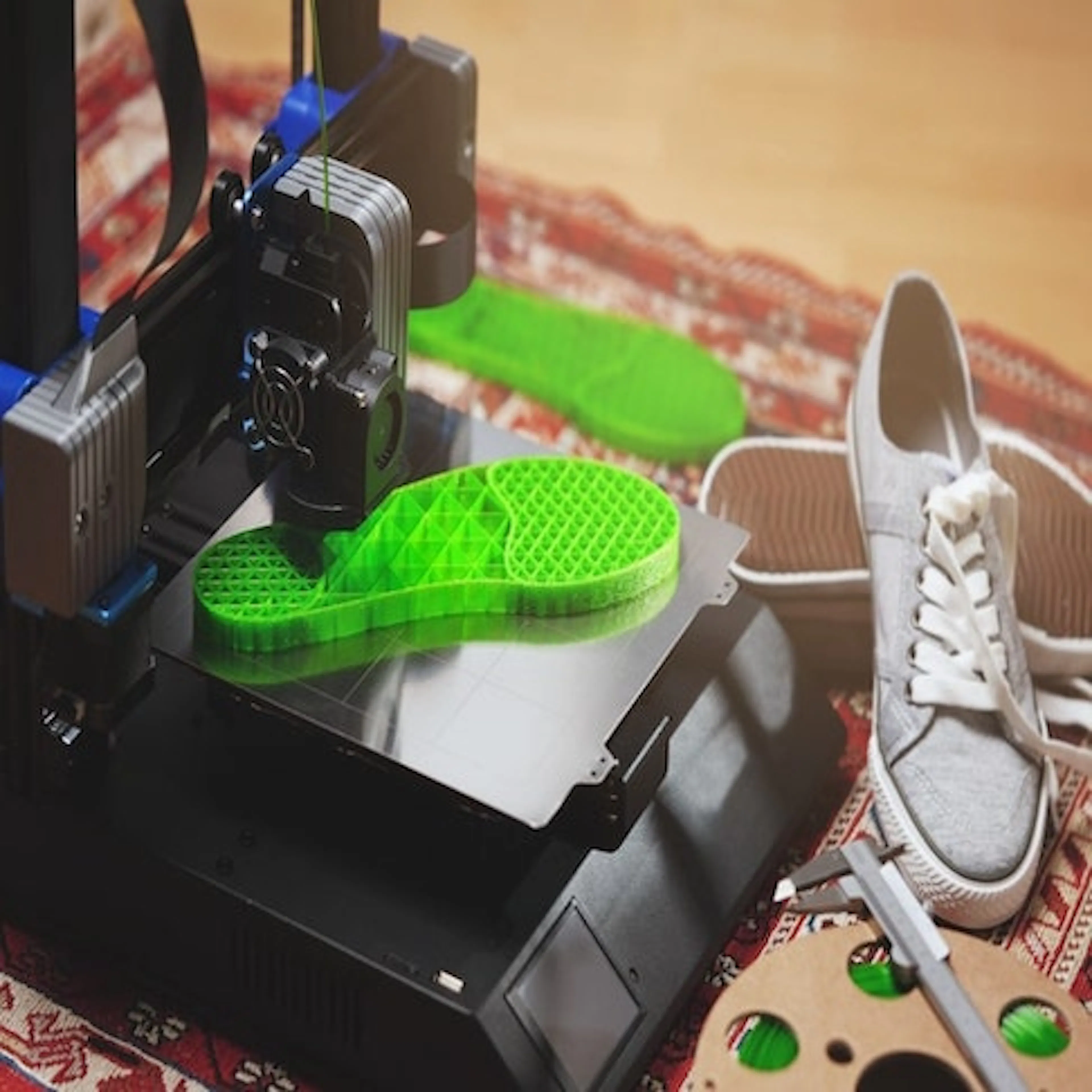

3D-printer makes bright green shoe sole from flexible plastic filament - Image Credit: Shutterstock/R_Boe
