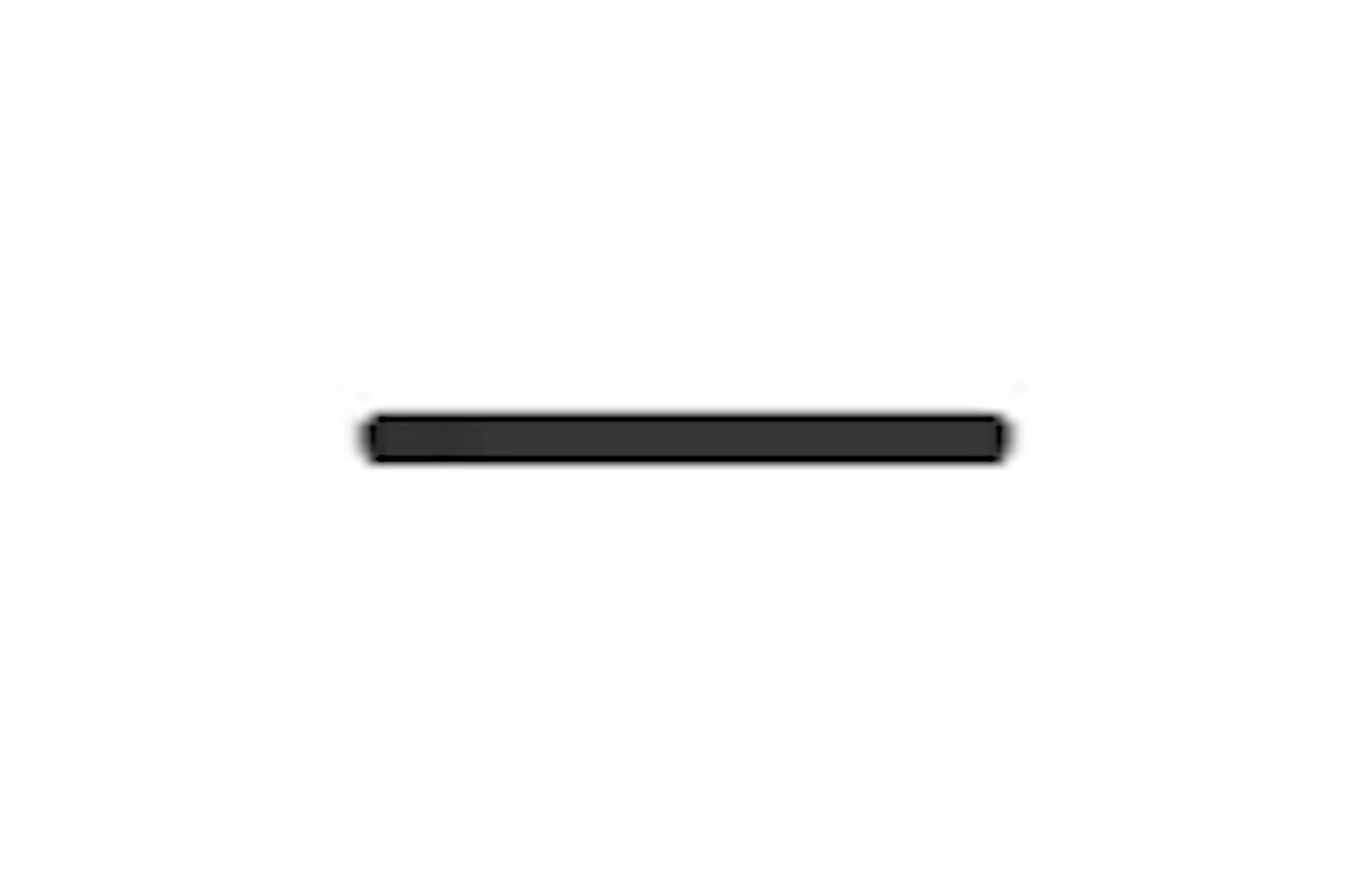

Straightness
Symbol
Straightness
Description
Typically used to define the permissible deviation on long straight features like the axis of a shaft.

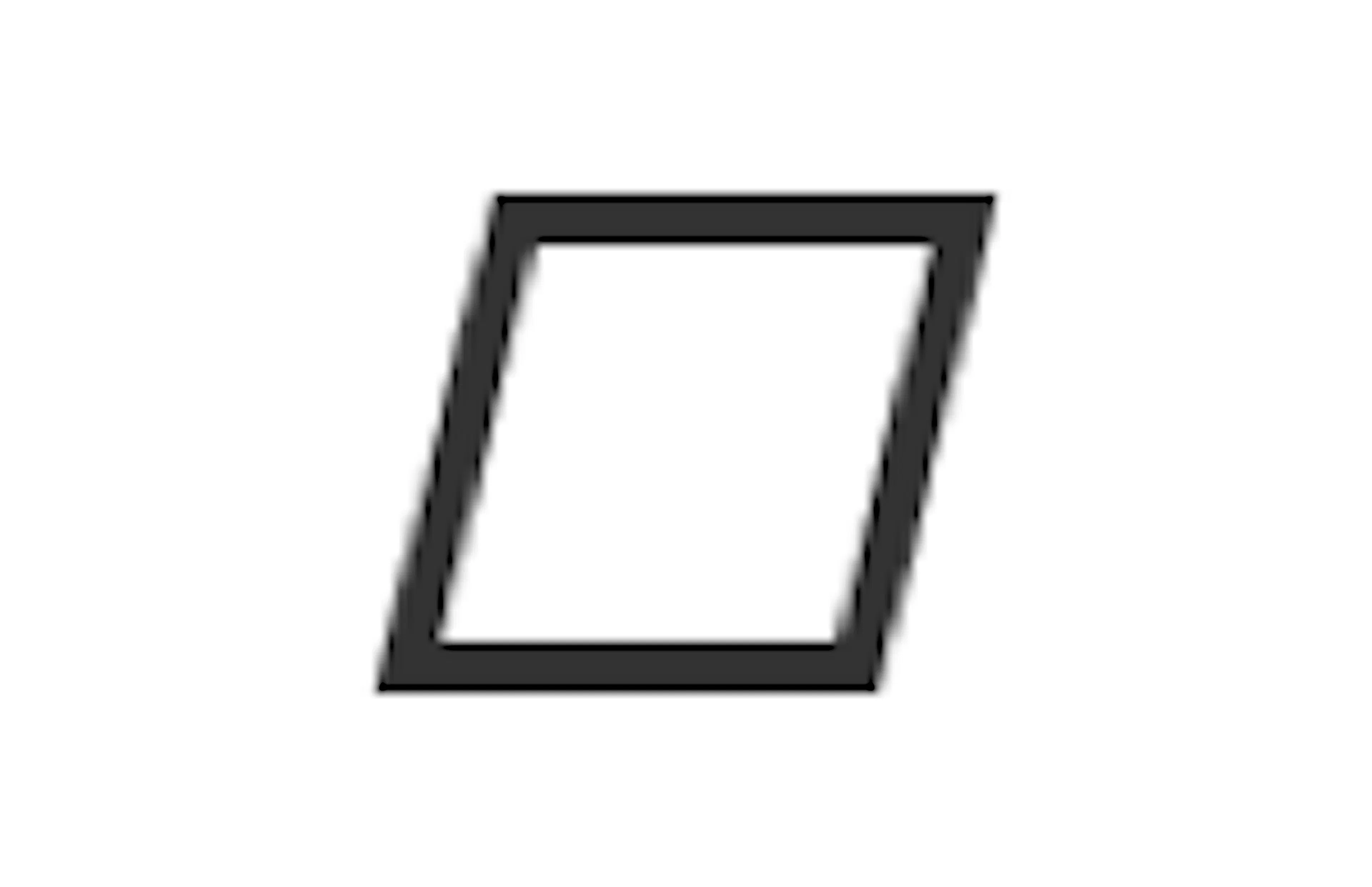

Flatness
Symbol
flatness
Description
Defines acceptable deviation between the high and low points on a flat surface.

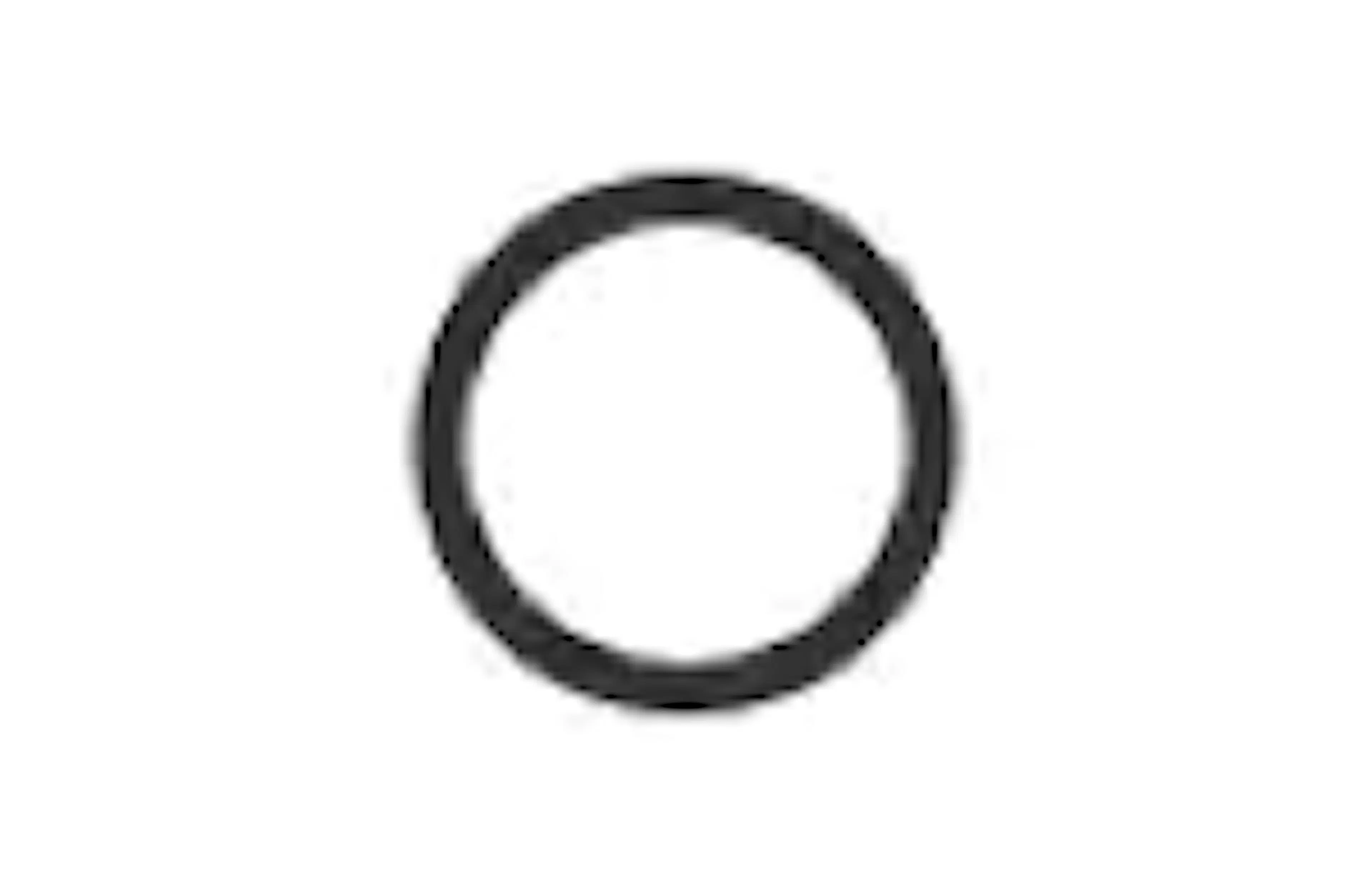

Roundness

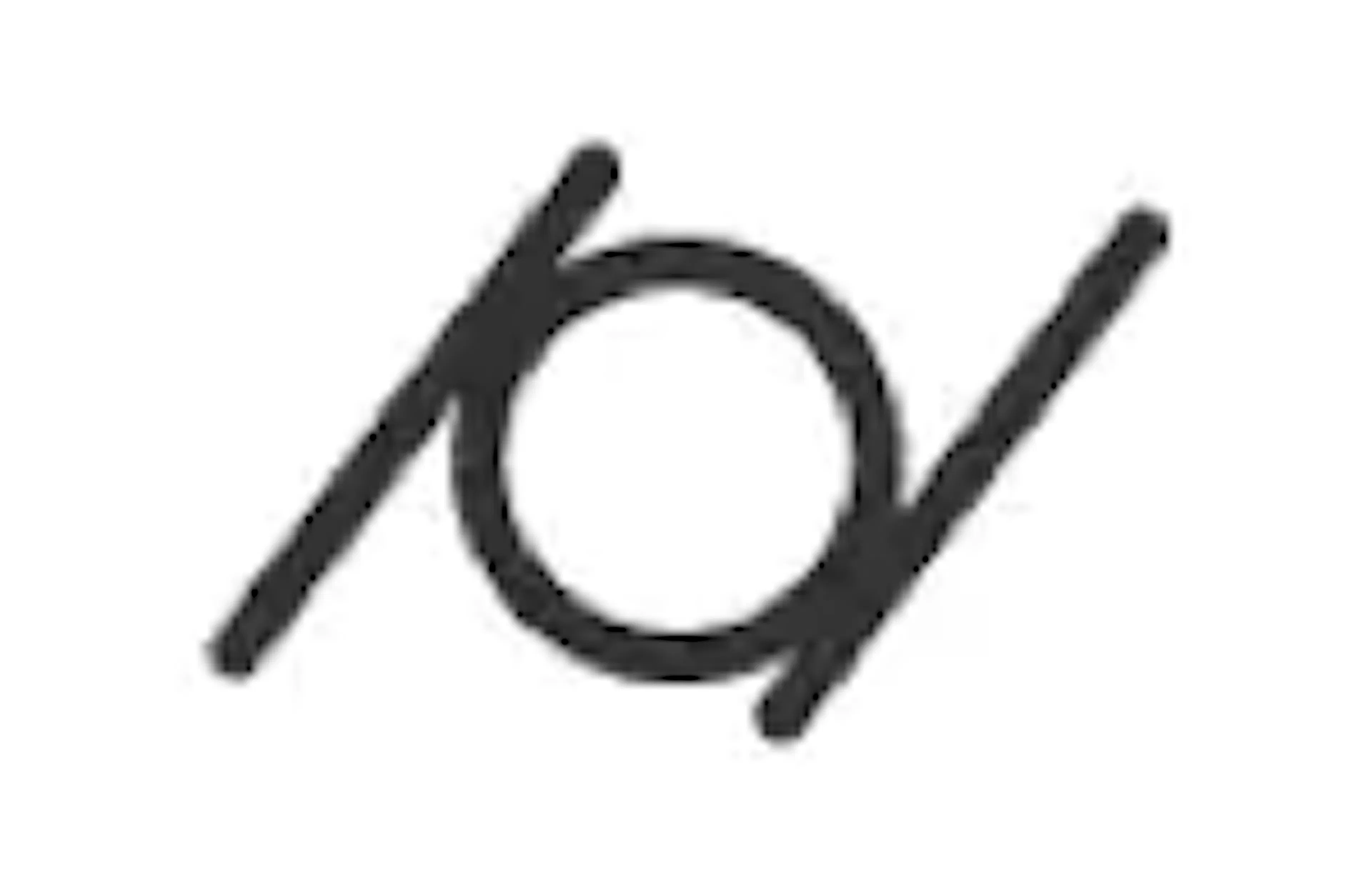

Symbol
roundness
Description
Defines acceptable deviation from a perfect circle on parts with circular cross-sections.
Type
Cylindricity
Symbol
cylindricity
Description
Defines both the straightness and roundness tolerances of a cylindrical part.

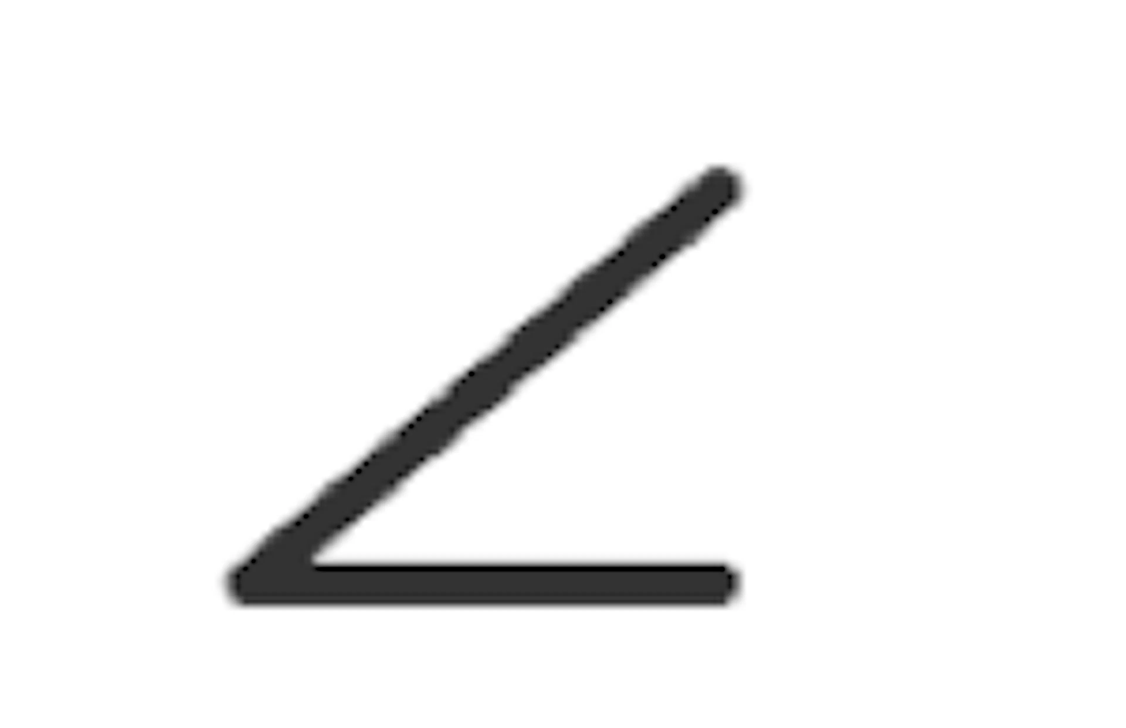

Angularity
Symbol
angularity
Description
Defines the acceptable deviation of an angle with the datum being a straight line or plane.

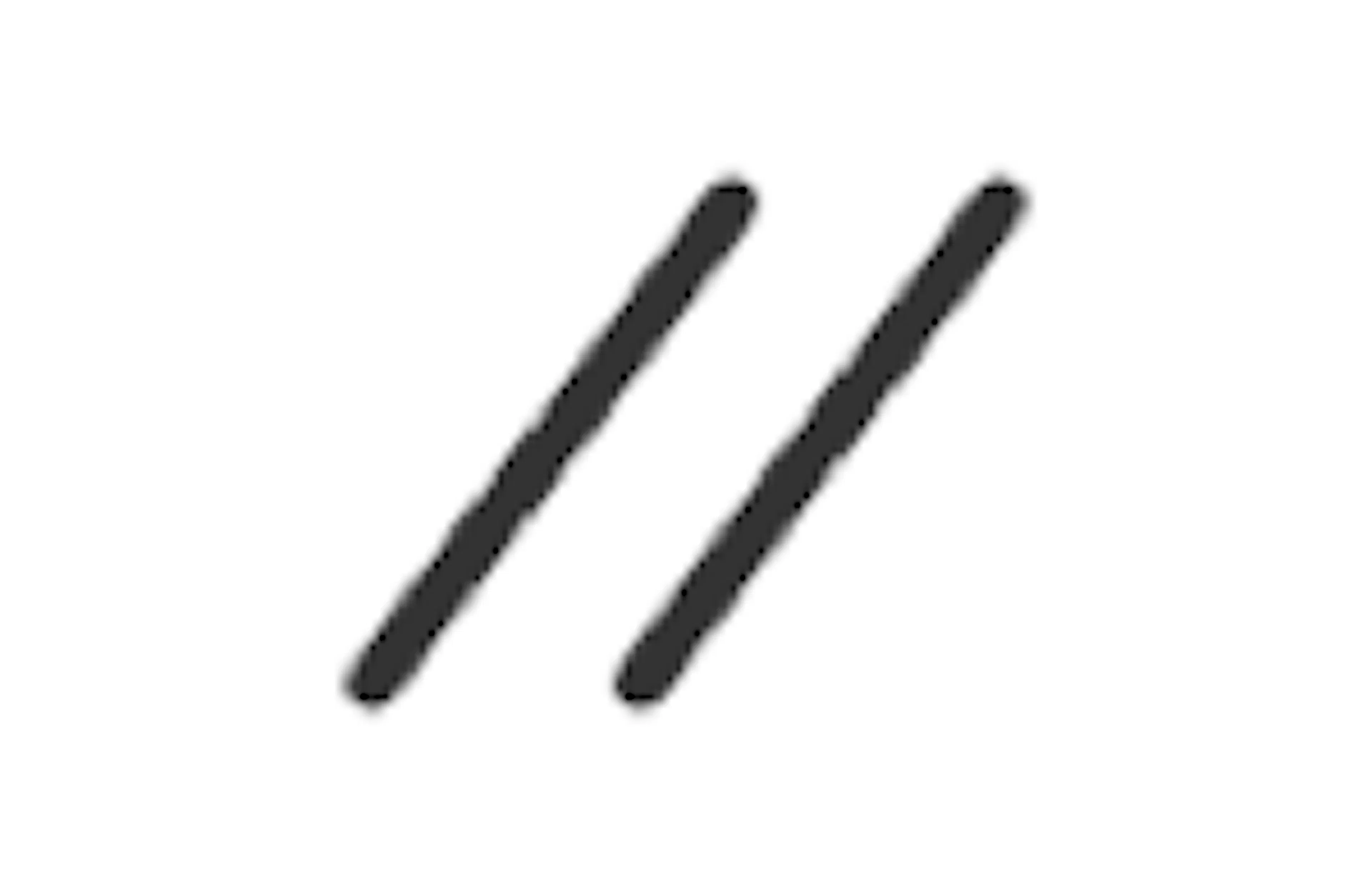

Parallelism
Symbol
parallelism
Description
Defines the permissible parallel deviation between a line or plane and a datum line or plane.

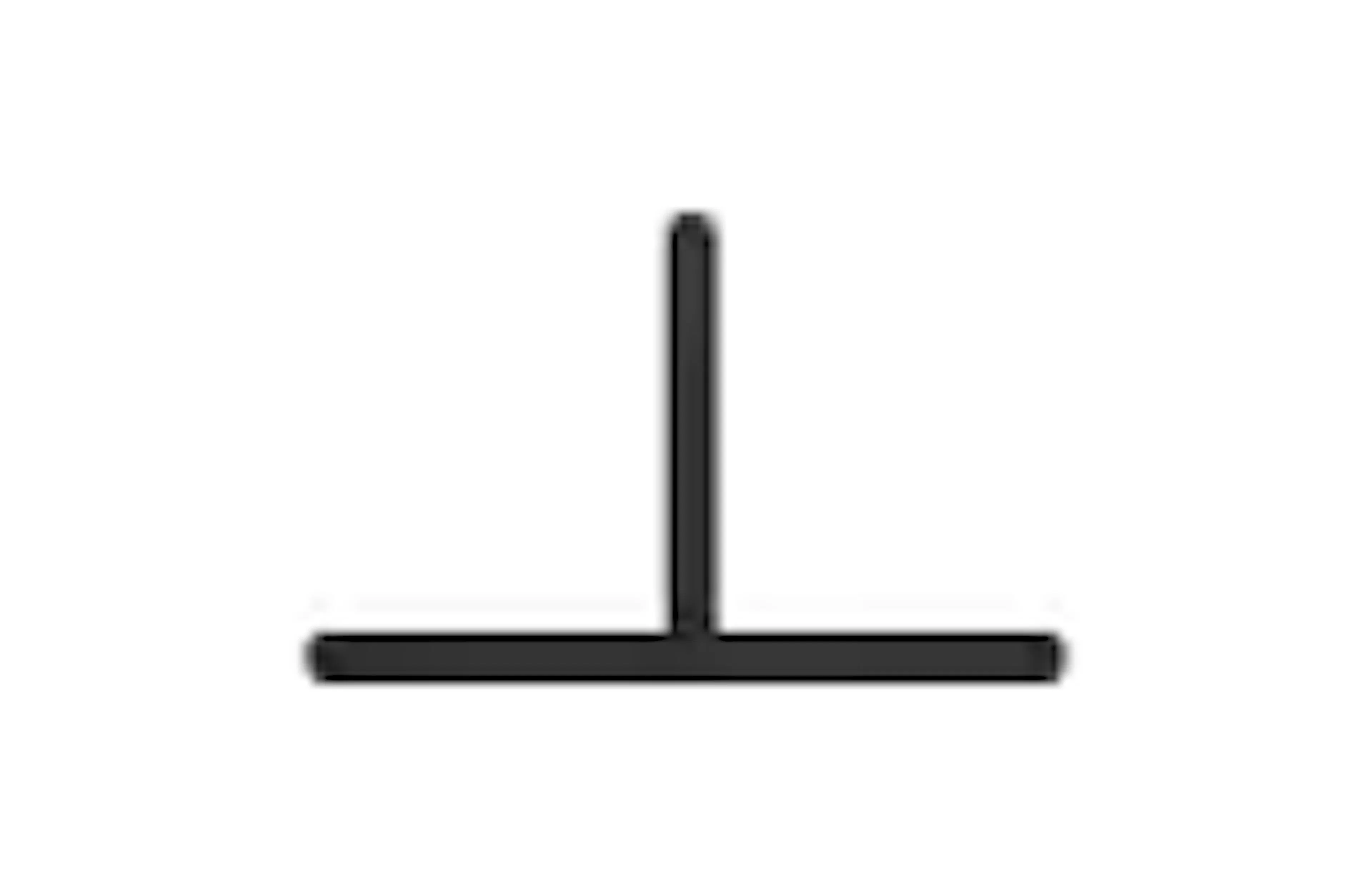

Perpendicularity
Symbol
perpendicularity
Description
Defines the acceptable deviation of a line or plane that is designed as perpendicular to the datum line or plane.

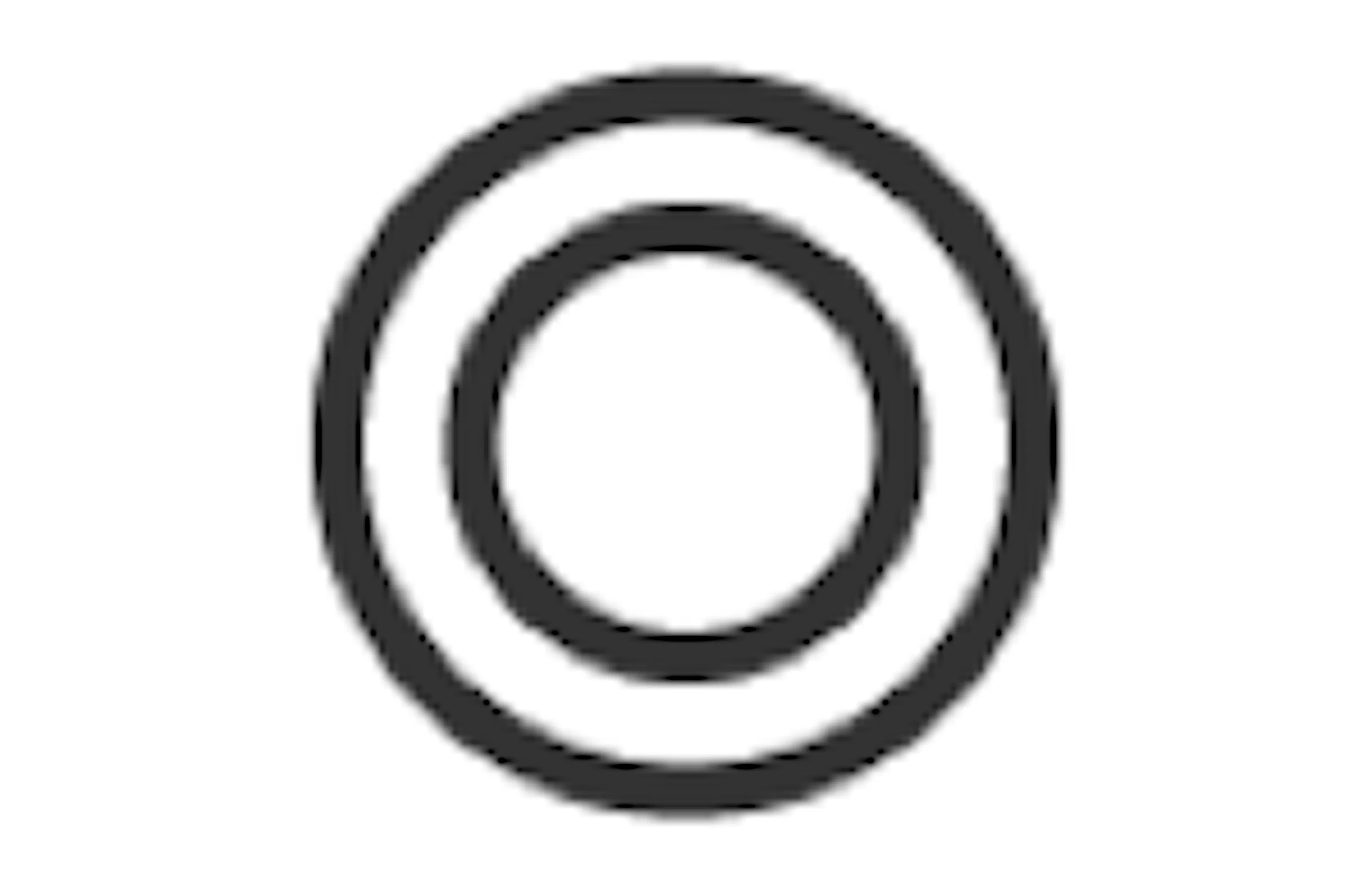

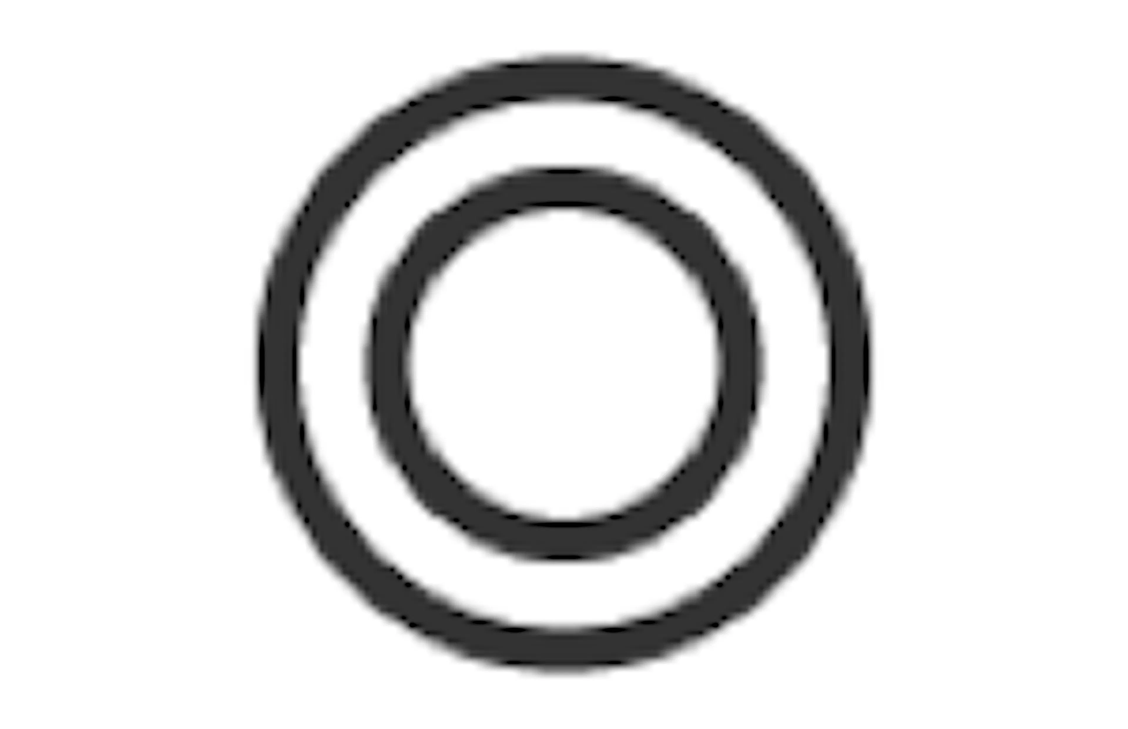

Concentricity
Symbol
concentricity
Description
Defines the acceptable deviation between two cylinders that are designed to be concentric about the same central axis. The datum is the center point.

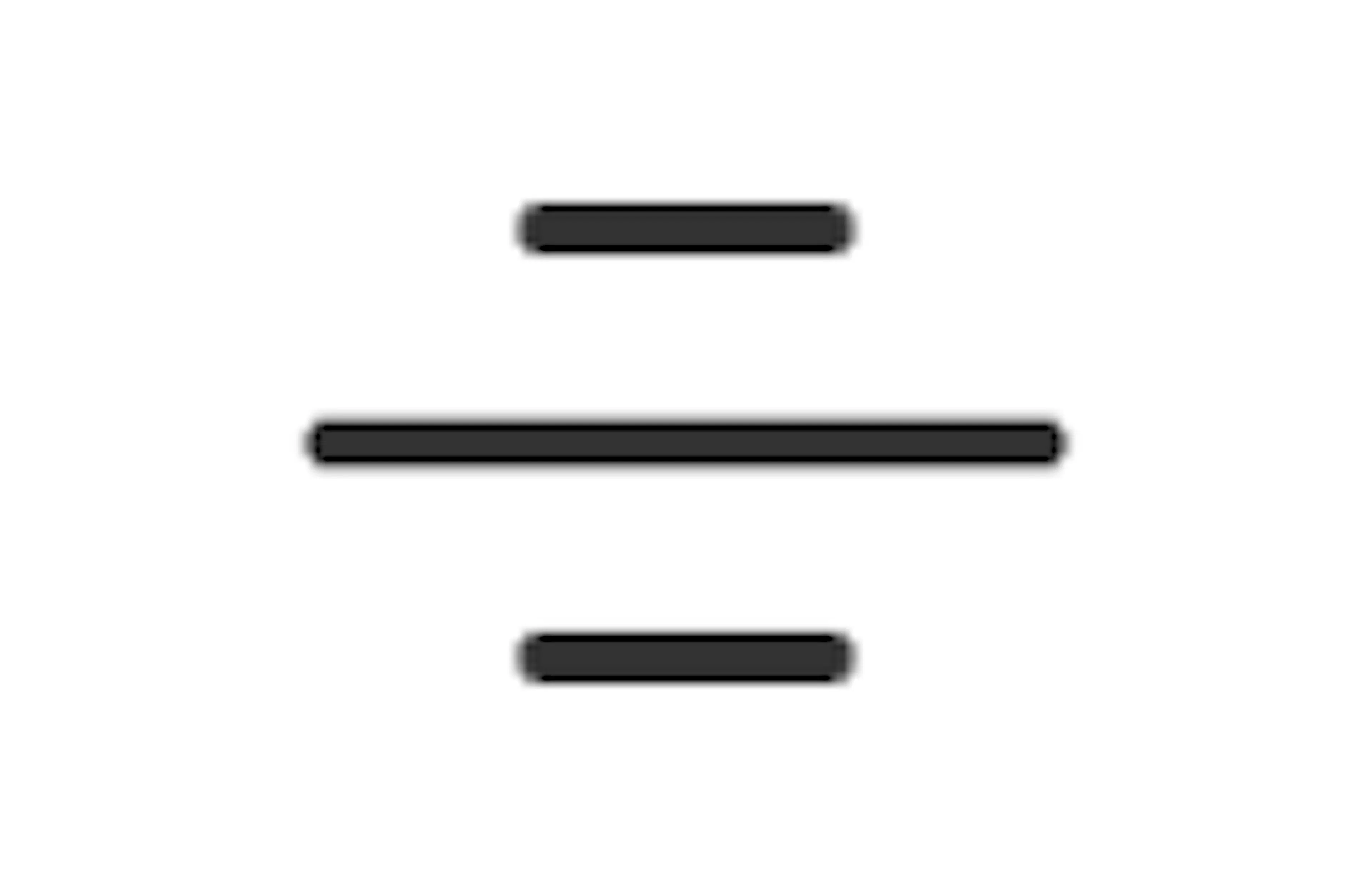

Type
Symmetry
Symbol
symmetry
Description
Defines the acceptable deviation between two planes’ symmetry. This tolerance indicates the deviation of one plane from a theoretical center plane between the features.

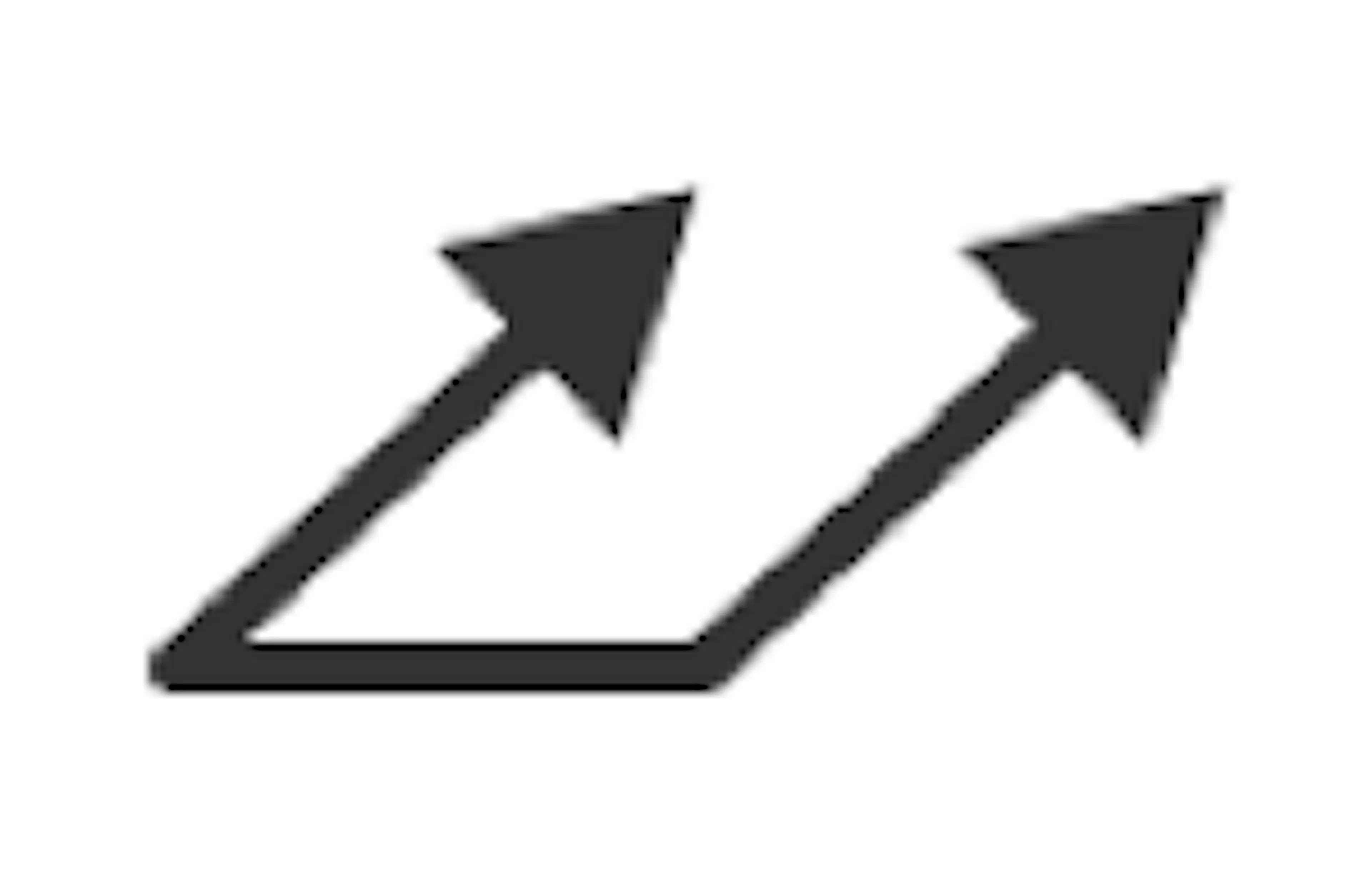

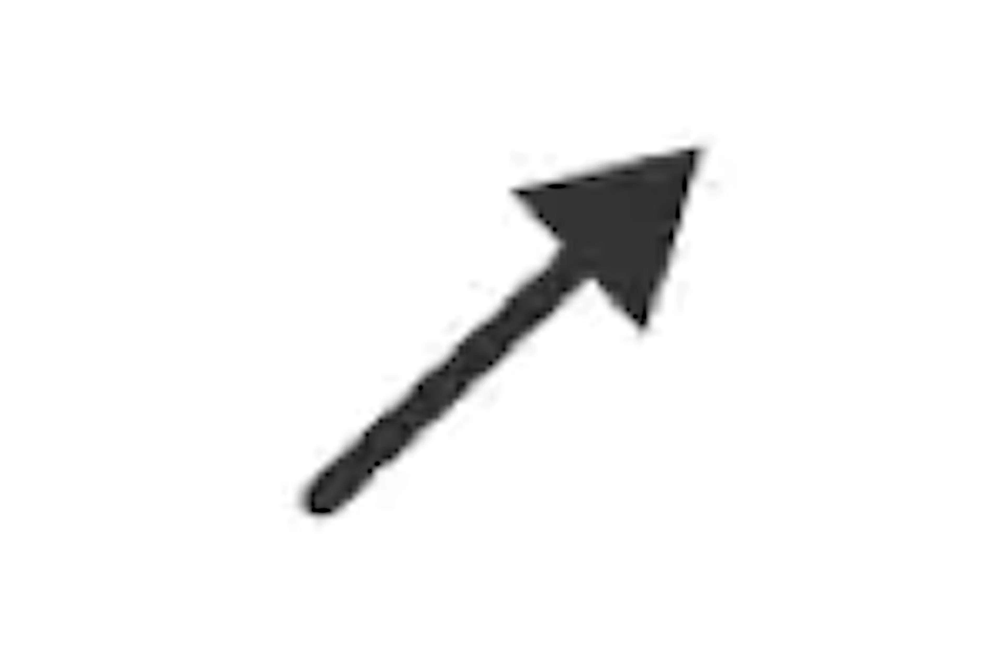

Circular Run-Out
Symbol
circular run-out
Description
Defines the acceptable deviation of a cylindrical part at any point on its circumference.
Type
Total Run-Out
Symbol
total run-out
Description
Defines the acceptable deviation of a cylindrical part at any point on its circumference and along its axis.

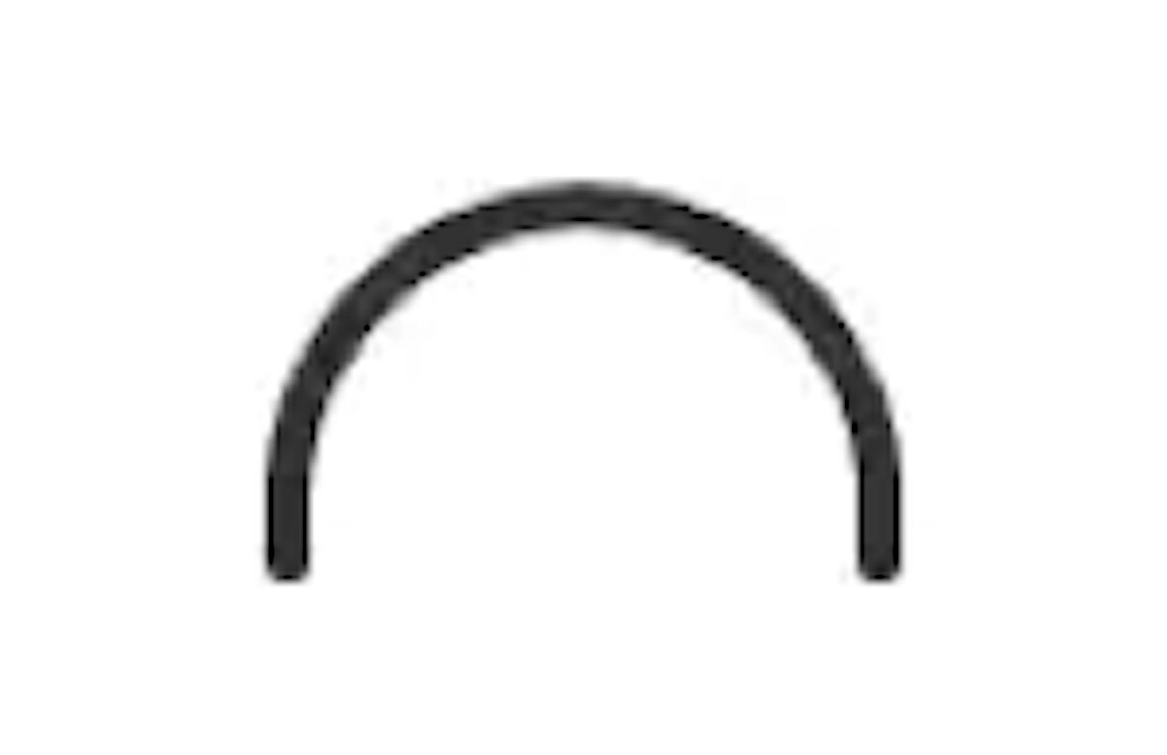

Line Profile
Symbol
line profile
Description
Defines the acceptable deviation of a curve as viewed from a cross-sectional perspective.

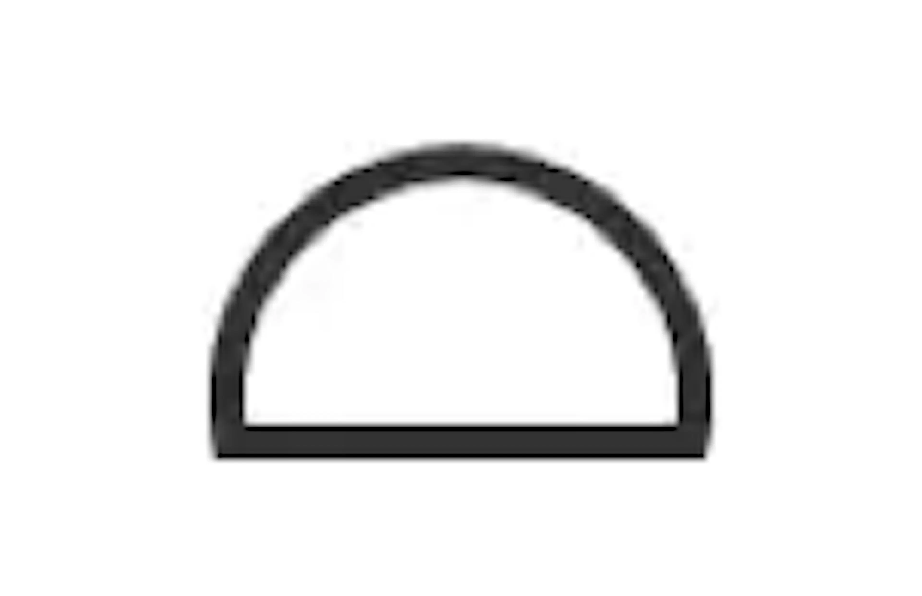

Type
Surface Profile
Symbol
surface profile
Description
Defines the acceptable deviation of a surface along its entire surface area, i.e. deviations from the ideal shape of the surface are controlled.
