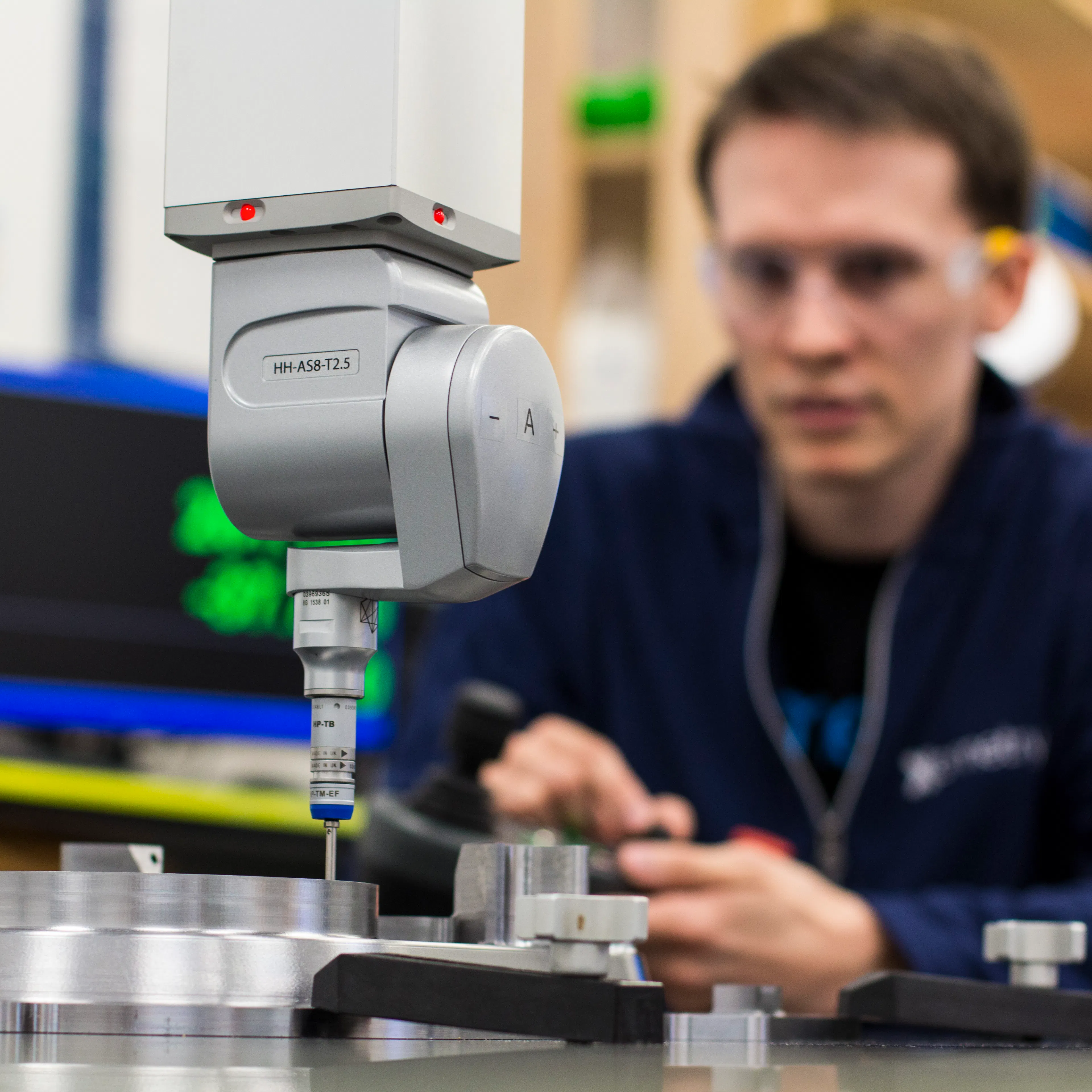

Modern manufacturing operations increasingly depend on the performance of Coordinate Measuring Machines (CMM’s). The accuracy and repeatability of your measurements are as important to your product output as the quality of your actual manufacturing tools. There are several criteria to consider when selecting a CMM for your shop to ensure accurate and repeatable measurements:
Measuring Range
A CMM’s measuring range is primarily determined by the physical size of the largest part to be measured. However, the configuration of the part and the inspection routine may require the use of measuring probe extensions or holding fixtures. This may significantly increase the minimum measuring range. As a guideline, the CMM’s X, Y, and Z measuring ranges should be twice the length, width, and height of the largest part to be measured.
Accuracy
Environmental conditions like temperature, floor vibrations, and contaminants (dust, dirt, oil, etc.) can affect a CMM’s measuring accuracy. CMM manufacturers usually specify ideal atmospheric conditions and deviating from these may affect the CMM’s accuracy. To compensate for this, we recommend applying an acceptable ratio of maximum permissible error to tolerance, which represents the maximum error a CMM can have on a measurement compared with the tolerance of the measurement being taken. Ratios typically range from 1:3 to 1:20, with 1:5 and 1:10 being the most common. To maintain a 1:5 ratio the maximum permissible error of the CMM must be 1/5th of a dimension’s tolerance.
