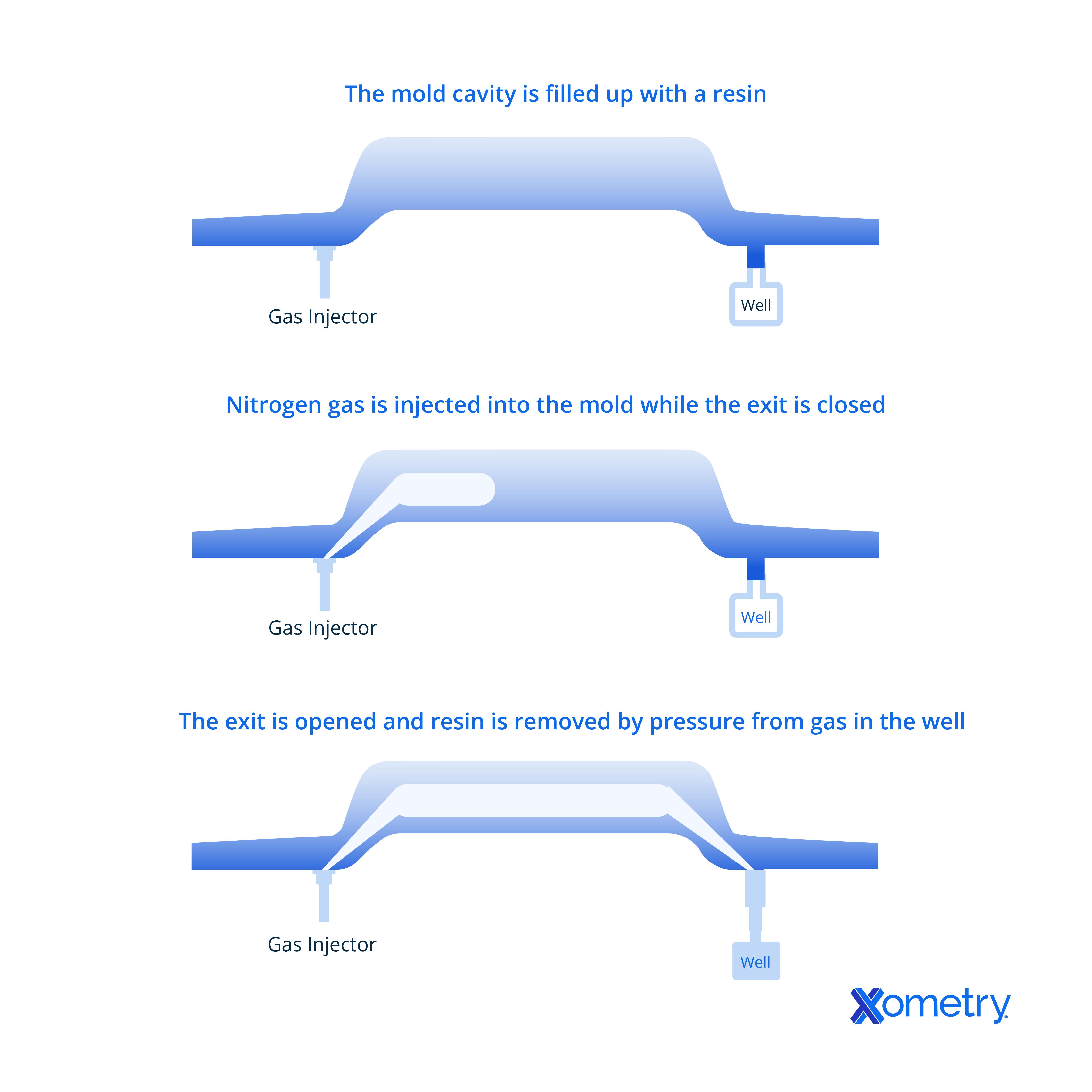

1. Gas-assisted injection molding
Filling complex mold shapes can be difficult. No matter the molder’s experience level, intricate molds make part defects harder to avoid. One new technology uses gas to assist in the injection process, improving the even distribution of molten material into complex molds. As with a typical injection process, the resin is shot into the mold, but in this case, only about 70% of the space is initially filled. The gas — typically nitrogen or carbon dioxide — is then injected through a separate nozzle into the filled portion of the mold as the melted resin cools. This forces liquified plastic into the unfilled portions.
Because of this gas injection, the resin solidifies on the surfaces that make up the part’s shape but leaves the interior hollow. Pressure from the gas is then relieved and the part is ejected from the mold just like any other injected part.
Gas-assisted molding offers three other benefits as well:
  • It limits the amount of material required to produce the part, thus creating less waste and saving money.
  • The pressurization makes surface defects like flow lines or sink marks less common.
  • Because of the pressurized gas, the resin itself is less likely to shrink while solidifying, thus resulting in stronger parts.

How gas assisted injection molding works
