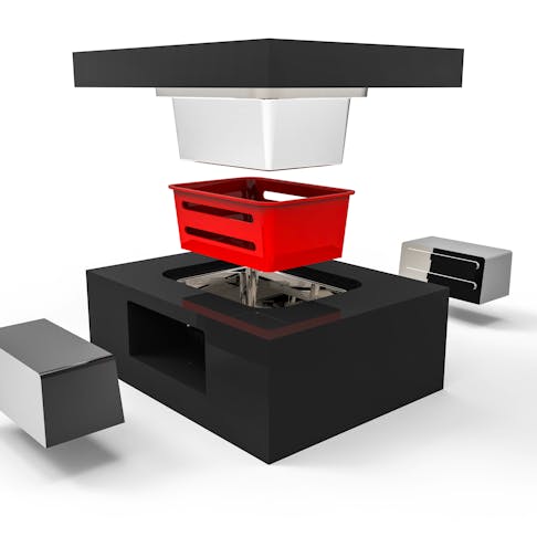

A Breakdown of Injection Molding Part Costs
Image Credit: Shutterstock.com/Solcan Design
