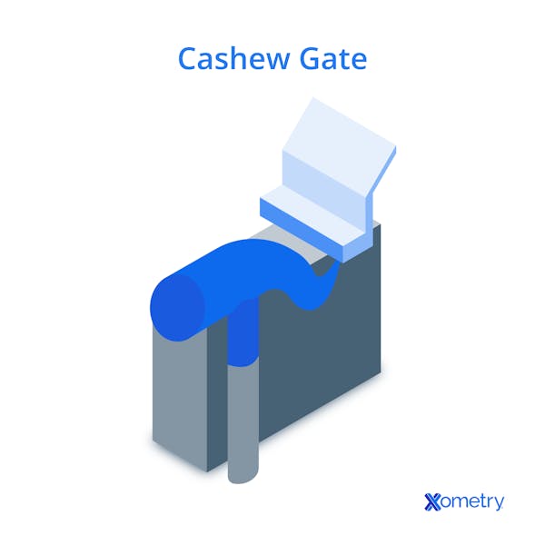

Cashew and Direct Sprue Gates
Some gates may not require manual shearing or removal of the runner. For example, cashew gates are similar to tunnel gates by being located below the parting line but their design allows for the runner to automatically shear off after molding. Edge, tunnel, and cashew gates can be strategically placed in one or multiple locations of the mold. They can also be used in multi-cavity molds where material is channeled through a tree-like runner.

Cashew gate
