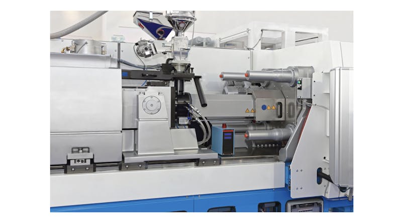

Plastic injection molding requires an injection molding machine, raw plastic material, and a typically machined mold tool. The key steps in the injection molding process are clamping, injection, cooling, and ejection. For more information you can check our article on the Basics of Plastic Injection Molding.
The diagram below shows a typical injection molding machine used by industry:
Clamping is when the two halves of the aluminum or steel mold are held together to prepare for the enormous pressure from injecting the molten material. Next, the pelletized resin is heated to a melted state and injected into the mold.
The part cools and solidifies into the final plastic part. This may take anywhere from a few seconds to a few minutes. The molded plastic part is then ejected, either automatically or manually, and the process starts again for the next part. Periodic maintenance is performed on injection molds to assure that they are not degraded and are capable of continuing to produce high-quality molded products.

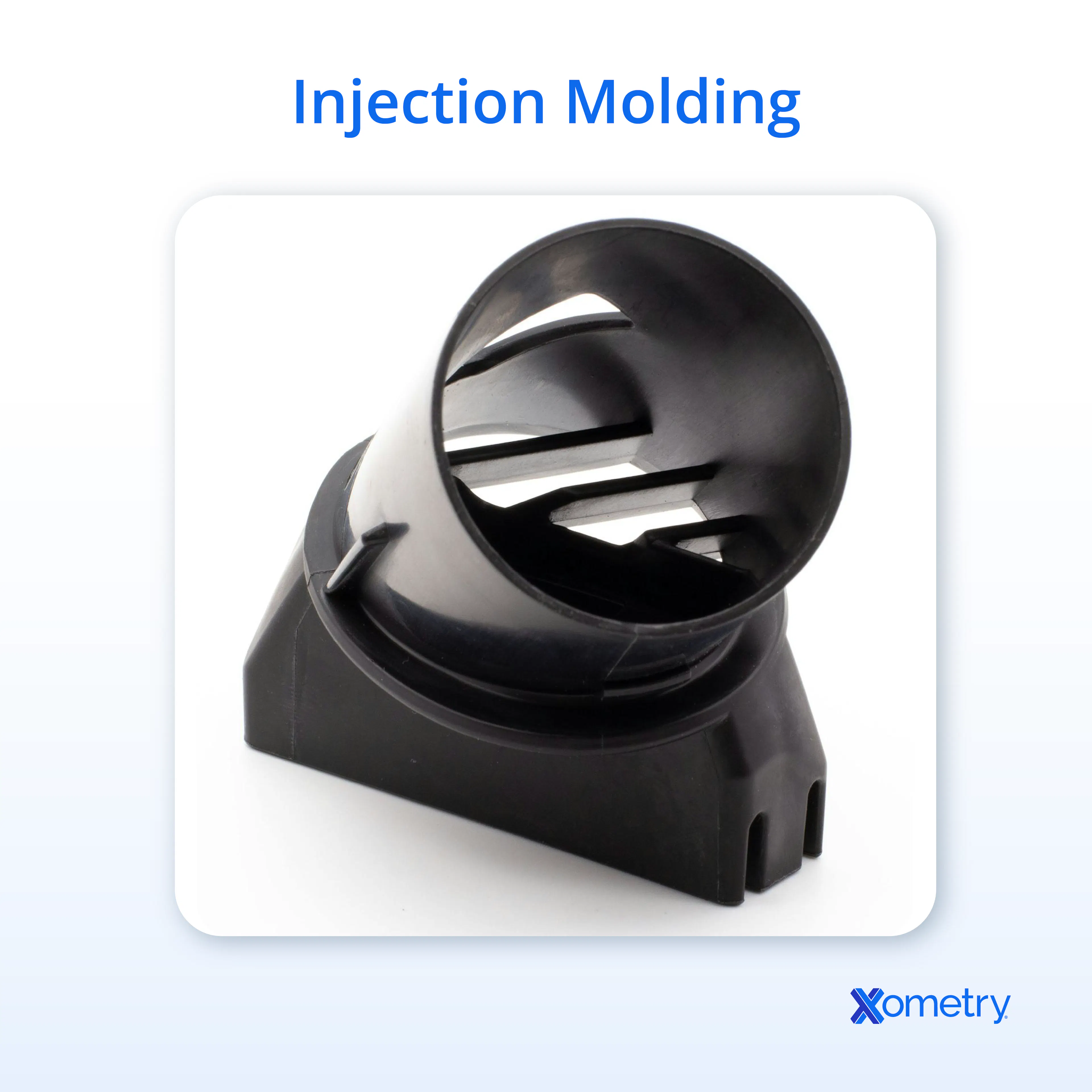

A photograph of an injection molded part

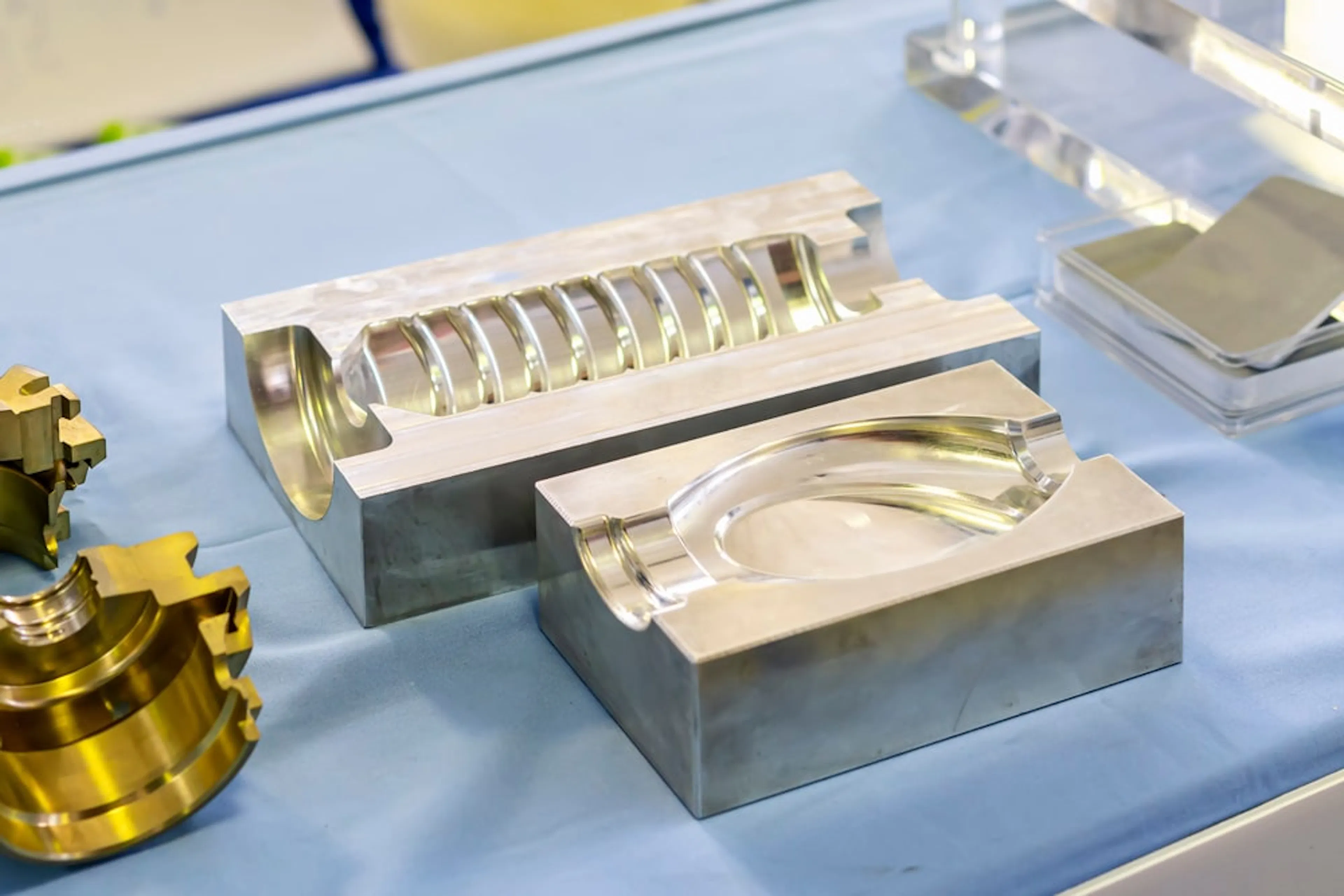

Early molds were very simple, with only two parts. Now, very complicated molds are used that may have more than two areas or parts.
