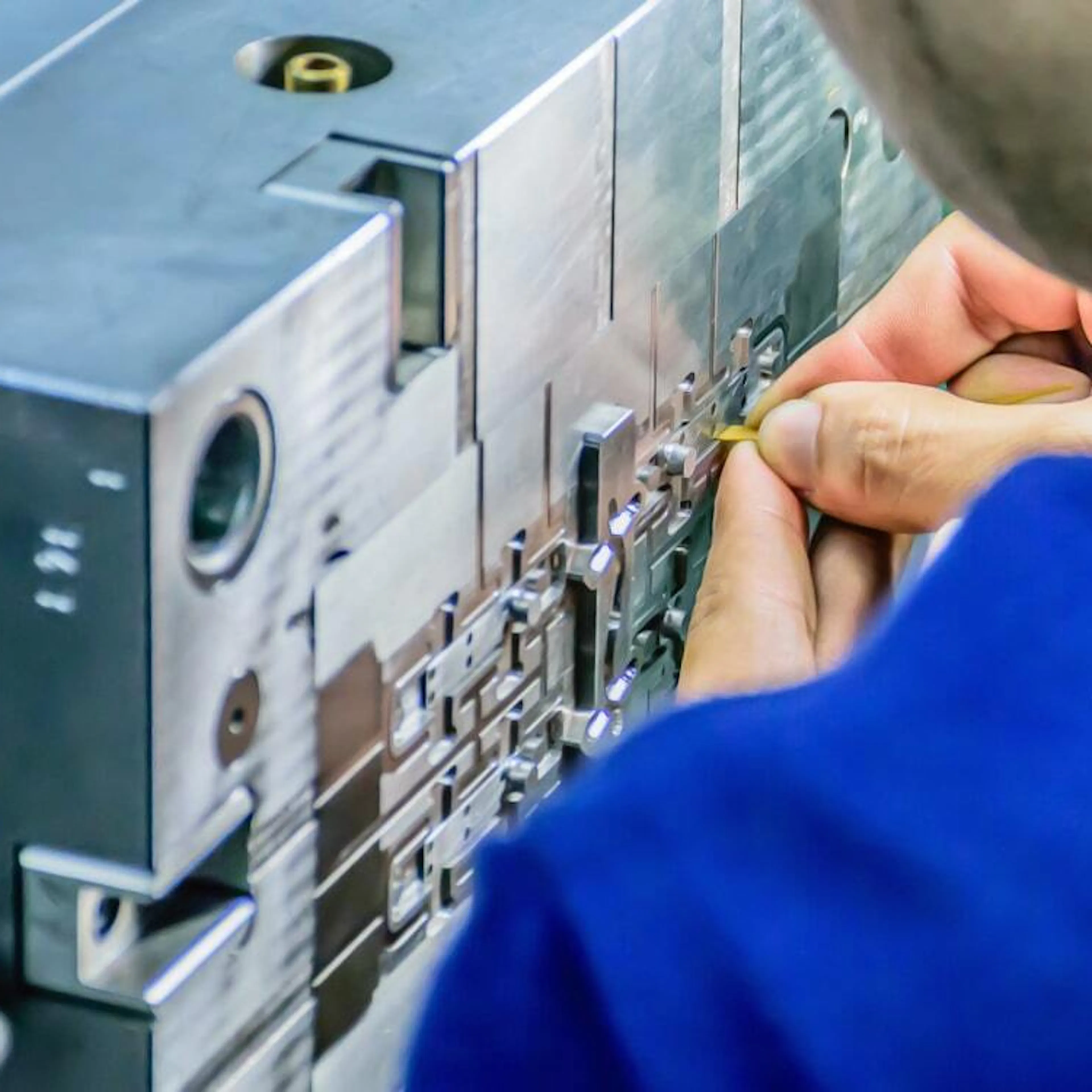

Maintaining Injection Molds To Extend Their Lifespan
You can maintain injection molds to extend their lifespans by making sure the mold meets the part's requirements, using appropriate operating conditions for the mold, periodic cleaning of the mold, periodic inspections of the mold, and using coatings for the mold.
  • Make Sure the Mold Meets the Part’s Requirements: This means the core and cavity of the mold should have appropriate hardness (greater than 52HRC, as a reference), so it can be used in the processing of plastic materials.
  • Use Appropriate Operating Conditions for the Mold: Make sure to use the mold in the environment and in the processes it was originally planned to operate to ensure there are no additional stresses and wear sources. Using SPI classification will help with determine the appropriate operating conditions of the mold.
  • Periodic Cleaning of the Mold: Exact cleaning and maintenance can vary based on the type of mold, but the most common activities include periodic cleaning, finishing, coating, and greasing of the mold. The frequency of maintenance also depends on the resin used in the injection process.  For instance, when injecting abrasive resins, such as glass-filled variants, more frequent cleaning and maintenance should be expected.
  • Periodic inspections of the Mold: Related to maintenance, visual inspections of the mold in question is the bare minimum when talking about inspections. This can be done as frequently as once every few days. Checking for wear and detecting it in its early stages will save both money and future headaches.
  • Using Coatings for the Mold: Coatings can help limit wear and damage to the mold. Using mold coatings has the effect of reducing the need for mold maintenance, reducing part downtime, and improving performance of the mold. Carbon-based coatings are a quite common option, especially for moving parts, due to the lubricity they add to the part. Besides the sliding wear resistance (very useful in the case of ejector pins for example), coatings can help protect against corrosion and seizure.

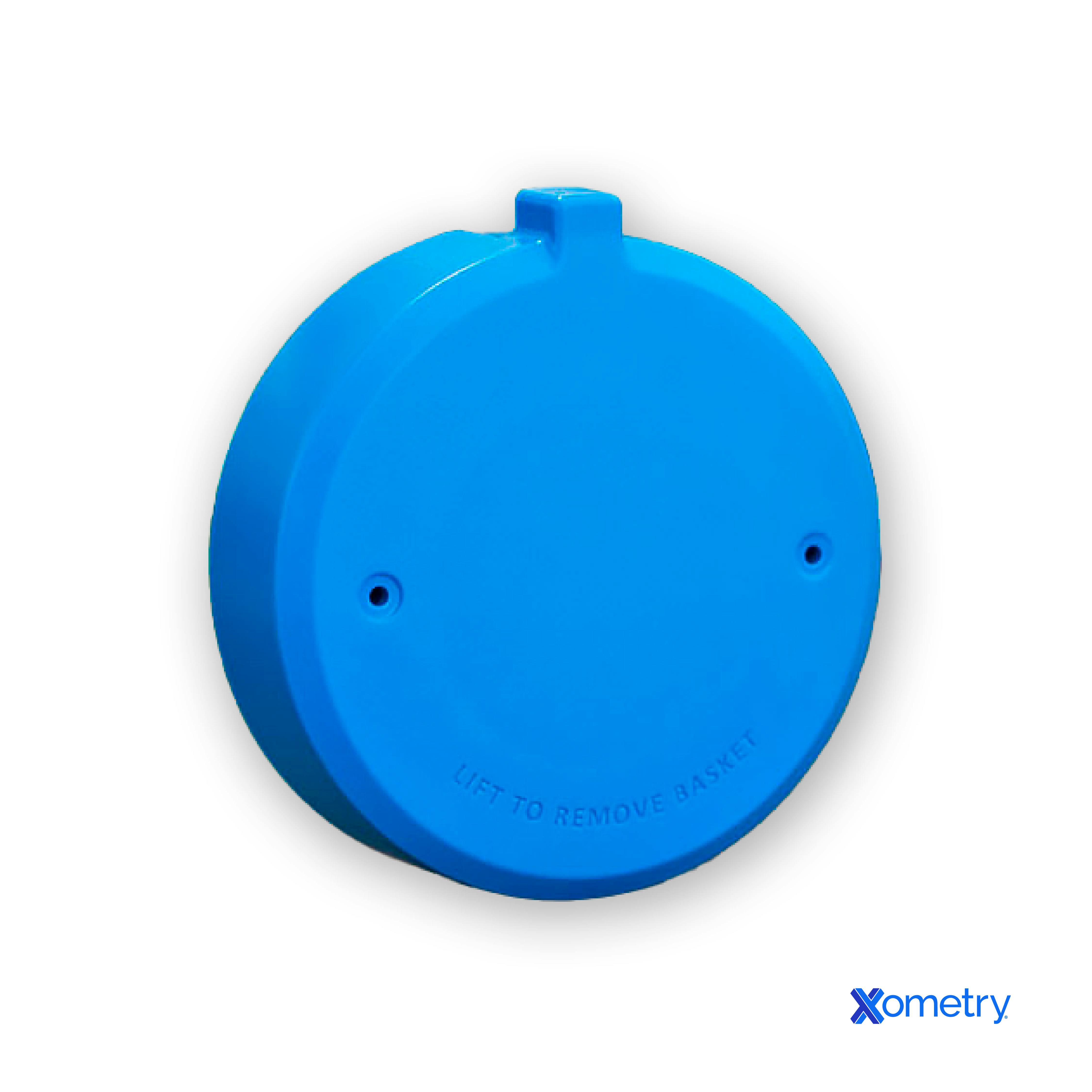

A plastic injection molded part
